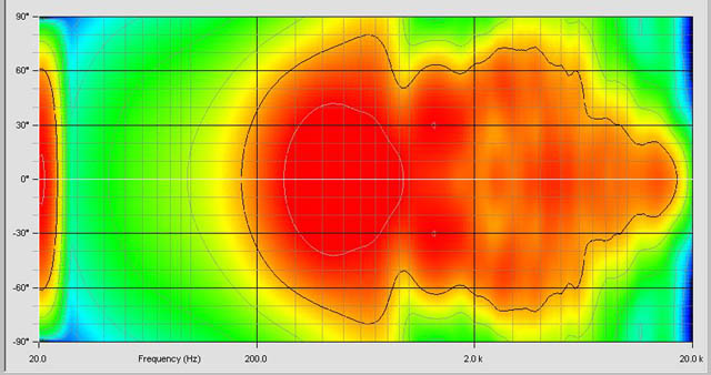

John, I think we're all aware of the problems with the Orion although I've heard them at a friend's house and they sound good to me with all kinds of music. Ultimate speaker? Probably not. Dang good speaker? You bet.
Whether or not SL has succeeded in his design goals, I think his stated goal of having the speakers sound like the original is often misunderstood and/or intentionally used as a straw-man. The argument goes 'who wants Steely Dan to sound like they are playing in a symphony hall and, if so, which hall?' That's not what he's trying to do and that's not how the Orion sounds to me.
I look forward to your progress with the NaO Note, as it appears to fix some of the obvious directivity problems with the Orion and your earlier NaO versions.

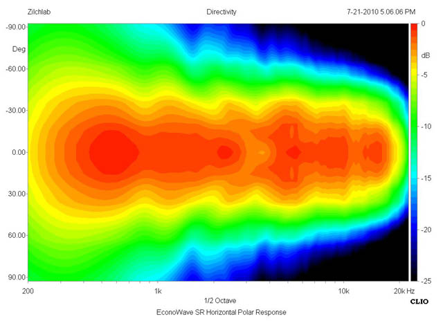

Of course, some of us have directivity more constant than others.So yes, fixing the directivity problem seems the best approach but nobody of us has a constant directivity loudspeaker 😱

It's unfortunate that the only directivity map we have of Orion was measured by a competitor:

Well, I do. At least from 1kHz up.
