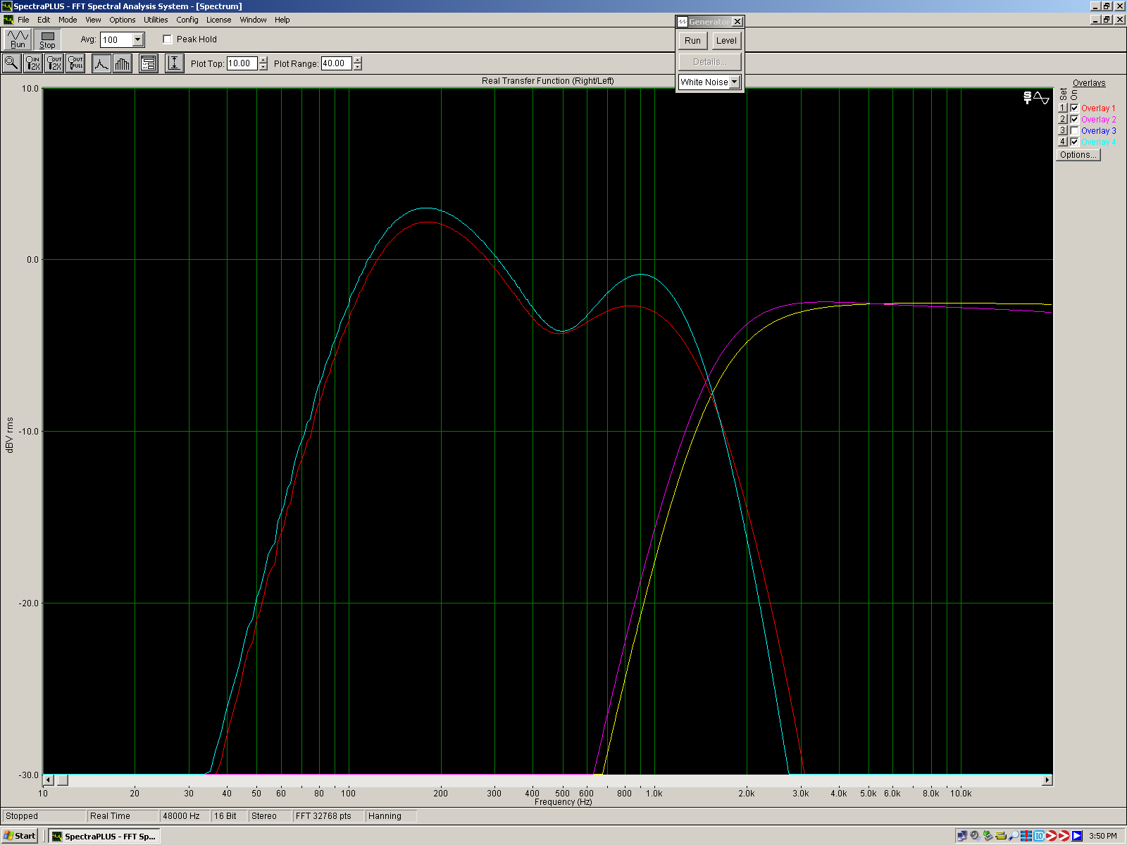

I'm afraid the whole premise of this thread is incorrect. (At least as far as the magnitude of the DSS filter.)
The (overall) net change to the Orion ASP EQ setting regarding this "DSS" shelf filter also includes an update (increase) to the tweeter level setting for the Orion system. (If you're not a Linkwitz owner and don't have access to the full revision update on his website then you don't have all the information.)
Evaluating another speaker system that exhibits a "flat" response and then applying a -3.2db shelf filter is not the same thing and is a complete apples/oranges comparison.

But then there's this . . .I'm afraid the whole premise of this thread is incorrect. (At least as far as the magnitude of the DSS filter.)

Yes, I'm familiar with his description of the process evolution, but you're missing the point. 🙂
Did you look at the plot? Do you see a -3.2 db relative difference in the upper range of the two tweeter responses?
As I said, there is a concurrent ASP tweeter (leg) level increase that is also part of the Revision 3 modifications. So, you just can't apply a -3.2db (1.8khz) SLP EQ to any speaker and evaluate the "DSS" filter. It's dedicated to the Orion system and only with other modifications as well. Do you see what I mean?

In it's current iteration, the acoustic response of the Orion is "essentially" flat. It slopes down slightly, but it DOESN'T mimic the electrical response of a -3.2db SLP. In fact, if you disengaged that portion (and just that portion) of the (latest revision) Orion ASP the upper range of the acoustic response would be significantly ELEVATED.
The -3.2db shelving filter is part of the modification, BUT there's also a +2.9db level increase in the tweeter leg. So (relative to pre-Orion 3 configurations) the "tilt" of the acoustic response has only been changed 0.3db. It's a bit more than that because the midrange levels have been increased slightly.....but no where near 3.2db. (You can visually see that in the plot I posted.)
