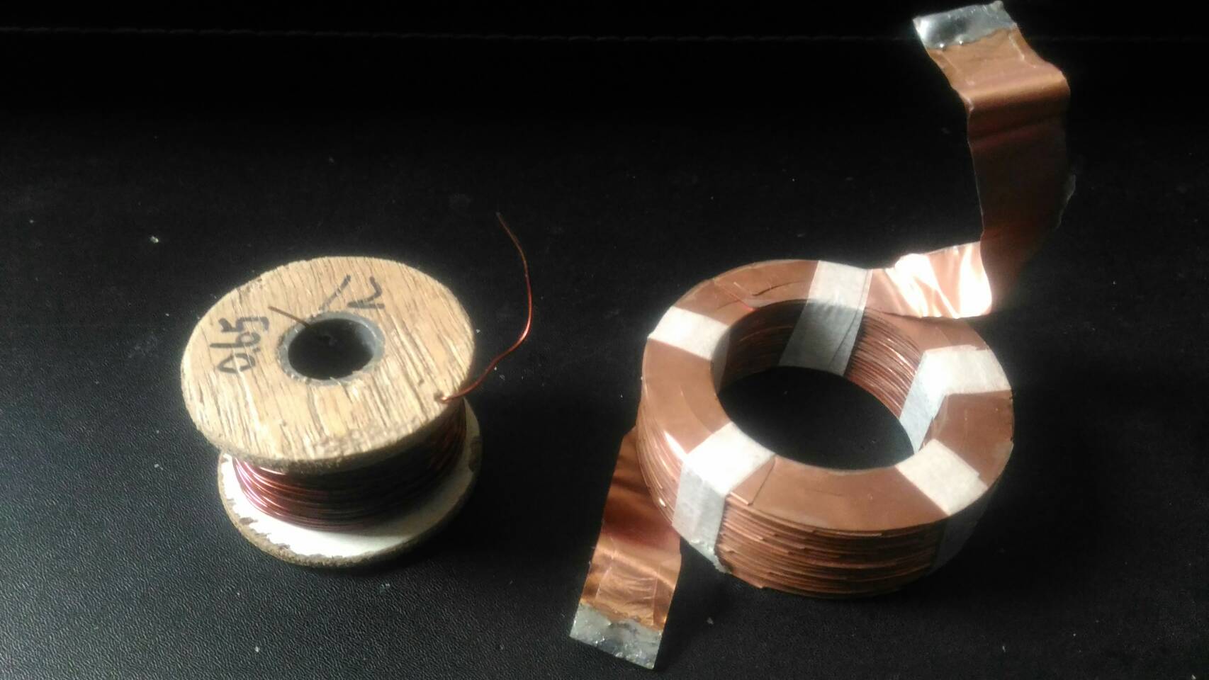

I would like to introduce to you a new type of inductor - the Flat Foil inductor.
Maybe its concept is not so new, but currently it's not available on the market. Though some small flat inductors made of thick copper wires are available (i.e. edgewise inductors), but none of them are made of thin copper foils as this one.
Please refer to the picture of its first hand-made sample, unlike the currently available spiral foil inductors, though the new coil is also made of foils, but the copper foils are in flat (horizontal) directions and folded up to make the coil loops.
Spec of the sample:
inner diameter = 42mm
outer diameter = 66mm
copper foil thickness = 100um width = 12mm
layers N = 93
inductance = 453uH @ 100Hz (ACR=0.3ohm)
inductance = 375uH @ 1kHz (ACR=1.462ohm)
DCR = 0.3ohm

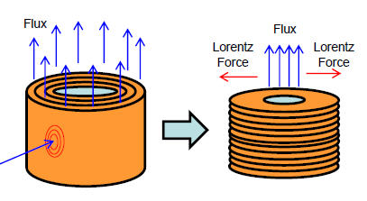

I'm a little confused over what this offers compared to a Goertz foil inductor?
Goertz foil inductor's foils are vertically and spirally wound, so I called them spiral foil coils, this new one has foils horizontally layered.
In the figure the left one is spiral foil coil, and the right is flat foil coil.

And about manufacturing, after paste both sides of the copper foil with BOPP isolation films, I then use a die-cut mold to cut the copper foil into the shape I need, and then manually fold it up, a lot of man-hour is required.

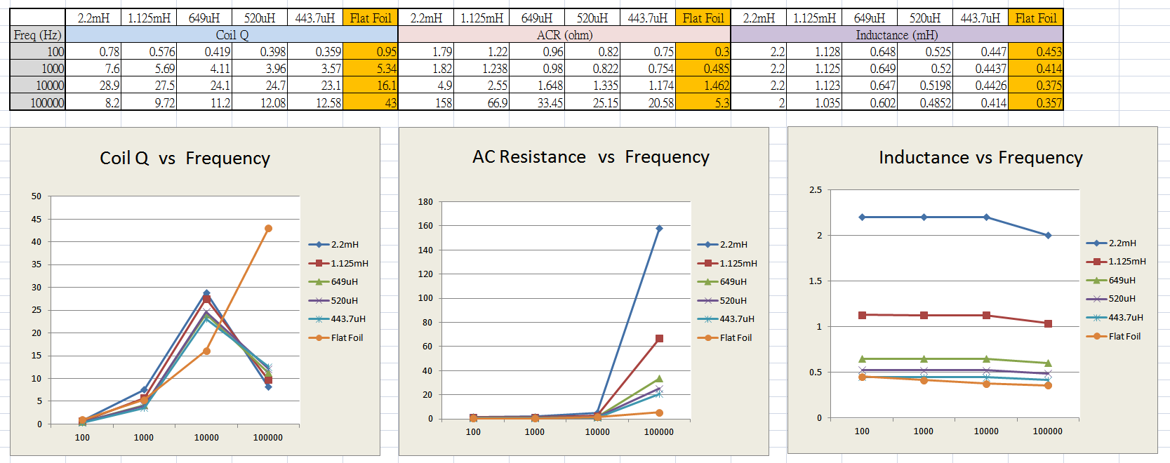

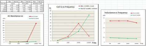

But I have measured some data with a DE-5000 LCR meter for your reference. (Four measurement points, 100Hz, 1KHz, 10KHz & 100KHz)
I used a wire wound inductor (0.65mm, 22AWG wire, 2.2mH) to compare with the sample flat foil coil.
The wire wound inductor is actually some copper wires I bought from a vendor, and it comes as it is, randomly wound on a wooden bobbin. Wire wound coils are really easy to make, but they have their problems.
Summary of the result:
1. Wire wound coil's AC resistance increases dramatically at high frequency due to skin effect.
2. The Q factor of the wire wound coil has a peak near 1KHz (might be related to the skin effect), while the flat foil coil acts more like an ideal inductor.
3. The inductance of flat foil coil decrease by frequency, the decreasing rate is related to the ratio of the inner and outer diameter of the flat foil coil.
4. If there is a Q-factor peak for the flat foil coil, it could be at over 100KHz, say about at MHz range. Can we estimate the resonant frequency is also at MHz range?
5. For the flat foil coil, inductance decreases as AC resistance increases. A quite interesting compensation between these two.

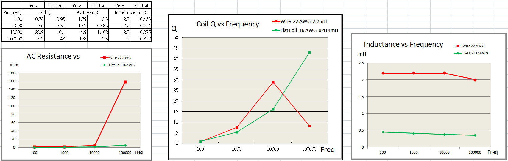

A correction first, the wire wound coil has a Q-factor peak at around 10K~100KHz, not 1KHz (mistaken in previous post).
I have unwinded the wire coil and got four more sets of data with different inductance for your reference, please refer to the figures below.
I am not sure about the requirement of a class-D amplifier, but it seems that some filter designs for class-D also use edgewise inductors. Comparing to the edgewise coils, the folding flat foil coils are relatively thin (for instance, 50um per layer is possible), a more than 50% reduction in coil height could be possible.
And there are a lot of 400Hz aircraft transformers using spiral foil coils for better high-frequency efficiency. Aircraft use 400Hz (not 60Hz) as the frequency for their onboard power transformers because higher frequency results in smaller form factor and lighter weight. In my opinion, flat foil coils could be better than the spiral foil coils for these 400Hz transformers, at least flat foil coils have a better heat dissipation capability for the core. But again, the hard-to-manufacture issue must be cleared first.

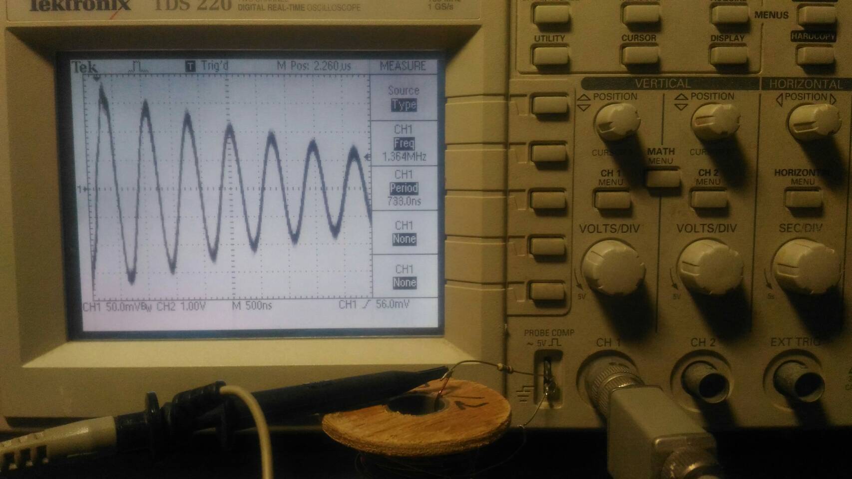

Here comes the resonant frequency.
For the Flat foil coil 414uH resonant at 2MHz
For the Wire-wound coil 443uH resonant at 1.364MHz
I used a TDS 220 oscilloscope's probe calibration output (square wave 5Vp-p @1KHz), with a 1M ohm resistor connected in series with the coils and measured the self-resonant waveform.
The results seems pretty good for the relatively large flat foil coil, and I think its resonant sine wave has a better shape than the wire-wound coil (less distortion and about 4 times of amplitude). But it might be unfair because the wire-wound coil was randomly wound on the bobbin.
