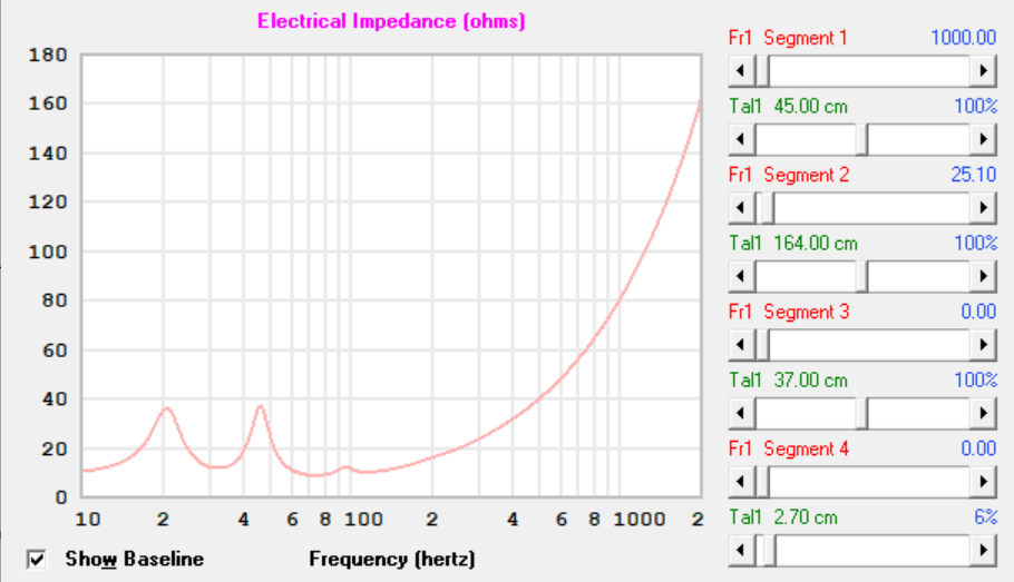

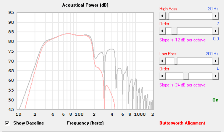

Please see this attempt to add that cosmetic exit flare. I have switched to the TH model Driver entry is though the side of that flare and driver is reversedOver damped response that the room, VC heating will move it towards flat in-room and spikes are vent pipe harmonics comb filtering with the driver's output and AFAIK the only way to deal with them is by 'critically' damping the vent.
The back chamber has fill that brings down the spikes, and the exit has some fill that rounds over the remnants of the spikes. Adding the system low and high pass filters gets rd of these products (artefacts)

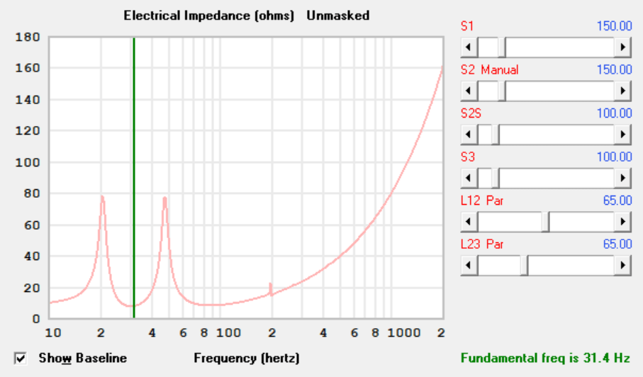

Something is weird, though. The impedance twin peaks are no longer symmetrical, but the system retains the Fb=Fs 31.4Hz. This maybe due to adjusting segment lengths to compensate for the exit flare and fill for dampening. Not sure what's going on with the impedance even though It's tuned at Fs

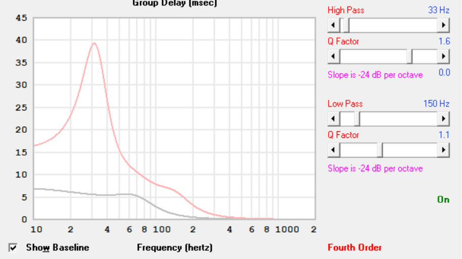

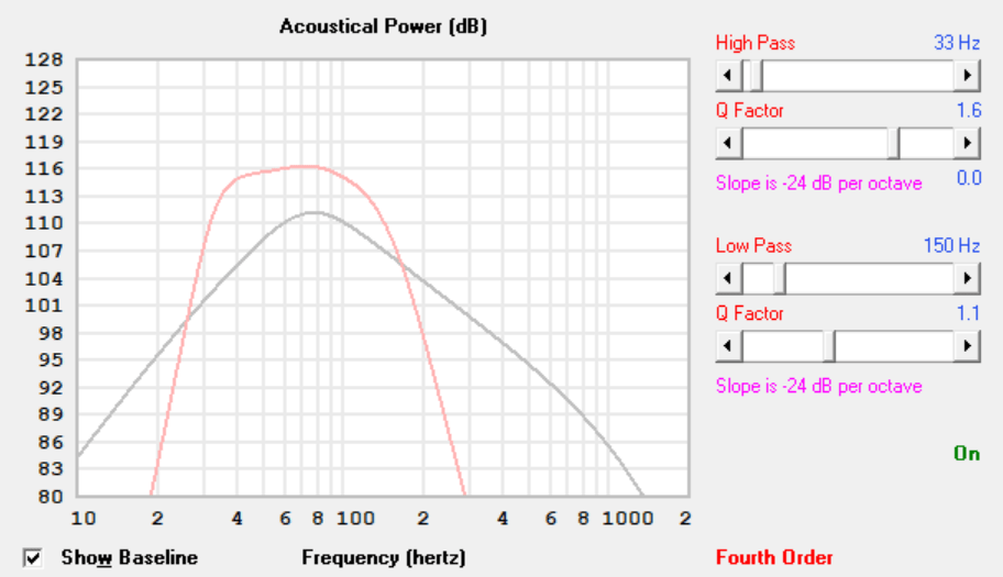

That last pic is some 'fourth order' filter thing that I don't understand, but the response looks good to just get louder. I wonder if my DSP unit supports this

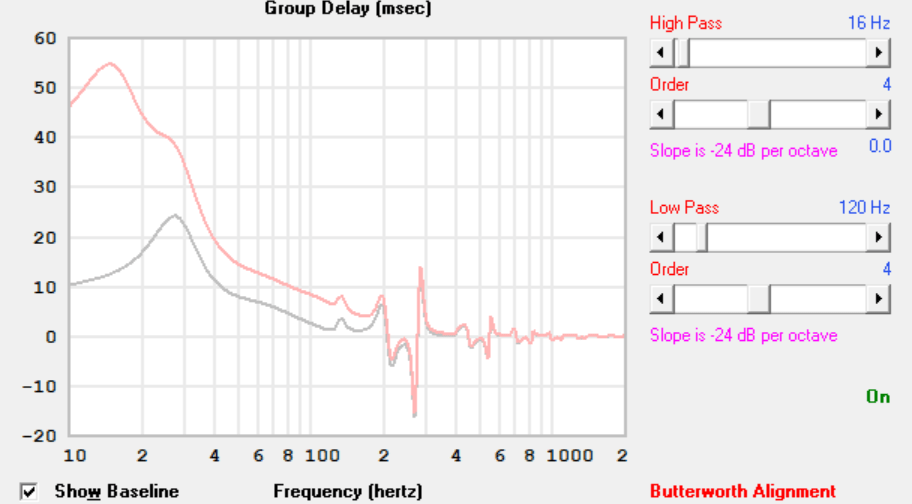

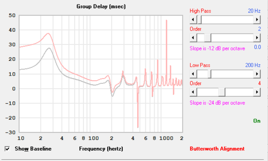

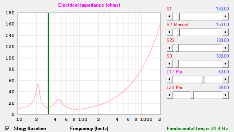

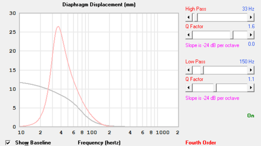

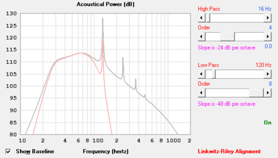

Damping/stuffing will lower impedance peak(s), especially vent damping (making it more aperiodic) as it moves it back towards sealed.

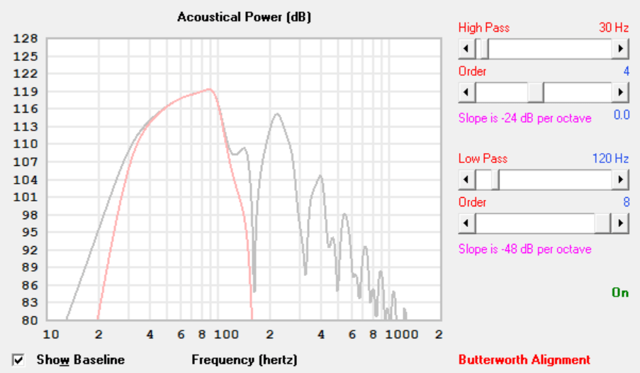

Just what it looks like, a 4th order low pass electrical filter + any XO to the rest of the speaker system.
No clue about DSP options.

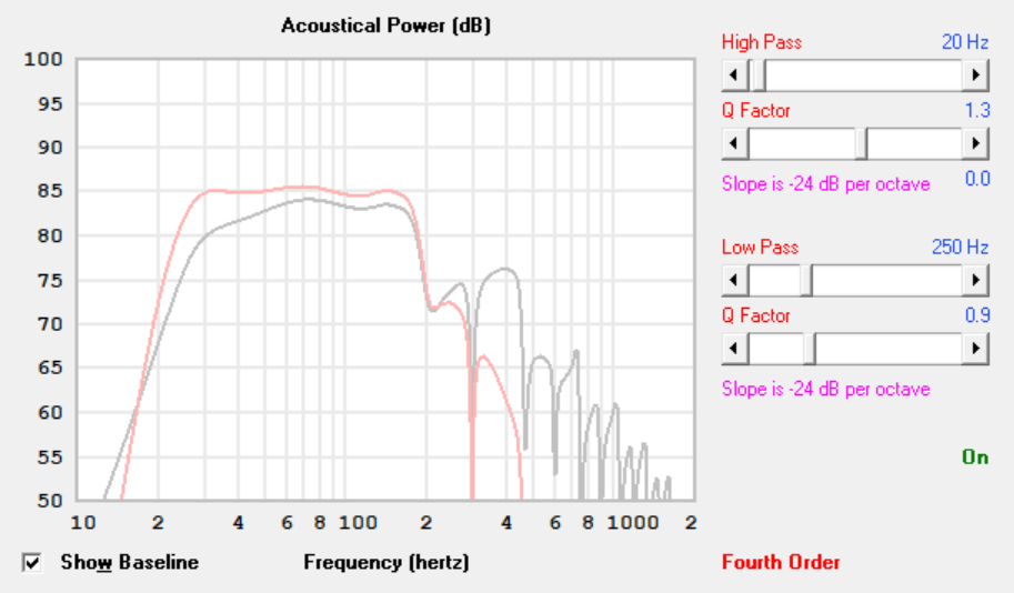

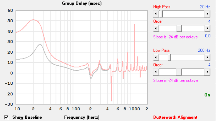

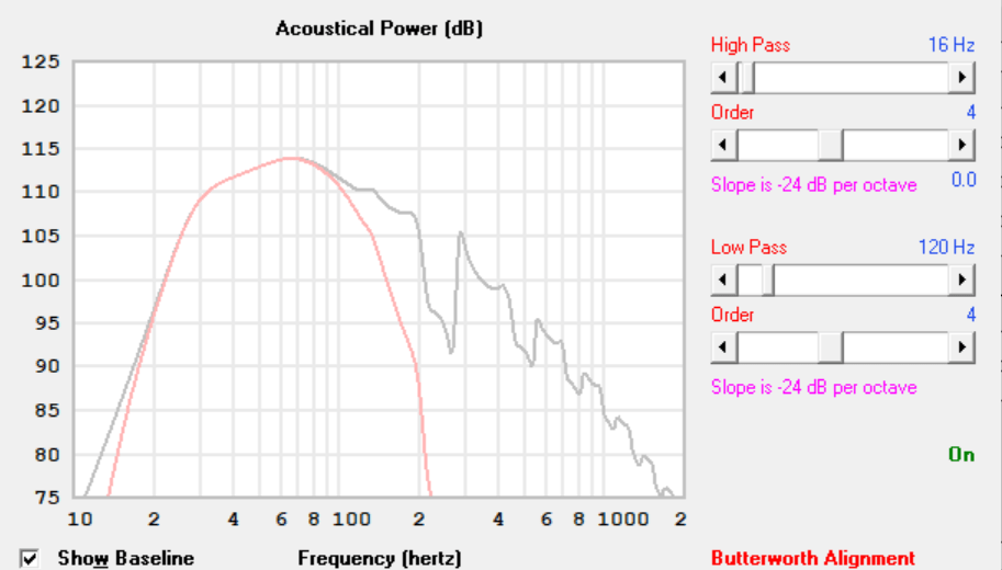

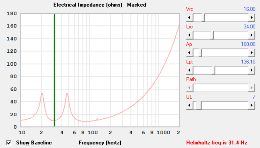

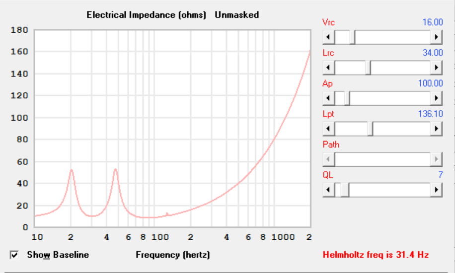

Would you be able to point out these effects on a graph? Not knowing what such products look like on the screen is debilitating when trying to fathom what you folks are saying

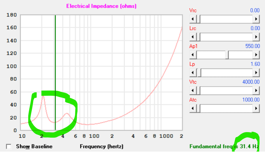

Please help understand what those peaky dip things are in these example pics below, and are they a concern?
Is this the good kind of transient response and roll offs?
Fill dampening to reduce the peaks?

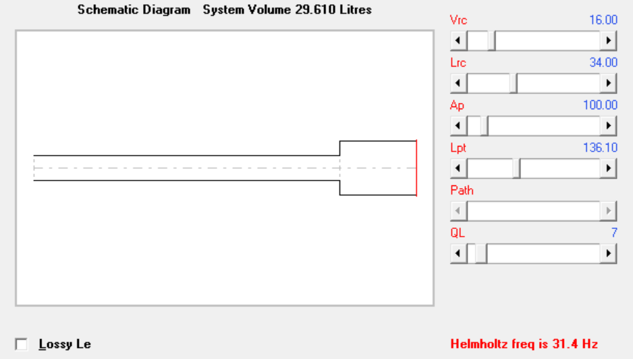

My basic BR with Vb=Vas and FB=Fs. This what I have been trying to give a cosmetic very large flare exit to, and the basis for the original post in this thread. This is unfilled, unmasked, unfiltered and without Eq. The BR sim gives this note in red, which I don't understand

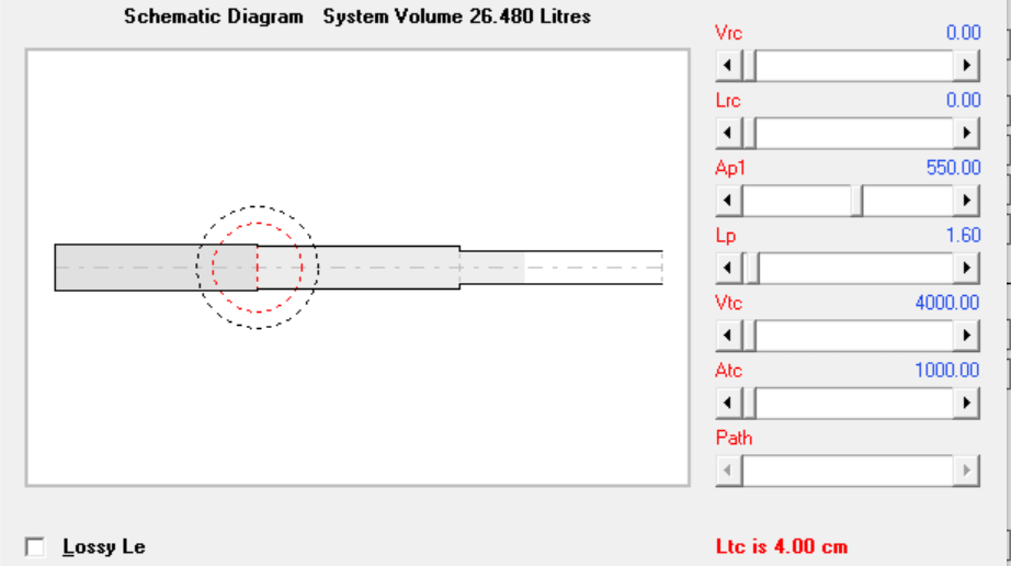

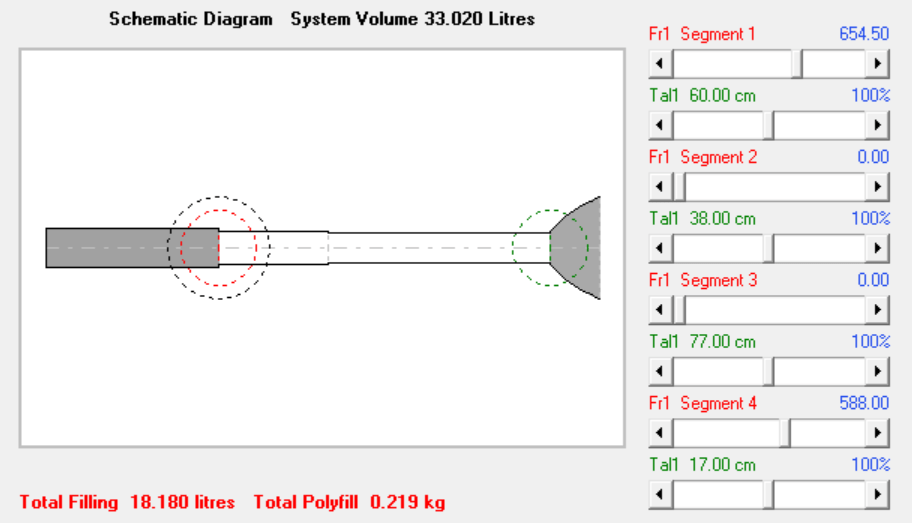

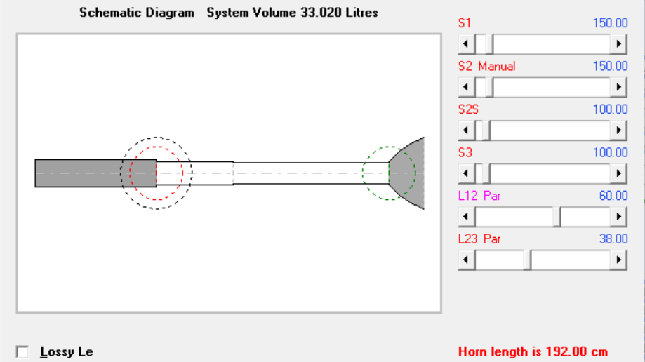

My basic TL, 3 stepped segments, S1=150x65mm, S2=100x65mm, S3=80x65mm, Vtc=4L. I am really attracted to the TL idea as a crazy tiny labyrinth like this with a huge driver sticking out of it would be cool, and I would build this over the BR if this can be a legit candidate. I'll upload full construction and model input data and methods as a DIY musical multi instrument amplifier to share back everything I have learned from you guys to make a better cab

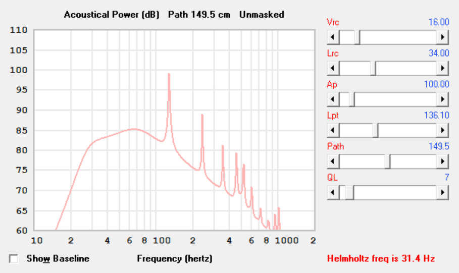

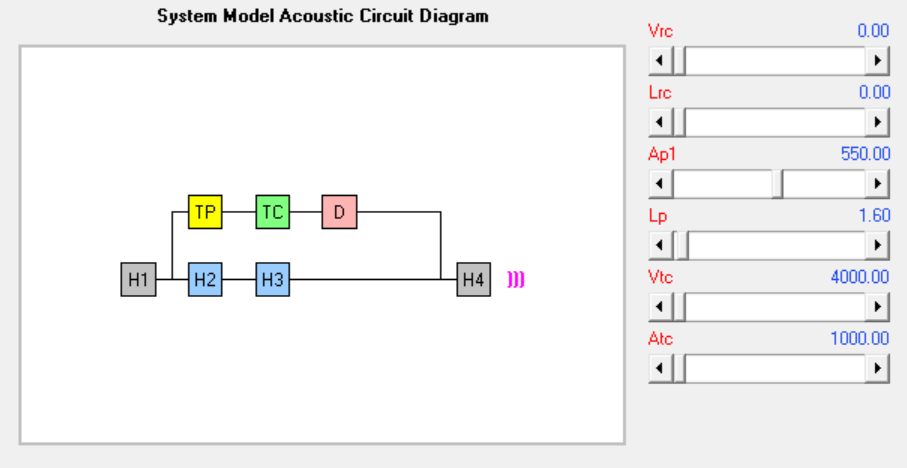

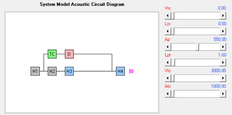

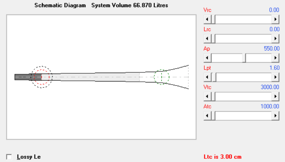

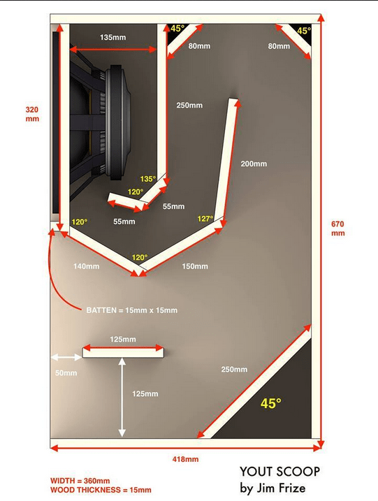

I came across this very compact 12" scoop design. Proportions look pleasing, but I couldn't find any performance details on it. Does anyone know this design? Making something like this that can do low bass with my driver would be brilliant for ambience aesthetics. I would love to design along those lines but aiming for Fb=Fs 31.4Hz

Is this a good or bad thing? I can't work out if the asymmetrical twin peaks due to dampening means a driver not happy on its suspension, referring to Whitedragon's comments on the impedance peaks earlier in the threadDamping/stuffing will lower impedance peak(s), especially vent damping (making it more aperiodic) as it moves it back towards sealed.

The back horn length is only a little more than a meter long, 1/4 wave length puts it's low corner around 67Hz.I came across this very compact 12" scoop design. Proportions look pleasing, but I couldn't find any performance details on it. Does anyone know this design?
It will have the usual BLH upper response dip due to the front and rear output being out of phase.

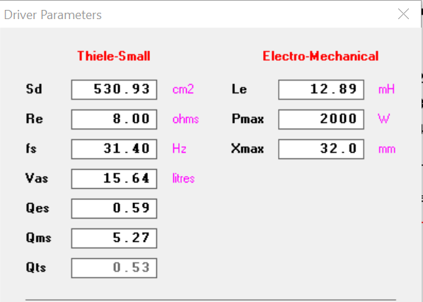

Please find the attached files for the three basic versions

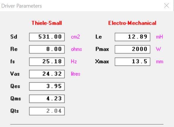

I was referring to the wide range of Qt specs that includes an up to a Qts too high to be of any use in a typical HIFI/HT app, so we'll have 'agree to disagree' due to the 'physics of the situation' 😉:
In HR's default IB its ~infinite acoustic loading pushes its impedance loading down to ~11 Hz and its FR is just a default prediction of its HF based on its inductance (Le), which likely is just as useless.
For instance; in 70 L, 2 kW gets us an Xmax limited peaking @ ~18 Hz with a flattening power response at a dismal 90 dB + a whopping 146 ms GD @ ~13 Hz!
I wrote the above before loading it in HR only to find it's even worse than I assumed 😱:The box only loads the driver to its upper mass corner (Fhm) where T/S theory peters out, so using the ZXI12.4D's (current) worst case Qts = 2.04, 25.18 Hz Fs and ignoring probably significant VC heating that will raise it:
Fhm = 2*Fs/Qts = ~24.7 Hz! There's under-damped ('ringing') and then there's this razor thin source of irritating VLF noise that will probably cook the driver even at low power as heat rise pushes it ever further below Fs, hence my 'strongly' suggestion to all within the 'sound of my voice' to not consider it for anything audio related beyond driving anybody/animal 'off the rails', so we'll have to 'agree to disagree'. 😉

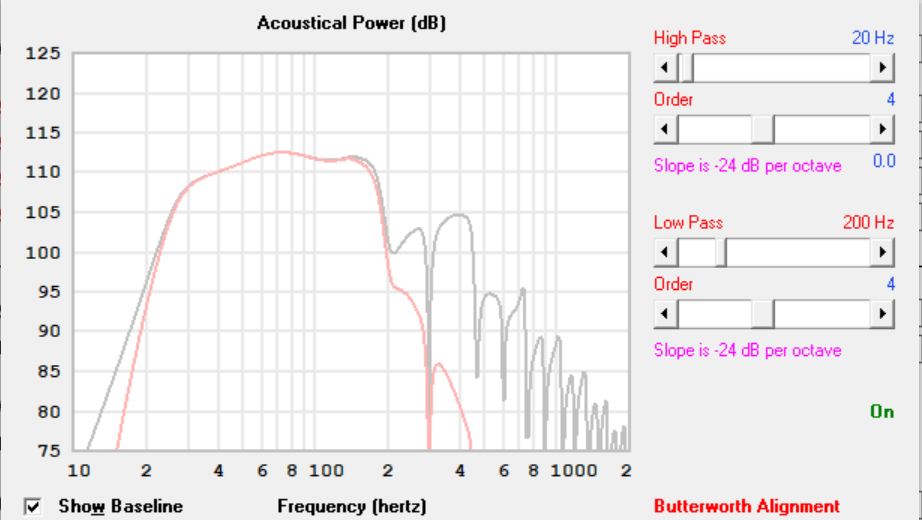

One more to add to the mix. Does this make for EDM/Dub capable microPA type candidate? There would be four in total. They are proportioned to form stands for the tops and the driver in the mouth/exit down low to keep CG low
Cant seem to do much more so will make some boxes and start listening
Red is Eq on
Red is Eq on
At a glance, I trust HR enough to say they're designs worth experimenting with if Qt isn't too high, but you've yet to measure some broken in driver specs, so 'color me done' 😉 for now.Touched up a bit more, and now I also figured out how to apply full power
I am no where close to understanding this. 0.534 seems ok, doesn't it?I was referring to the wide range of Qt specs that includes an up to a Qts too high to be of any use in a typical HIFI/HT app

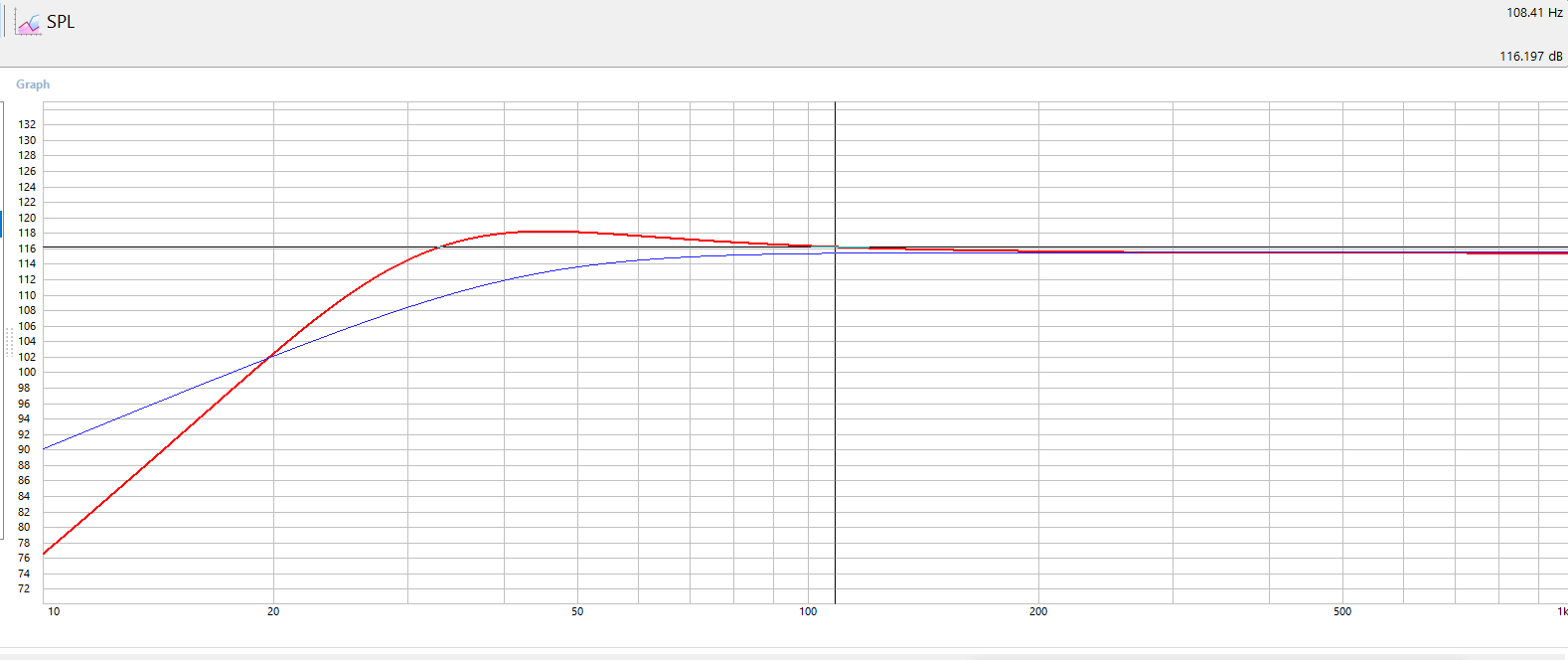

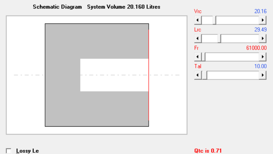

Which program is more reliable? Or is it the output graph resolution that makes the hump appear pronounced. The following are the same 20L sealed sub in WinISD and that box ported to Fb=Fs 31.4Hz. They look so much better in WinISD
Why does HR show a humped response for sealed and WinISD doesnt?
Yes and no, depending on how much 'we' want to adhere to following T/S theory: https://www.diyaudio.com/community/...uild-with-some-more-bass.355384/#post-6227208I am no where close to understanding this. 0.534 seems ok, doesn't it?

GMI was referring to the wide range of Qt specs that includes an up to a Qts too high to be of any use in a typical HIFI/HT app, so we'll have 'agree to disagree' due to the 'physics of the situation' 😉:

Overall, HR, but in the box loading passband I assume they are identical other than need to compare each chart's vertical Vs horizontal scaling..........Which program is more reliable? Or is it the output graph resolution that makes the hump appear pronounced. The following are the same 20L sealed sub in WinISD and that box ported to Fb=Fs 31.4Hz. They look so much better in WinISD
