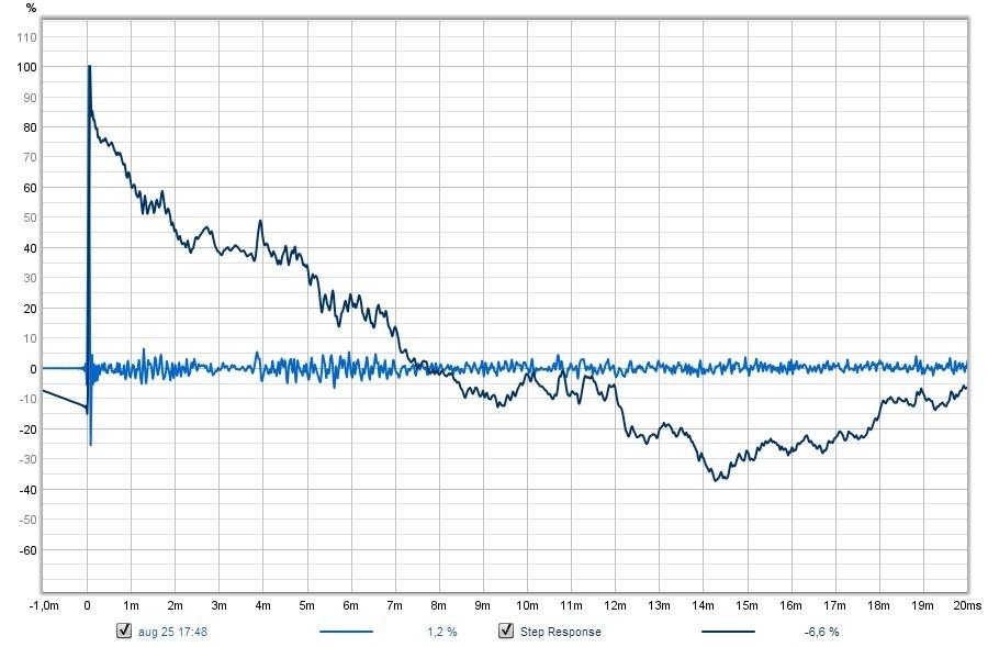

A few posts ago I showed an IR as measured at my listening spot...
Although there are (enough) reflections, as it is just a relatively normal room, the level of reflections is quite low for the first 20 ms.
It makes all the difference under which circumstances one hears the speakers. If you move close to a pair of Studio monitors, the
cross talk effects and disruption of tonal balance will be way less noticeable too. If there were a couple of peaks in that graph of a
higher level, I wouldn't have to resort to all this trickery. But I actually wanted this . I wanted to get rid of the queues of my relatively
small living room. I substitute it with something more fitting to the music. Oh well, if it works for me . My-Fi.

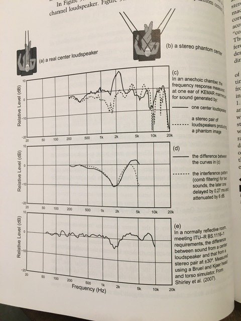

This image is the best explanation of the effect that I have found. It is also straight from the horse's mouth (Toole). See what happens with a real center and a phantom center. The 1.6 kHz dip is filled in by shuffling the phase of the two channels, so that they don't cancel because of being in phase in a regular config.
In my setup, the dip is mild and in most rooms, it is filled in somewhat by other reflections (per Toole). But switching the shuffler on and off will give you a clear idea. Once you hear the right tonal balance, you won't go back.
The effect is most pronounced when a substantial amount of early reflections have been removed, either through directivity or absorption. If this is not the case you most likely will not hear the effect. When you have removed those reflections the change in timbre by moving your head can be quite obvious. There is a defined position right in the acoustic centre between the speakers where the tonality is correct and a slight movement away from this imparts a midrange timbre change which is quite obvious in vocals. It is really quite annoying to hear the sound change just by moving your head a few inches. When early reflections are present they fill in this region creating a timbre change of their own but it's not then so position dependent and obvious to hear.I'm really bewildered about this whole issue. How does this change in tone even matter when you're in the sweet spot?
Yes, as stated above, you need a well matched system (not too hard) and early reflections that are low in level. The shift in tonality isn't from you moving around, it's from the sound moving around. The same sound played in the center will sound darker than if it is panned hard left or right. That darkening by comb filtering notches can make dialog difficult to understand in a phantom center image (as opposed to a real center speaker) and that what the paper linked to in the top of the thread is about., The effect can also be heard when a sound in the music mix is panned hard left and hard right making it seem brighter than the center. The graphic posted by RA7 is a good illustration of the major frequency response notch.

Quick thought on the image and related comb filter. If moving along center normal between the speakers (see #1076) this comb filter would also shift in frequency and vary in amplitude as path length difference to each ear from each speaker changes, more or less head on the way. Path length difference being greatest when speakers are 90 deg each side of head, and least when closer to where the nose points at.
This would mean roughly, that the comb filter might get pushed high enough not to bother if speakers are closer together than listening distance. Also, if the speakers are further apart and even though onset of combfilter gets lower in frequency higher up there is now shadow of head redusing sound to other ear some. Anyway, something to think about. I have to try the phase suffling one day and see if it moves the proximity stuff further out in the room as well, to practical listening position with practical speaker position.

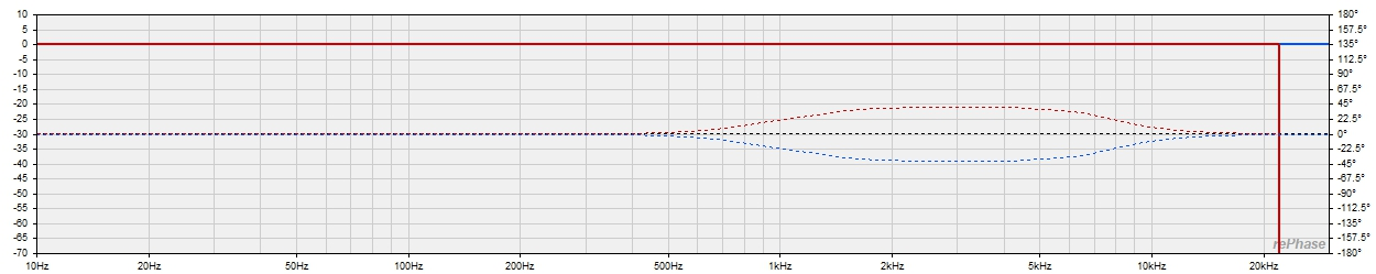

As I had EQ-ed my system for phantom center, I perceived brighter sides compared to the (right) phantom balance and decided to combat it with mid/side EQ.

- Why didn't I reposition the speakers (toe in/out etc.)to adjust the tonal balance? Because I absorbed early reflections, this wasn't an option.
- Why do I absorb early reflections? To increase intelligibility and clear up the sound and have better imaging and details.
