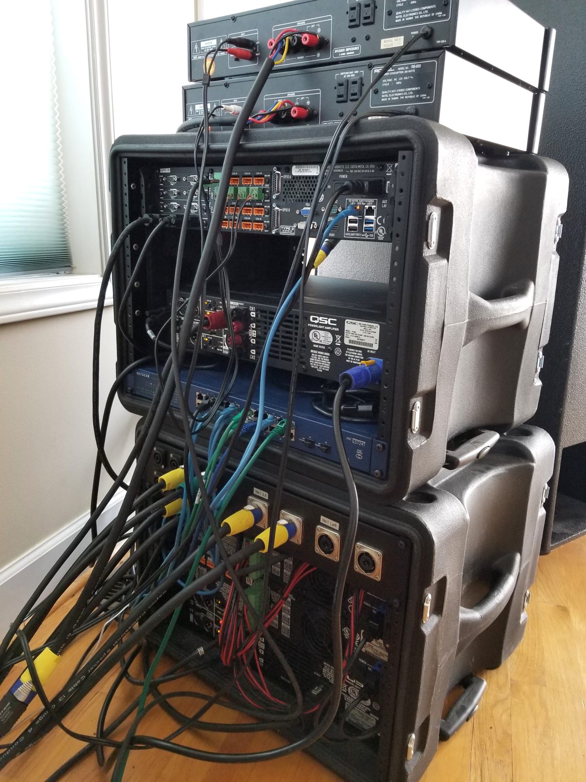

Three 5-ways can be a mess...as the rear of my rack shows..(this mess is after the rework and full verification Lol)

The amp rack changeover has had a bigger effect than i thought amps could make.
Before, I had a wild mix of different types/class amps driving different sections because of the evolving migration from 2 channel to 3-channel.
Now, QSC PL3s drive all three subs, CXDQ network amps drive all three lows, and all three mids.
The only difference in things now, is L&R coax CD's use Rotel hi-fi amps, and the center coax CD uses a CXDQ.
I have a third Rotel amp, but need to get another Q-Sys line out card to use it.
I'm also going to try to nab another CXDQ for the L&R CDs, just because I'm a little shocked at gaining clarity from swapping amps, and want to get things the same. (as well as compare the Rotels to the network amps)

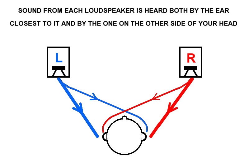

Here we go:
Your left ear hears the left speaker (with a mono signal). The right speaker will also be heard by the left ear (with that same mono signal playing) but that right sound will be delayed in time and with a reduced SPL level. The other (right) ear hears the right speaker, but also the left speaker, but that left sound will be delayed in time and reduced in level.
Both time delayed signals create combing when they combine with the direct sound. This combing discussed here will happen in every 2 channel Stereo setup.
An average room is full of reflective surfaces, like walls, ceiling and floor. While the speakers are playing, these surfaces get hit by the sound and reflect it towards the listener's ears with some delay. These reflections, delayed even further, will 'partially' fill the comb patterns we just discussed (and create new, more dense ones in the process). End result: you will hear Stereo and all things are fine in the world.
Now let's use a more directional speaker. Or place absorbing panels at first reflections. Or even use speakers that avoid certain reflections. Now we can actually hear these combing effects we discus in this thread, and notice the tonal differences between phantom center and the left speaker or phantom center and our right speaker. I wouldn't regard an OB speaker as more directional in this sense, as the back wave will reflect back to the listening spot at som,e point and act like that regular room, it will also help hide the discussed combing effects.
If you observe the picture in this post, you'd probably see that this problem we speak of won't happen at all frequencies. Our head provides shading for higher notes and at lower notes the wavelengths become so long that this combing does not happen at these frequencies any longer.
