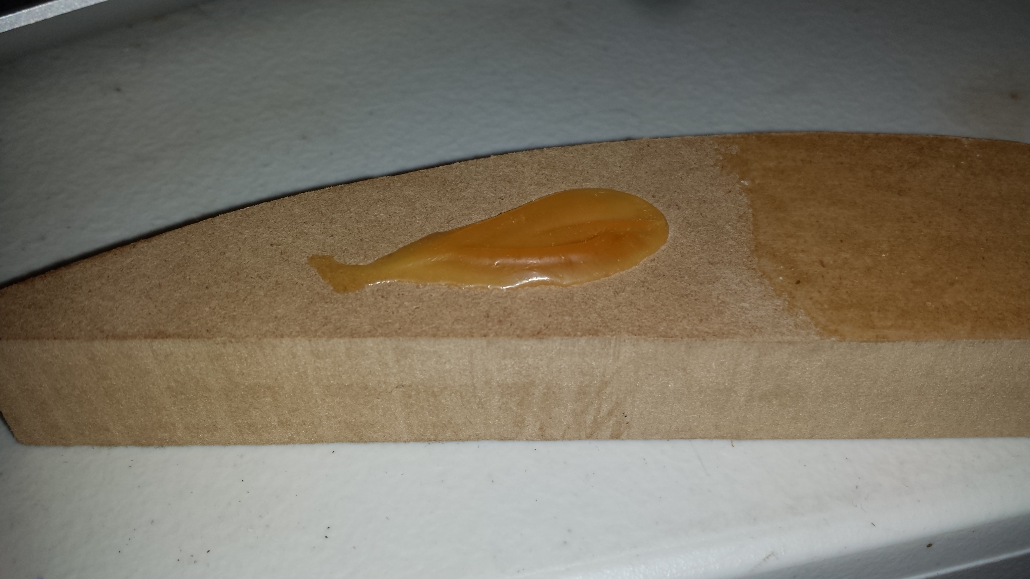

Talking about glues, I tried titebond 2 and 3 before, yesterday I gave a chance to titebond 1 (classic) and I am really impressed how it look once dried. Take a look at this, it feels just like epoxy, very very hard, just as a rock.

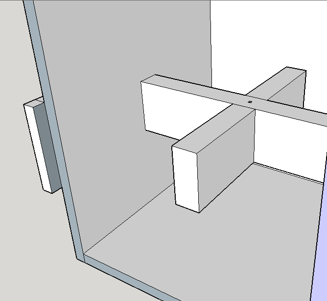

Your cross is much better than a dowel.
Gives more area to glue the side panel to the end grain of the cross. And allows many screws into the end grain for a stronger tension joint.
A dowel works reasonably in compression, but does virtually nothing in tension, because the glued joint is simply not strong enough to resist pressure inside the cabinet.
The two braces don't need to intersect. They can pass each other and still give adequate bracing effect.

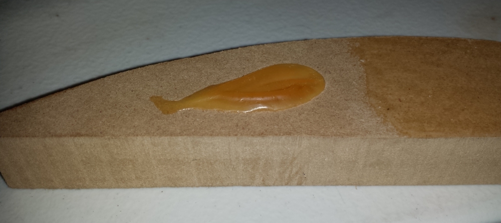

detail of a splodge of glue?2,048px × 1,152px

Did we need to see a detail of a splodge of glue?

I did not understand what you meant about the glue, I just wanted to show it like, hey, have you seen this glue before, its awesome.

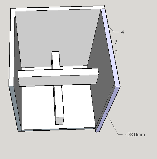

😀 I am starting liking that cross, it's massive and very easy to do using 2x4 lumber (96" long and less than $3 in homedepot). Its convenient if they intersect, because I need the mass as centered as possible, which limit line is determined for the speaker mounting depth I want to keep, so intersecting them is the best way. You simple make a dado joint, as big as the half of the stick, then put them together and turns as if it was an unique piece.
You don't need a dado. Just move the two timbers by half a depth each and they then miss each other.
They are still close enough to the centres of the panels.
Remember a Member said some posts ago that moving the brace off centre can work better than on centre?

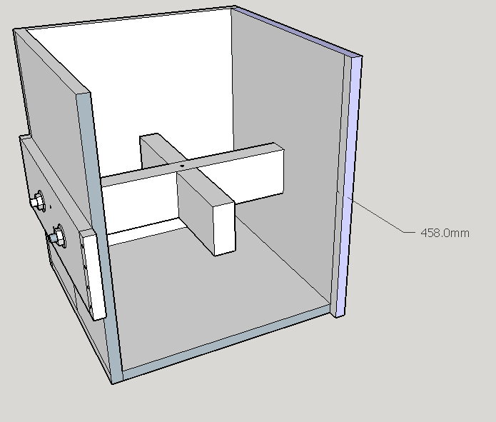

Yeah, I remember that message, but I am not sure if I did understand it. So you say that this way is best? (picture below) I put them vertically because waves travel up to down, so I dont know how bad can be increasing bracing impact surface.

A dowel across the gap between the panels can take compression when the negative pressure pulls the panels towards each other.
The dowel cannot provide any tension force for the condition when the positive pressure pushes the panels apart.
One has to engineer a method of transferring the panel pull movement into the brace.

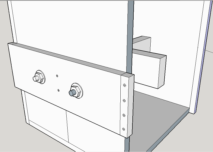

I feel stuck now with all this and going nowhere, I think that that massive cross (still light) with the dado is all I need, it has the advantage that it is about 90mm high, so it will cover good area in all walls, and external bracing will be placed a little higher than center, giving support more specifically to upper area, there I am not limited for mounting depth, which I need to keep it about 9".

You posted this idea earlier on in this thread, at which I reacted in post 20 where I explained that (I think) this idea is wrong. Please comment on post 20 if you want to defend this idea.A dowel across the gap between the panels can take compression when the negative pressure pulls the panels towards each other.
The dowel or rod can resist compression.Stiffness and strength are two different things. For a subwoofer you need stiffness. Strains are small, so the stiffness is constant; it does not depend on whether the rod is loaded in compression or tension.
It does nothing to resist tension. The cabinet expands due to internal air pressure and the rod just sits there floating with air gap/s at it's ends.
The brace has to ATTACH to the panels to carry both tension AND compression.
