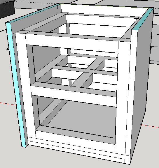

This is my final design, it's simple but effective I think... 2x2 lumber on every corner, without forgetting the middle part. Although they are not hardwood, this sticks (2x2 lumber) are pretty damn hard, which combined with 3/4 mdf, I think I will get more than enouugh Stiffness. What do you think about this? It's for a 12" and 2sf sealed enclosure box. I am going to use #10 4" screws and titebond 2 glue. The nice part about using 2x2 sticks, is that I wont screw any MDF edge, but only on their faces, close to the edge. I am also going to put double baffle and bottom. This will be a solid war tank he he.
That's not going to do what you want- the most important parts are the cross-connection of panels in the middle of the enclosure- ribs are much less effective. Couple the ribs to each other through the middle of the enclosure and you'll have a much better bracing design.
😱 Oh yeah, I think you are right, I actually going to put a cross connection in the middle part. 😀
Better. Do the the top and bottom too, best if you can join all the bracing together. Also, slightly off-center for all the ribs/bracing is preferred. I don't see where the driver's going to mount- make sure that panel is really solid.

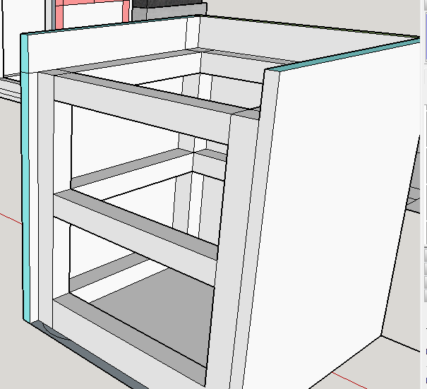

Yeah, that's what I was thinking about, only problem may be the top, where is where the speaker seats, so I am only bracing everything, except top.
Yeah, too much bracing everywhere, but I am counting the space that the bracing is taking, so even with lots of bracing, I will have about 2 sf of free space.
Can I expect a high quality sound from this? because I am pointing this thing to be a high performance sealed enclosure, that's the reason i don't care if there's too much bracing or end with a heavy weight. I think all this I am doing, is perfect for sealed enclosures, don't you think?
Vertical brace would be better to connect the top to the bottom in one continuous piece, neither should be mounted dead centre, and you can intersect them with a half-lap joint if you like.

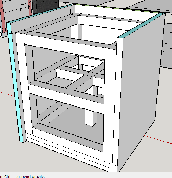

Because of those battens, theres no need to worry about screwing the mdf, I can use any screw and the MDF won't split (any MDF will be connected together indirectly by the 2x2 wood.). The good thing of locating the mounting hole at the top, is that it creates enough space for very big speaker magnets, so that's an advantage. I think that I am finish with that last design I showed, any other thing may be a minimal factor. All the battens are going to be connected by 4" screws, and glued with titebond II. which is a pretty damn good glue. I won't get any trouble installing the bracing, I am planning first glueing, then drilling and screwing. I have the tools to make extremely accurate cuts, so I expect everything fitting right once i am mounting everything. 😱 I really appreciated the comments, next time will see to use plywood and compared. Thanks.

If the drawing is to scale, which I assume it is, the battens and bracing are going to consume a lot of volume. I like battens as they make keeping the enclosure square easier during the build, but the volume will inevitably increase to overall size of the enclosure.

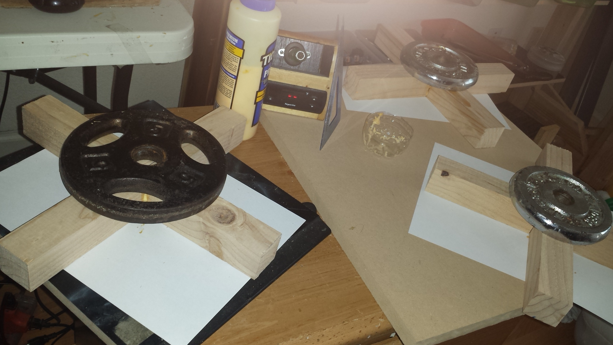

I didn't care too much about saving space or keeping light or compact, primordial factor was to build something suitable for high performance in sealed box. I am done cutting the MDF and all battens, now I am gluing the god crosses 😀 and preparing next steps. if everything keep going as good as so far, it should look like this. I forgot to mention that actually this design evolve some space saving, because of its verticallyti. In the middle I put a belt made of 3/4 wood, which adds even more strength in that part.
The loss of interior volume will compromise your bottom end more than any benefits (esp from the many useless braces) can help the sound. Just use cross bracing dowels and toss the rest.

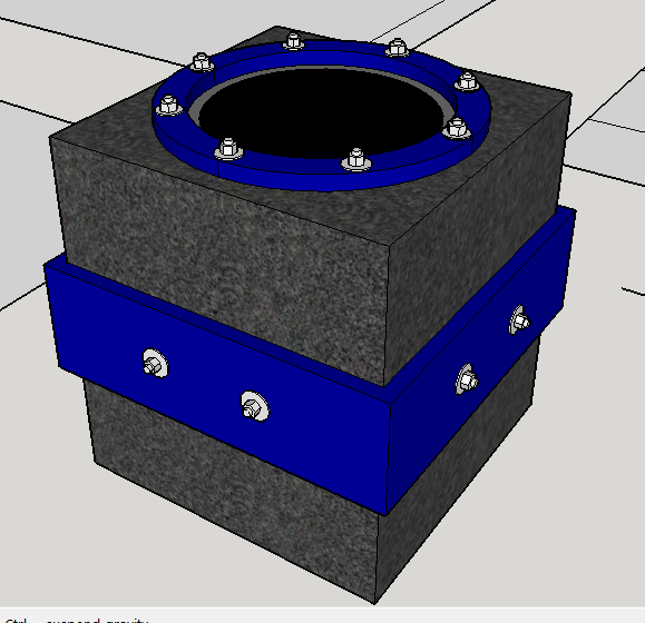

All the braces are useful, some of them are intended to act as a link between the MDF faces, so theres no need to screw the mdf edges, even if it was plywood, I would use those battens, they give extra support to corners. Interior volume without counting braces, is 2.3 sf, bracing is taking about 0.3 sf. At the bottom I have a MDF square, then it's reinforced with the battens, at the center I have another cross, linked with bottom cross, then it links with an external belt, which is not exactly light, that thing is massive, and at the top we have double baffle, the battens, and that circle that also should add more resistance. I don't understand if you say that my configuration is not ok, everything is necessary. The 3/8 bolts are for holding and adding aesthetics, I think look good. I was not sure if adding double bottom, considering that there seats a cross, maybe it was not necessary, and then we have the external belt, which is close to bottom and up side.
