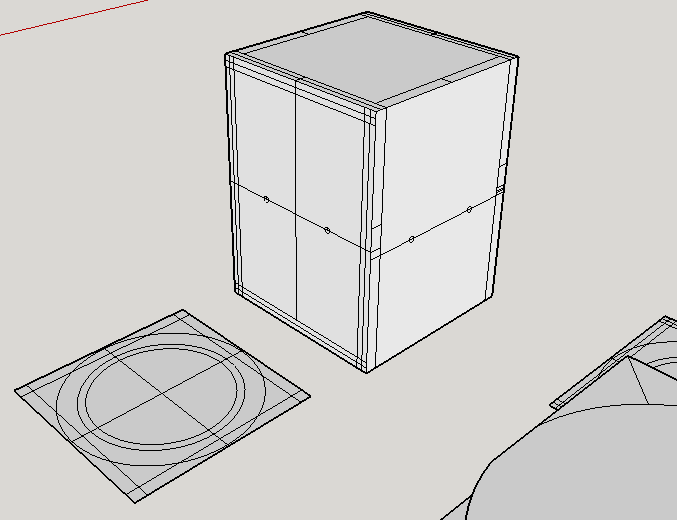

Hello guys. What do you think about this bracing that I just designed? it's supposed to be located just at the center of a rectangle enclosure. I liked so much the aesthetics of this piece, but not sure how technically convenient it could be.
The sealed enclosure is 1.5 cubic foot for 12" subwoofer, and 1" mdf thick.
So we have here 5 holes, each one with a diameter of 3". I will round and smooth the edges using a router.

The combined area of the holes is too small, it might impede airflow. The center hole weakens the 'ribs' that connect the walls to eachother, so the bracing will not provide maximum stiffness. Using four larger holes (at the corners only) would be a better choice if you want to use circular holes. Rounding the edges does not yield a significant benefit in performance. Bracing does not have to be aesthetically pleasing, it just has to make the enclosure stiff.
As TBTL suggests, all the strength resides in connecting opposite sides. You can do it with hardwood dowel rods and epoxy and save 98% of the weight and 90% of the effort.

Given the geometry, anything firmly attached to opposite walls around the middle will be pretty good but hard to beat cheap hardwood dowels from the big box hardware store for ease of fabrication.

Do you know guys, I have been thinking in making something mixing two materials, mdf as primordial material, and 1/2 zinc threaded rods, which are pretty cheap, and solid and compact as hell. At first instance I thought to cut the rod and using them as wood dowels in certain join sections, but leaving a little bit outside (about half inch), so you can add a big washer and nut (for aesthetics and gripping). Then after making this post, I concluded in leaving out the idea of that wood bracing, and using four zinc rods as bracing. I am also making a round cover for the baffle section, which will bolted with six rod sections, showing off the rods with nut and washer, not only giving a though appearance, but also reinforcing the baffle section.
I gave 0.5 cf more, so now it is 2.0 cf, walls are made of 0.5 x 2 glued mdf. I am pointing this thing to be a Mr though guy, designed for big potency. i don't have too much theory in my head related to sealed enclosures, but I supposed that good sealed enclosure should be as solid and though as possible, in order to offer the real potencial that sealed enclosures can give.

I use lots of holey braces. They are typically 30-40% holes. Besides bracing the box, a prime purpose is to distribute driver energy to panels other than the baffle. I purposely do not put them at the centre of a panel.
MDF is a lousy material for speaker boxes, especially subwoofers. You want something stiffer than MDF, 18mm quality ply is stiffer than 1" MDF and considerably lighter (a good thing, and as a side effect your back will thank you.
My subwoofers each use a pair of 10" push-push in a well-braced enclosure made of 15mm BB. Braces run in the long direction and are placed just off centre.
Stressed threaded rods are a valid alternative. Tighten them to create an inward stress on the box. You can actually tune the box with different tightnesses.

The most important aspect of a subwoofer box is that it has to be stiff. Flexing of the walls must be limited as much as possible. Reinforcing the edges / corners does not help as those areas are stiff already; the compliant parts are the large surfaces. Connecting opposing walls (cross bracing) is more effective.

I have used "spectacle braces", but I like your "5 hole brace" just as much.
I would make the holes much bigger.
The stiffening effect with bigger holes will be adequate.
If you glue and screw into the brace edge from the outside, the brace works in both compression and tension. You NEED strength/stiffness in BOTH directions.
