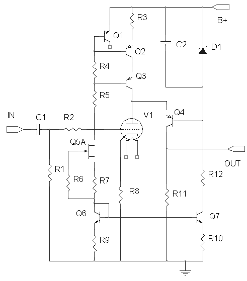

On the advice of folks here, I'll be first trying a feedback amp with the 7591s in pentode mode. Since the Fisher iron I have was designed with that app in mind, it's probably the best fit.
I still want to try using a 6CM7 for the preamp/splitter, with the small triode as the preamp. I'm thinking of using the circuit shown below to feed a classic concertina splitter. Probably too much sand in the circuit for a lot of folks here, but I think that sand and vacuum can be used to complement one another...
Values will follow when I have some time to stare at the tube curves for a while. I'll probably run the input stages using a 250V regulated supply.
