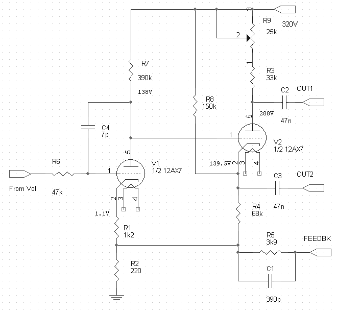

I was looking at the schematic of the 500B for inspiration, and I noticed that the designer returned the cathode side of the phase splitter to the summing node along with the classic feedback network. Can anyone wih more vacuum stte experience than me explain the rationale behind this? Are we talking nested feedback loops here?

Here is a copy of the input schematic for the 500B power amp section, so you can see what I was talking about with the phase splitter being returned to the summing node of the input stage.

Well, I couldn't find a print, so I looked inside my 400. Similar to the 500. And see what I found!
The negative feedback loop is, sure enough, applied to both the gain stage and the splitter. And since both cathodes are drawing through the same 220 ohm resistor, there is some positive feedback as well. This acts to increase the gain of the first stage.
That's a little more complex than I remembered it. It is a dangerous critter but it sounds good.

I forgot to note that the 400 uses a 12ax7 in this circuit. Also, I left out an 18 pf cap to ground after the .047 output cap in the cathode leg of the splitter. For hf balance.
And there is a 330 pf cap to ground at the tx secondary side of the 2.7k feedback resistor. Hf comp shaping? Rf trap on speaker wire?
