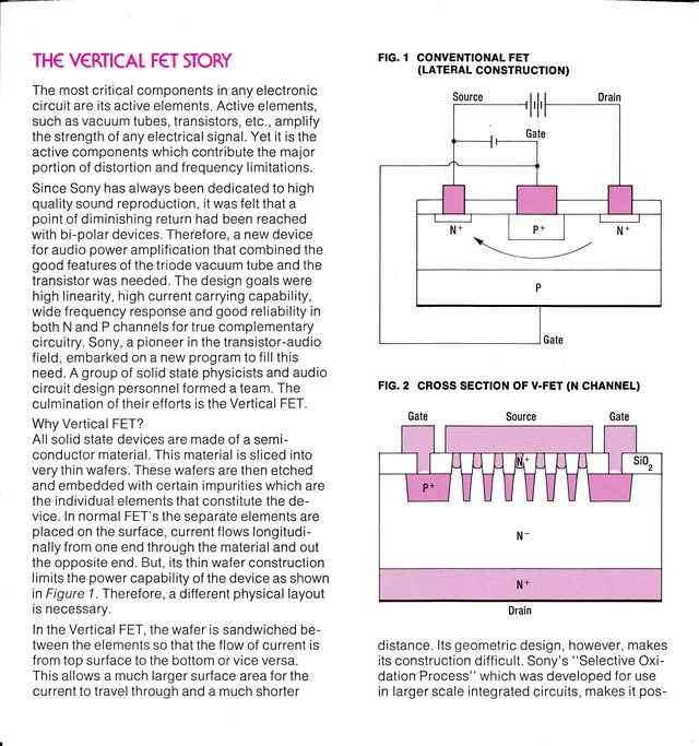

I don`t. The V stands for vertical, the technique employed required the vertical structure. The V does not stand for V-groove or anything else.
I dislike the name SIT.

But a JFET is not a MOSFET.
Certainly not. It is a vertical FET, but far from an "ordinary" vertical FET. Simply using pure silicon dioxide would have resulted in insufficient conductivity, thus a nonfunctional transistor. Otherwise, the lateral structure in itself produces lower distortion than the vertical structure.

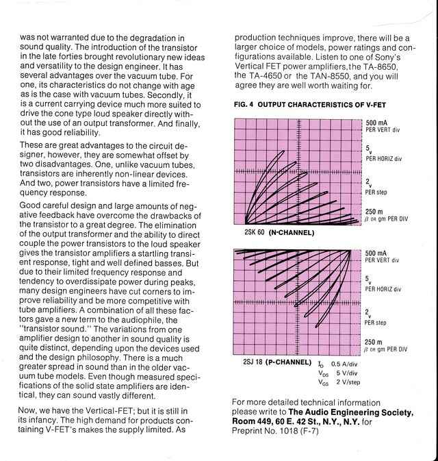

I wonder how many years we can expect a SIT would last under high temp (or high current) condition in class-A amps. It seems many original VFET amps by Sony and Yamaha are affected by dead original SIT, and they are not even biased class-A. Their heatsinks look rather tiny, though.
PS: I have an impression that SITs are very robust, and my ones are all still survived after stupid mistakes that I made.
Sony are going south because everything else but VFets
death diodes, bad connectors..... name it
I am using Sony TA 5650- TAN 8550 - after doing those replacement of death diodes / other suggested modifications. They are working beautifully. Many such modified units are working well - see Audiokarma site. Nothing wrong with V-Fets. Any power semiconductor can go bad - Murphy's law! That does not deter people from building amplifiers and using them. In fact Yamaha B2 amplifiers work even with bad treatments without doing any modifications.

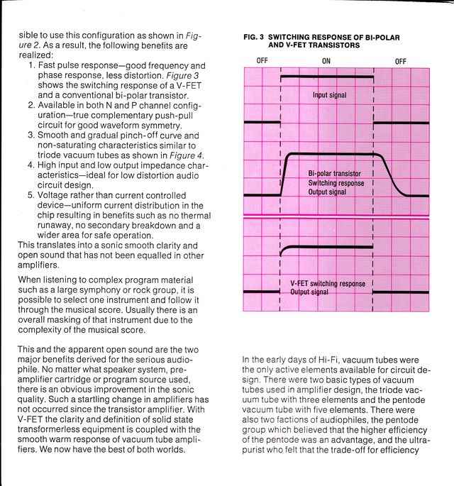

They also sound fantastic in Class AB
Well, it is easy to feel disoriented in the conceptual, definitional and naming mess of physics. What is alluded to as PN junction is an essential and central element of all semiconductors with or without a gate insulation film.
The excellence of the Sony V-FET decisively lies in the electrically and technically unique gate-source interface. The PN junction determines the transfer characteristics as well as the threshold voltage. Typically, the depletion region in a PN junction is very thin, yielding a low threshold voltage, a large transconductance and huge interelectrode capacitances. Because of its high resistance, almost the entire bias voltage appears across the depletion region.
An oxide layer can be implanted between the gate electrode and the semiconductor. What is unique to the Sony V-FET is the exceptional thickness and material purity of the oxide layer. Constituting a series capacitance, the oxide layer reduces the capacitance of the PN junction and raises the gate to channel voltage. The nominal gate to channel voltage of the 2SK60 at 100mA is -18V (can even be as high as -25V), the input capacitance at Vgs -15V is 190pF and a small reverse transfer capacitance can safely be assumed. The buried gate is diffused in the doped regions and the low series resistance permits considerable gate currents. Applying a forward bias voltage to any depletion mode device is a bad practice. A heavier load requires larger driving amplitudes and preferably a driver stage with voltage amplifying ability.
res07njc,
the depletion layer controls the conducting channel and transition consistency. A short channel length is hard to control and more prone to velocity saturation. Since the voltage to current relationship is nonlinear, there is no way to define the resistance for a PN junction, however, it is reflected in the threshold voltage. The high threshold voltage of the Sony and Yamaha devices suggests a high resistance layer, that is, a high built-in electrostatic potential. The reverse bias provides appropriate channel control by restricting the channel thickness and augmenting the depletion layer. No current source.
