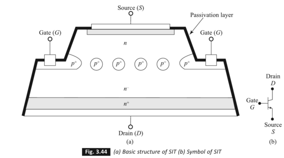

The name V-FET denotes vertical MOSFET. The gate and source terminals are isolated by a markedly thick, homogeneous silicon dioxide layer, no epitaxial layer is applied to the source.
So, according to you, SIT or static induction transistor is variant of MOSFET (metal–oxide–semiconductor field-effect transistor). Would you care to identify metal oxide gate insulation on this SIT cross section, for the benefit of all us that are delusional to think otherwise?
tombo56,
what is the origin of that figure, it is not an accurate depiction of Sony V-FET. The silicon dioxide dielectric (not shown) separates gate and source and is an essential part of every insulated gate field effect transistor.
