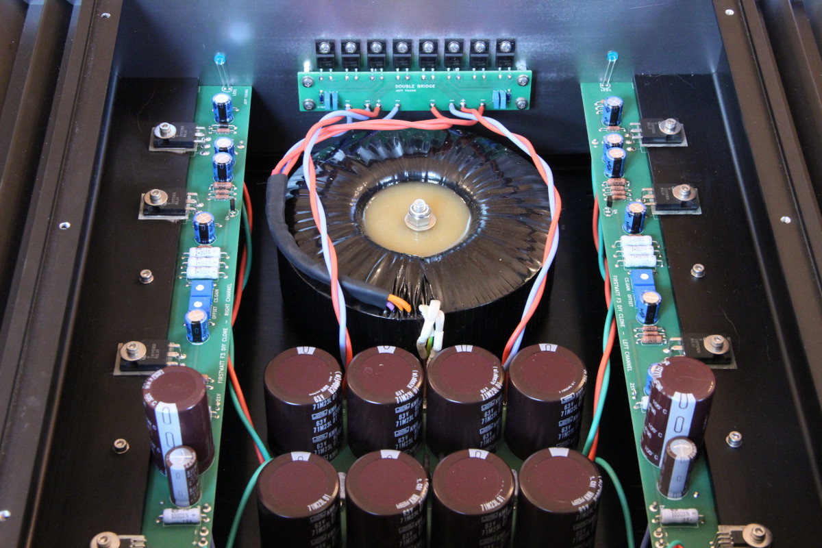

No. They're designed to go on a flanged heatsink (a la the Sony VFET amplifiers, or Conrad's flanged heatsinks, etc.).
Hi Ernst,
They're made for a FirstWatt-style case. 14" long (13.96" actually), with 2" hole spacing.
Jeff.
PS: here's a picture of my F3. J2 boards are same length and hole spacing, but a bit narrower.

A Conrad style integral flange heat sink looks like a smart move to me. Given Jeff's long skinny board (350 mm / 14" 'ish), that could bolt to two 200 mm long heat sinks. My loose plan would be to bolt that together with the ModuShop rails, perforated bottom deck and end/cover plates.

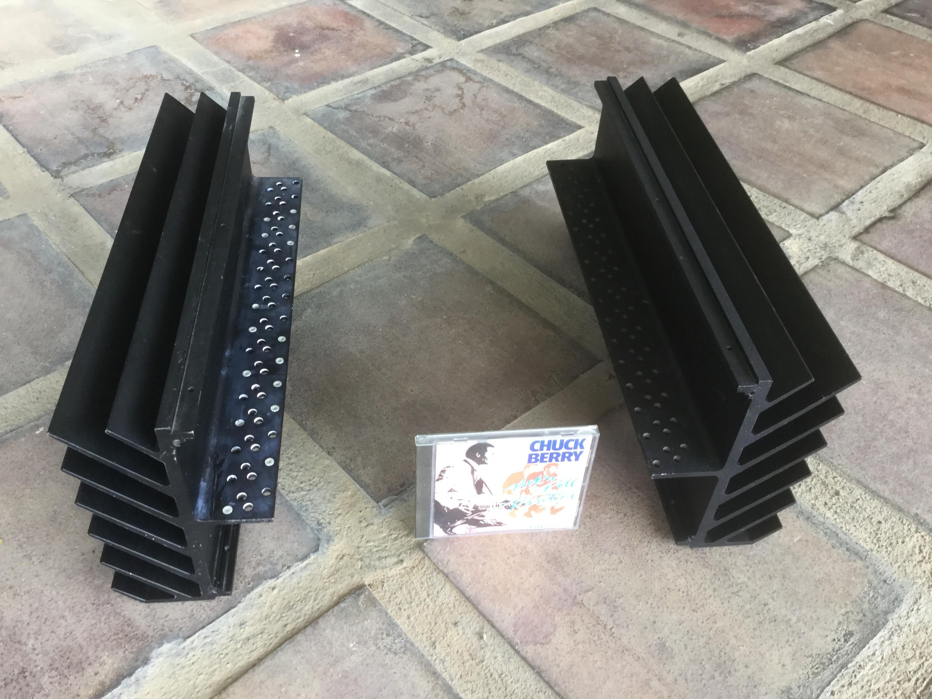

Funny, I like having the active devices bolted directly to the thick heat sink base.
Seems that it would conduct better. Either way works of course.
I’ll be using a flanged sink for a metal canned VFET amp though. The metal cans DO look cool lined up in the Sony, and I had these monster sinks with TO-3 holes. They've been sitting around for years, donated by np at the first Burning Amp. I was cleaning up after the show and found them on the floor halfway to the exit door Obviously someone realized that they couldn’t carry them all the way to their car! A couple of times I planned to mill off the flanges but luckily I didn’t. They’ll be the centerpiece of my system!
