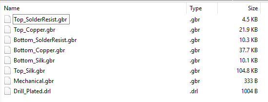

With the generous approval of Nelson, here you are,
the Gerber files of the PCB design in post #1286.
Patrick
Well! There's a project for the cnc engraver I just purchased...
If you open the zip file youself, you will find 8 files required for the PCB.
It is obvious what they are supposed to mean.
Feel free to change the files names to suit your PCB shop.
As they are, they suit the shops we have used without problems, ever.
