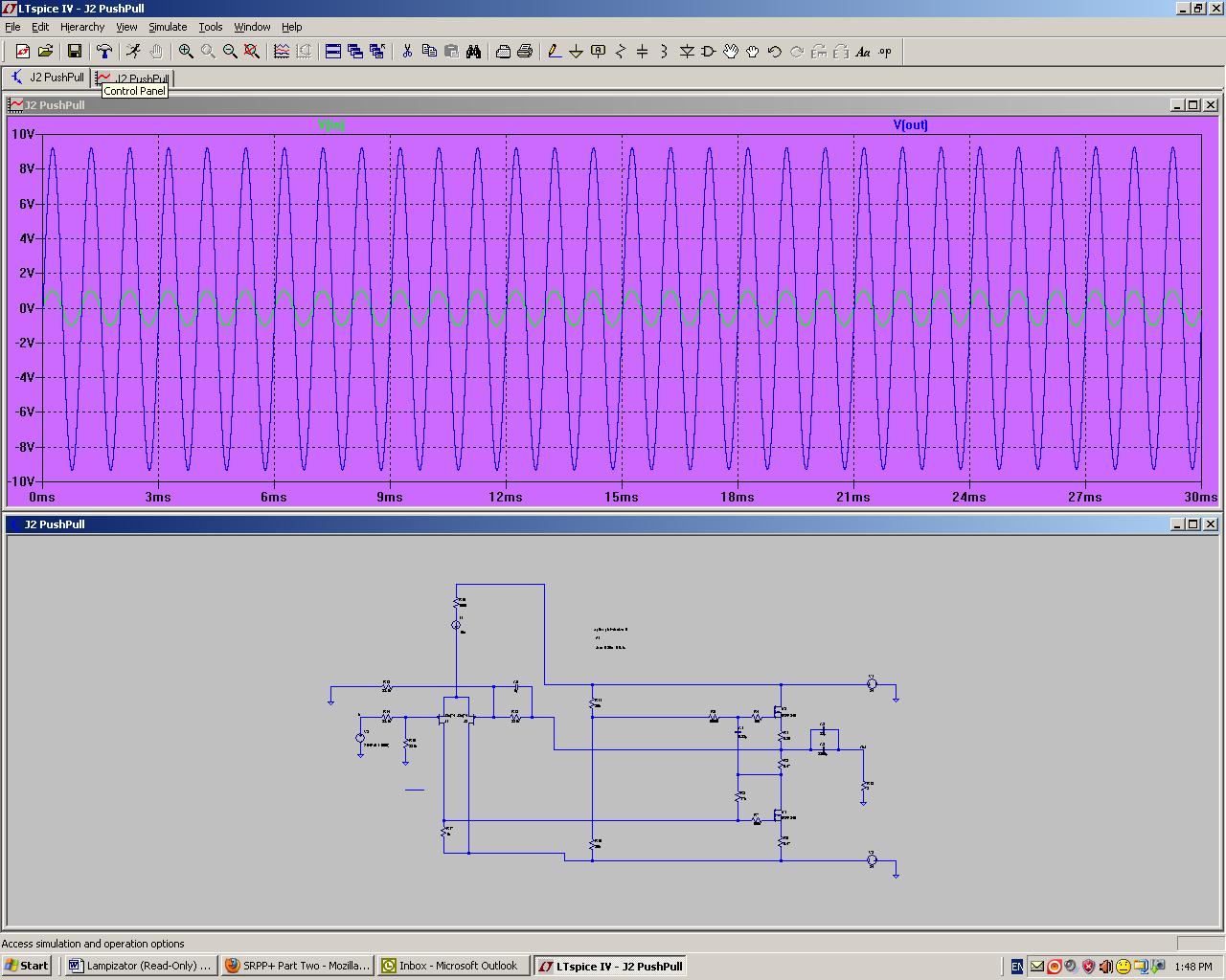

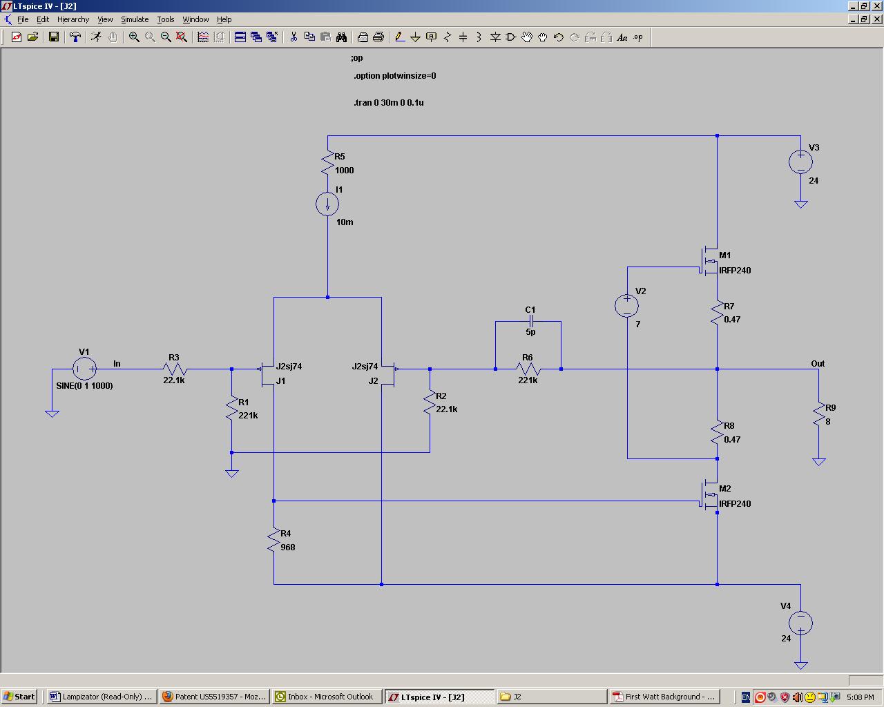

I have modded the circuit to make a 2 gainstage J2 push pull circuit (quasi-complementary of course), and it works.
I haven't tried to optimise it yet, and I have used Irfp240 because I don't have models of the SiC JFETS yet.

I need a microscope to read your LT SPICE circuit on my laptop!!!
Sorry about that.
Here is an update on it. The more I tried to optimize it the worse it got, so I have given up on it.
It works quite well with low output but once you get over 15V output it does not look to good.

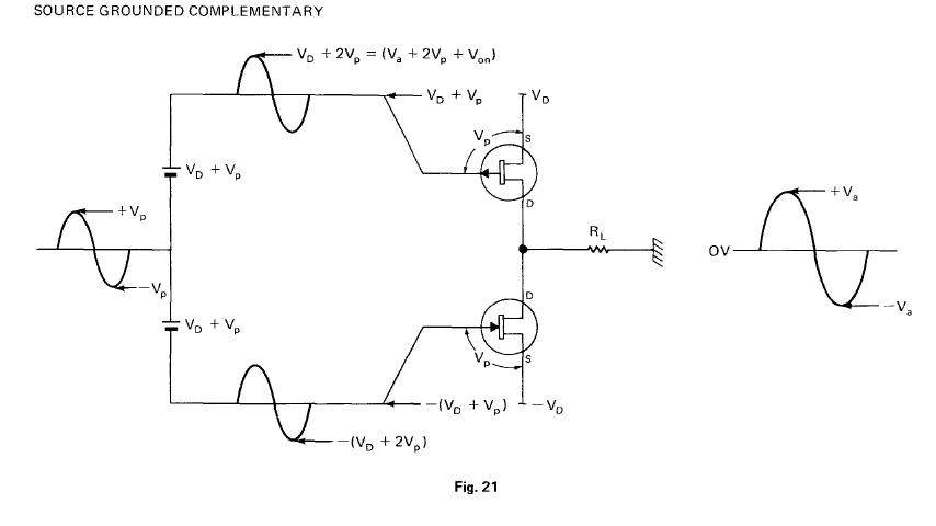

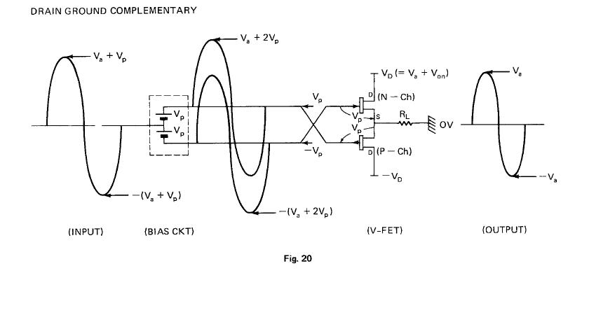

And these accidental improvements have resulted in only n-channel devices. I would like p-channels also, but realise for some of us that is not so important.
Please correct me if I am wrong: The so-called V-FETs I am talking about, the Sonys, NECs and Yamahas from the seventies, came before the power MOSFETs as we know them, from first the Hitachi HMA-9600 and the Hafler DH-200 by Borbely a little later (both second half of the seventies). After that the power MOSFET shoved the vertical JFET (V-FET) aside and into oblivion.
Interestingly, the old V-FETs are depletion mode, while the Semi South devices are enhancement mode.
