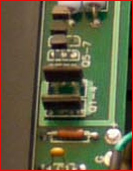

One must admit that it's more fun that we scratch our heads a bit, trying to solve a 6-legged puzzle. I think it has something to do with setting the bias voltages for the J-fets. First stage is similar to aleph J, except that the CCS is a J-fet. 2SJ109's are used for a differential, while two 2SK170's in parallel must serve as constant current source.
The mystery is the way the second stage, J-fet 'Mu follower', is biased, via 6-legged critter.
Personally, I would love to see the simplified J-2, something along the lines of F2-lite. Only one J-fet, light bulb as a CCS, and coupling caps, of course. :)
I believe so too that the 6-legged critter sets the voltage across the power resistors that provide the Class A bias current of the output Jfet. At the input, these are 2x 2SJ109s in parallel and 3x 2SK170s in parallel for CCS.:spin:
