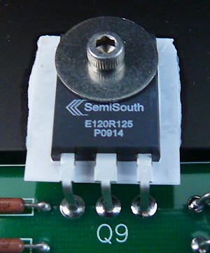

Hello guys! This is my first post, and I have no real technical understanding of amplifiers 😱
I just bought a used J2. The seller said it was "mint", and that he had only opened the box to check it and take photos.
But I took the lid off, and to me it looks suspicious, like as if the original JFETs have been replaced.
They all say SemiSouth E120R100, two of them also say T1026, and the last two say P0939 and T1034.
How bad is it?
if its SJEP120Rxxx it is OK
xxx is whatever - 063, 100, 125
no practical difference
that's "just" series resistance of part when fully opened and one can use any of these in J2 circuit, even mixed
edit: you're scammed ... amp is bad - just send it to OPLDF
:clown:
