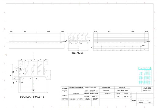

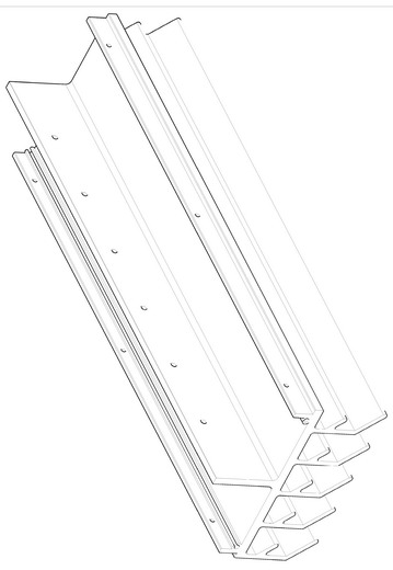

Just found heat sink CAD database layout in my HDD but there're no any link to factory 🙁
I can't remember it maybe I need to send this picture to everyone whom in my email list (over 1000)
