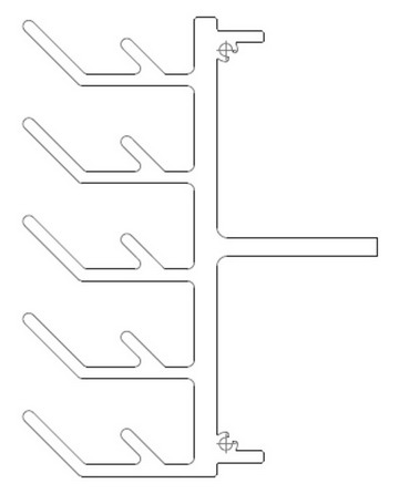

FW HS
I found this heatsink layout in Taiwan aluminium manufacture site.
I think it was duplicate from original First Watt surely, 6-7 months ago they've asked me for 75USD/ea.
Ahhh...Maybe I need find someone to make my chassis and face plate now 🙂

I did not see cloned FirstWatt chassis in any of the usual suspect web sites and forums during the last 12 months.
Nowadays Taiwan is a developed country. Also the democratic rule of presumed innocence should apply to everyone.
We can also take into account - as one possible option - that this Taiwan company makes them for the supplier of Nelson. It can be a copy or can be not. Either way is possible, and until someone prooves the case, I kindly like to suggest to not post accusations against people or whole nations.
No accusation, but my understanding was that Nelson had this extrusion made. Could be wrong. I think it is important to remember that you would not have the J2 or possibly this extrusion, or even this section of the forum, without Nelson. I try to guard against taking advantage of that in anyway. Not saying anyone is doing so, just saying.
