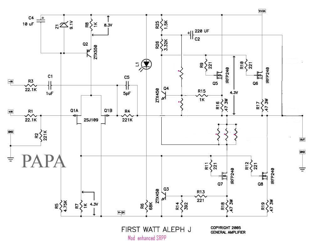

The simplified schematic of J2 what I suppose to be.
Here is the simplified schematic of Firstwatt J2 that published in the owner's manual of J2.
It says the output stage current source is no longer an "Aleph" current source, but a version of the classic "Mu Follower".
But the simplified schematic of Firstwatt J2 shown just a basic circuit of SRPP(Shunt Regulate Push-Pull).
Since it claimed to be a Mu Follower,
I suppose the simplified schematic of Firstwatt J2 should be just like this.
At first, I guest the regulator IC in the schematic is TL431.
Then the voltage drop of those two resistors will be 2.5V, it seems too high.
So, I guest the regulator IC in the schematic is LM385.
But, if it followed the spirit of "Simple is the best",
It maybe just a BJT MPSA18.

It is the lower half that drives - antiphase- the upper one.The voltage developped across the lower resistor only has to be taken into account for modulating the voltage source.
Seems to me.

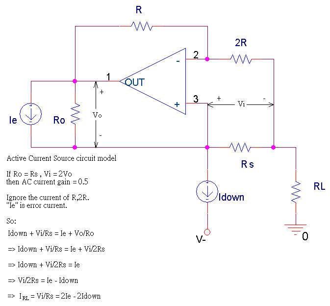

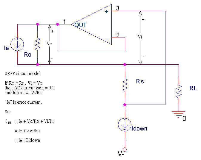

Compare the SRPP(Mu Follower) and the "Aleph" current source,
They have the same conception with different methods.

When looking closer, it seems that your enhanced Mosfet SRPP is very close to the aleph, which was anterior, the main difference being the sensing resistor position.
Or i missed something?
The concept of SRPP is long long ago, and of cause my enhanced Mosfet SRPP is later than Mr. Pass's Active Current Source.
The difference?
The Active Current Source has positive feedback (bootstrap,regenerate) obviously, the SRPP dosen't.
That a difference.
The Active Current Source of Mr. Pass separates AC and DC siginals.
If you analyze the low frequence response of the Aleph 5 Amp and its Active Current Source, you will find the low frequence limit of the Aleph 5 Amp is much lower than its Active Current Source's.
My SRPP doesn't separate AC and DC siginals.
That's another difference.
