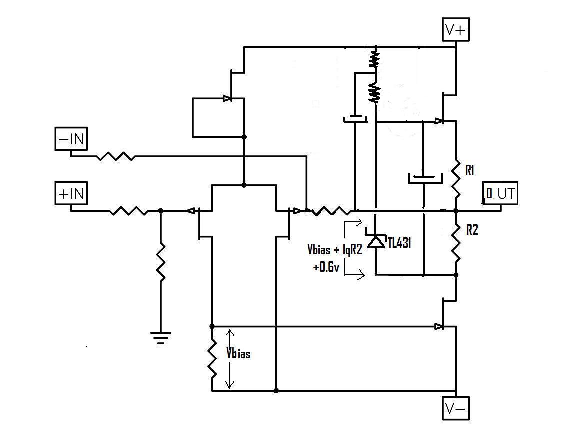

I think, we don't need the npn transistor. Just put a good capacitor across the 6 critter. And if someone would see the need of an npn: build a current source to have constant current through the 6 cretter, because he loves it...
Do you mean this.
No exactly. No bootstrapping, ony one resistor to positive voltage (from Zehner) or alternatively, I could imagine a current source connected to the zehner, no resistor. In this case we may get better results.
I wouldn't do any bootstrapping - what should be the benefit. Bootstrapping creates a higher voltage for the driver. A simple current source would keep the current through the 6-critter constant. Therefore, voltage is stabilized.
I think, replacing the 6-critter by selected leds could be cool....

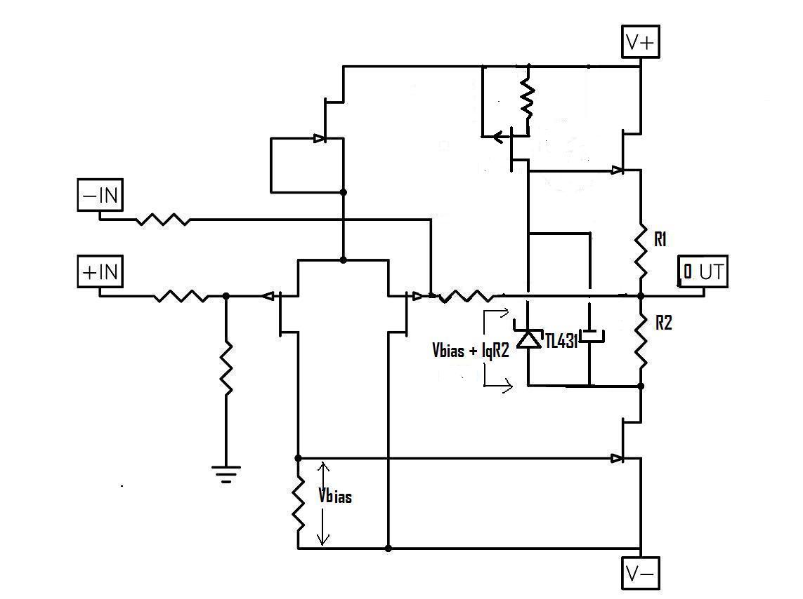

Something like:A current source would also insulate against voltage variations... ;-)
I guess, that's it. Now there are only a few open points: Do we need compensation against thermal runaway? Temperature behaviour of the J-Fets??? Values for R1, R2...
Looking forward to hear Nelsons comments... We all have to buy J2 amps to suck out the secret...
Maybe we should have a current limiter to protect the most expensive silicons ever... ;-)

I wonder if tweaking for the sweet spot will buy more than eliminating the current limiting circuitry. After all, First Watt doesn't seem to have a hard time selling their amps despite having the circuitry built in.
I think, we don't need the npn transistor....
I fear the zenner current to be perturbated by the output gate one.
nope ;
that's jfet , remember 😉
put 5mA through bias string and you're good for several gates
