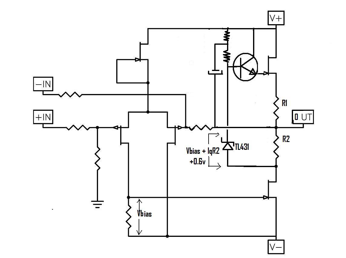

Still thinking about how J2 output works.
...one difference with aleph j is that te voltage across the sensing resistor is phase opposite. I guess there is to reverse this phase before being able to trive the upper power Jfet.
Mhmmmm... So the ALEPH was papas first child. The J2 is the simpler is better approach... Maybe we'll see that the aleph current source will be replaced with a j2 like output... Maybe Nelson explains the benefit of th Aleph compared with the j2 arrangement...
Jfets and Mosfets are different beasts ;
they have somewhat
different transfer characteristics , along with different range/scale of Ugs ..... so SRPP/Mu Follower is more adequate for Jfets , than mosfets
they have somewhat
Do you mean J2 cannot work with mosfets?
It could have been an exiting exercice to try.

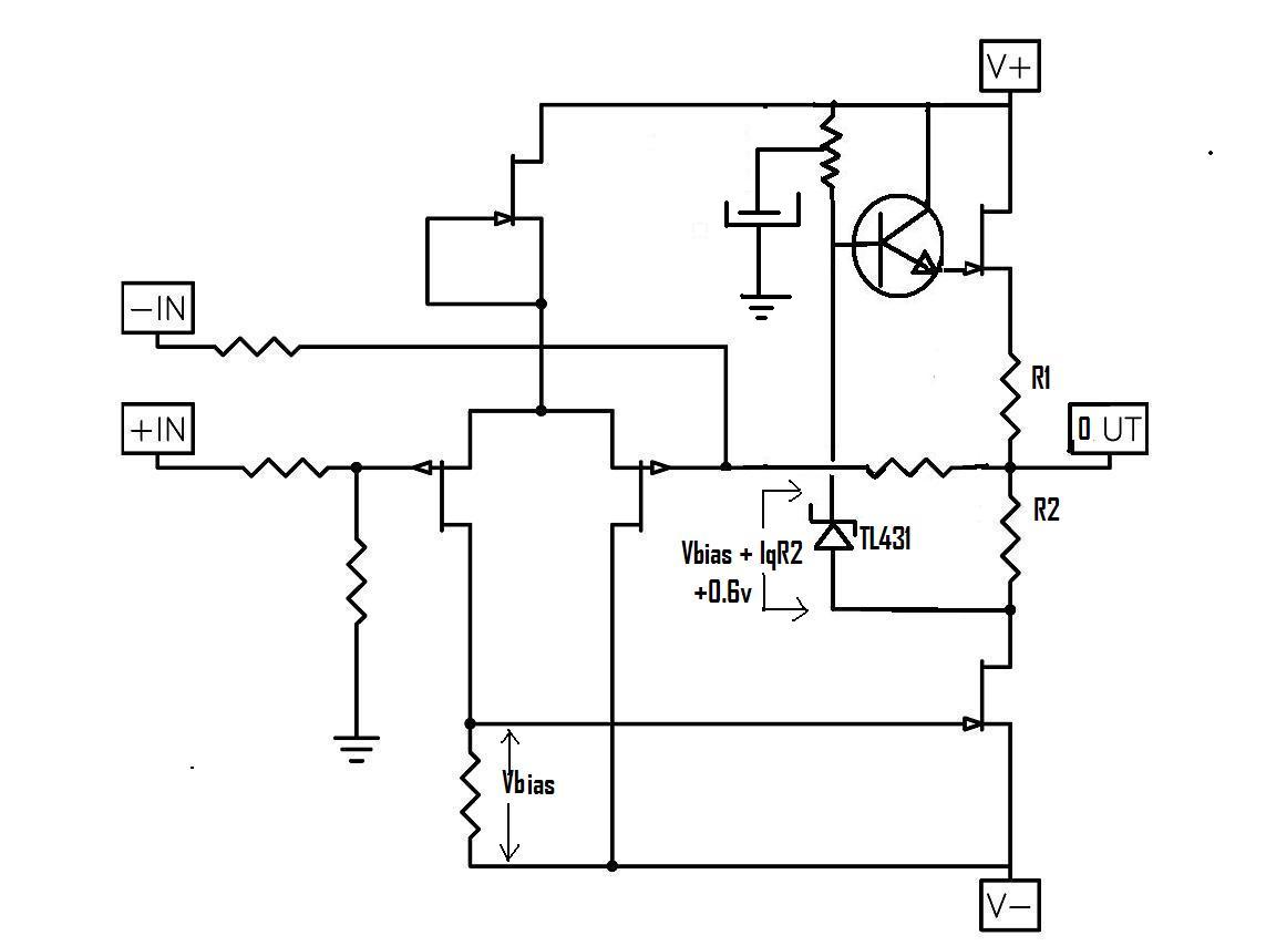

I believe Nelson mentioned the can drop into an N-Channel MOSFET place and get improved distortion figures. I assume some tweaking of the gate and source resistors is needed to optimize. I will let the big guns speak to this...
I have built the J2 with Mosfets. The nature of the biasing
results in more open loop gain (more feedback) , and the
distortion is higher. That's where I got those comparative
numbers.

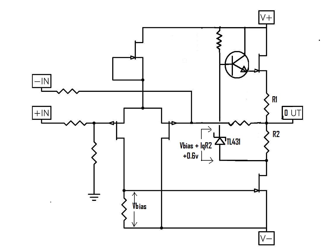

Is this better
certainly is 😉
but look - Papa is lately pretty generous , especially when Holidays are near ...
he'll reveal J2 schematic much before 100 pcs are sold ....... or - in worst case - they'll be sold in next 10 days , and you'll see schematic ;
