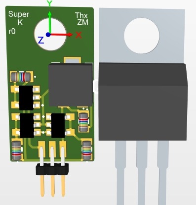

I have j310 smd and not 113, actually I have a few types of jfets but all are smd. mmbf5486, j310, 2sk2145, 2sk209, bf862.
What is the difference if you use a highly degenenerated high idss jfet in a ccs vs a low idss not degenered one?
With a few(2-3pcs) paralleled and degenerated 2145bl I could get easily to 10ma if there is no difference between degeneration and no degeneration in a ccs like here.
It happens that recently I took ZM idea of paralleling multiple 2145 and put it on an aluminum pcb, though I didn’t order yet the pcb. It has k170 pinout and to220 size.
If high degeneration is desirable in a jfet ccs means that this design could work here also, thing that I will try in my j2.

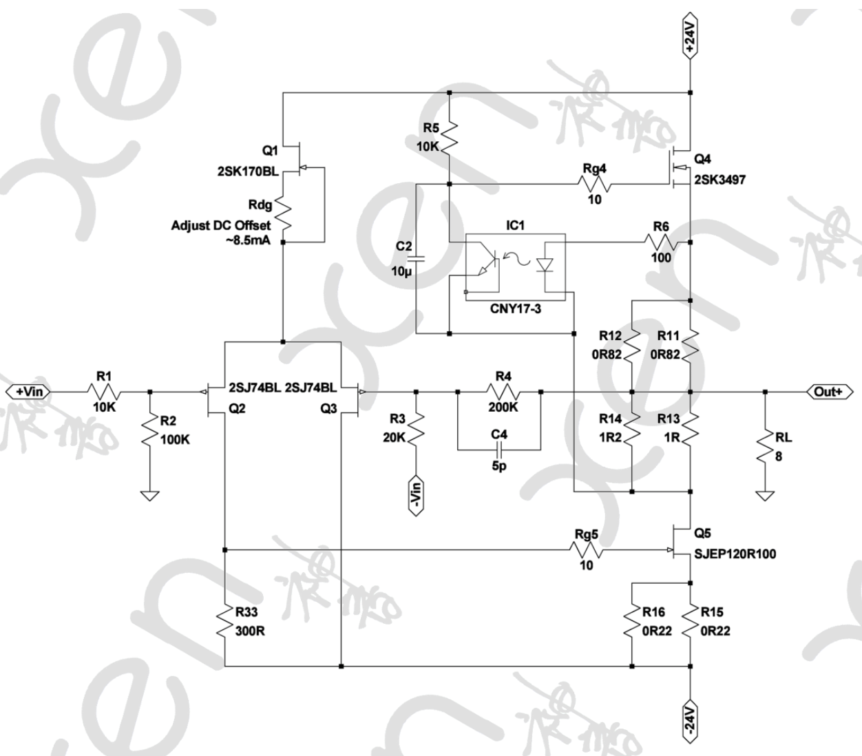

IF you use the amplifier with single ended input, i.e. -Vin = 0V, then R3 should be 10k, R4 should be 100k.
IF however you are using symmetrical inputs, i.e. -Vin = -(+Vin), then those value as published will load the source symmetrically.
You can figure this out by running the Spice files published before, and look at current amplitudes through R1 and R3.
Those spice files are using symmetrical inputs, as I would.
If I use symmetrical XLR inputs (with the original values for R3 and R4 below), can I still use the single-ended RCA inputs by using a jumper between pins 1 and 3 of the XLR connector as stated in the J2 owner manual?

And since I still do not have the parts with me, I shall use EUVL Spice file and play with values.
Speaking of which, if I replace Q4 with a IRFP240 or add parallel Q1-Q2-Q3 in the front end, should I consider changing any other value in the EUVL schematic above?
