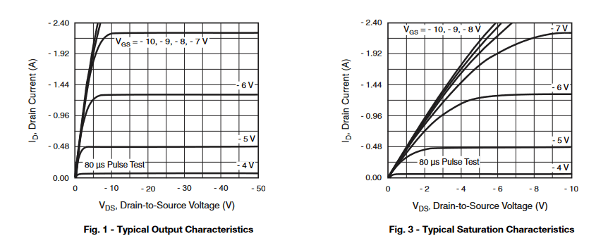

almost 2€ for a 1W device... do you have a cheaper alternative?try with TP2640
got a pair kindly donated by Papa...
trying to get the best result for a small budget
I have already heat sinks and PSU toroids
in that case - just use what is most convenient for you, from whatever reason
in most cases, for still active parts - price of part is still much smaller than shipping involved
and you always need plenty of luck to get everything what you need from one Vendor, so shipping cost is diminished
so, 2E per part is ridiculously low, possibility and expenses to get it is much trickier part
I know - when going cheapskate route ( done that more than enough times) everything counts but - worth thinking about real value of project started - if all is needed to bring it to significantly higher level, then just prolong it ...... more time, lesser strain on brain and wallet

the 2x TP2640 have to be matched, so need to buy at least 50 pieces to find 2 matched pairs? meaning 65€ at tme.eu
or go to F8 topology to avoid the matched pair but I dont know if F8 with mosfet input could work?!
