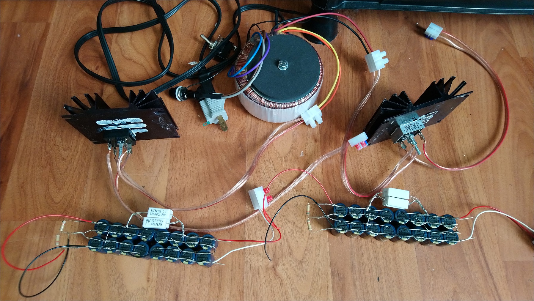

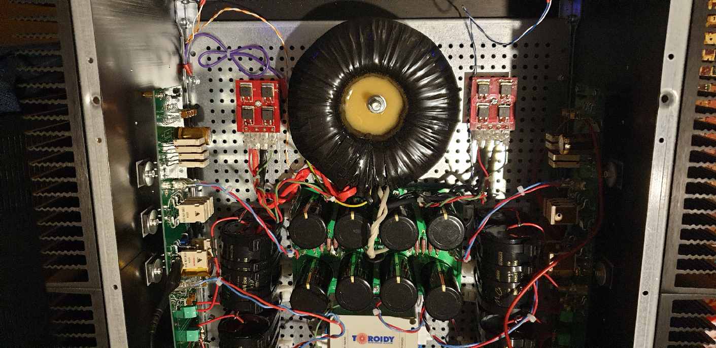

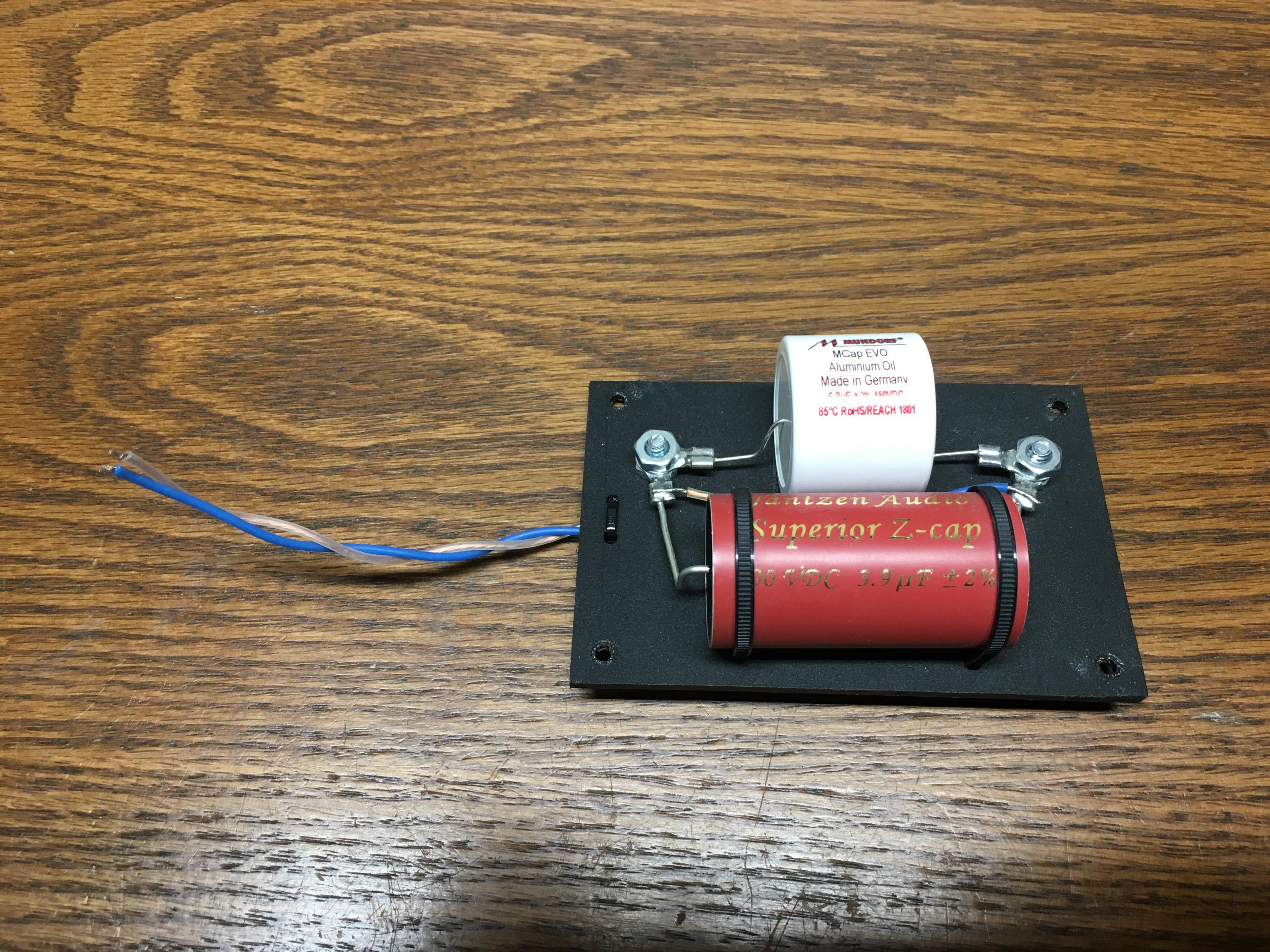

If it is helpful here is a picture of how I mounted some larger input capacitors on my F2J. The base is just a piece of plastic (high density polyethelyne?) from my local home improvement store. When using the F1 with a single ended input I wonder if the quality of the capacitors on the side that is tied to ground matters? Maybe that would be a way to save some space as well?
I might be getting in over my head on this, but with the negative side of the input tied to ground for single ended operation, the input coupling capacitor will have only DC voltage across it making it essentially an open circuit, so I suspect that a smaller, less expensive part would not impact the performance. Maybe the input coupling capacitor could be left out of the grounded side entirely? Is there another purpose for this capacitor that I am overlooking?
I am no expert, but I would use exactly the same capacitor in both sides. Speaker will receive exactly the difference, so both sides should be identical.
Omitting that cap could lead to DC problems.

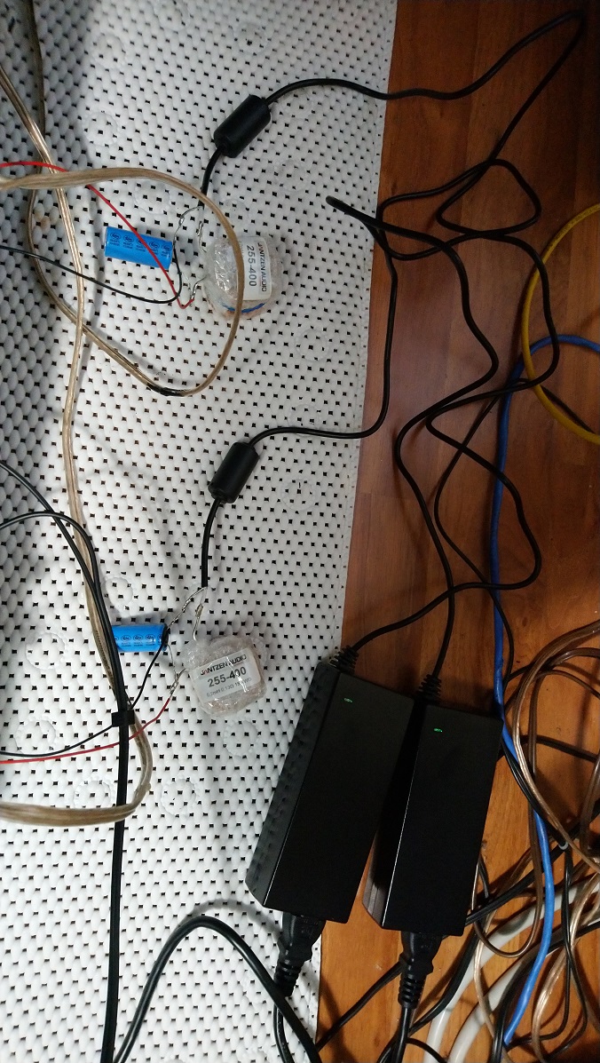

On other note, I tried 19V/4.5A switching power supply, one each per channel, with F1J and it works great. I like that it does not heat up so much, its not heavy, and if liar-in-chief get reelected, I can use it in europe without any changes

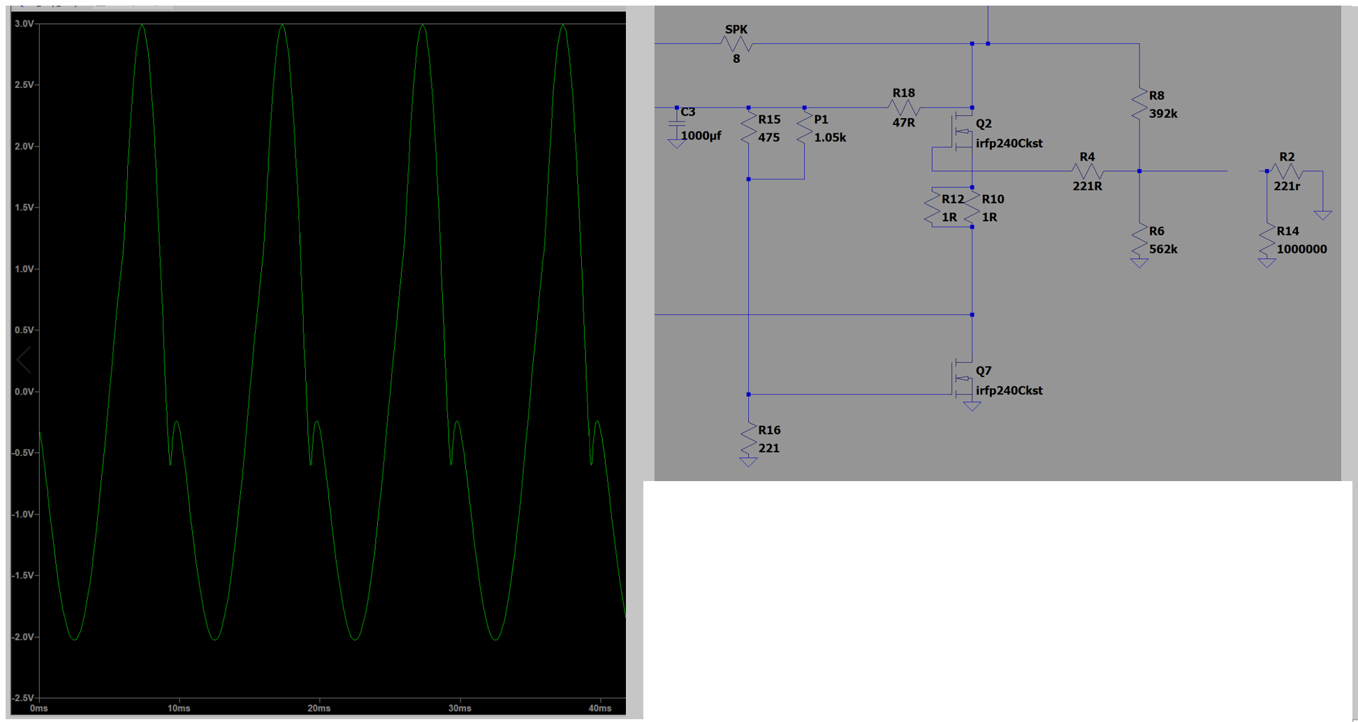

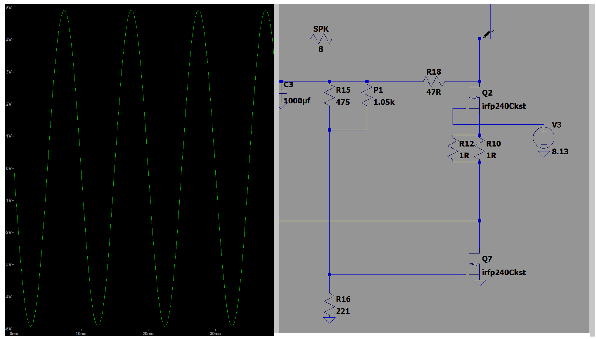

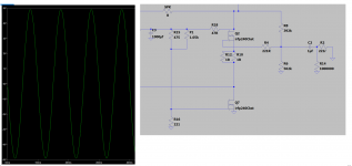

I did a little simulation of the F1 circuit configured for a single ended input in ltspice and my comment about the input capacitor (C2) on the grounded side having only DC voltage on both sides was wrong. There is AC at the junction of R6 and R8, and in the simulation this AC voltage is greatly reduced by giving it a low impedance path to ground through C2. If C2 is removed the AC voltage at this junction is much higher and the amp doesn't work. So don't remove C2.
The image F1 With C2 SE Input shows the voltage across the output with C2 in place and the negative input grounded (standard SE input configuration)
The image F1 C2 Removed shows the voltage across the output with C2 removed. Not pretty.
The image F1 Voltage Supply Q2 Gate replaces all of the negative side input components and the R6-R8 leg with an ideal constant voltage supply to the gate of Q2. This seems to work, although I'm not sure how much value is in the idea. Maybe it could save space, and cost if expensive input capacitors were being used.

I agree, and after seeing that current is flowing through C2 in the simulation, I would also recommend using the same type/quality of capacitor on both the positive and negative inputs. Sorry I forgot to include this in the last post.

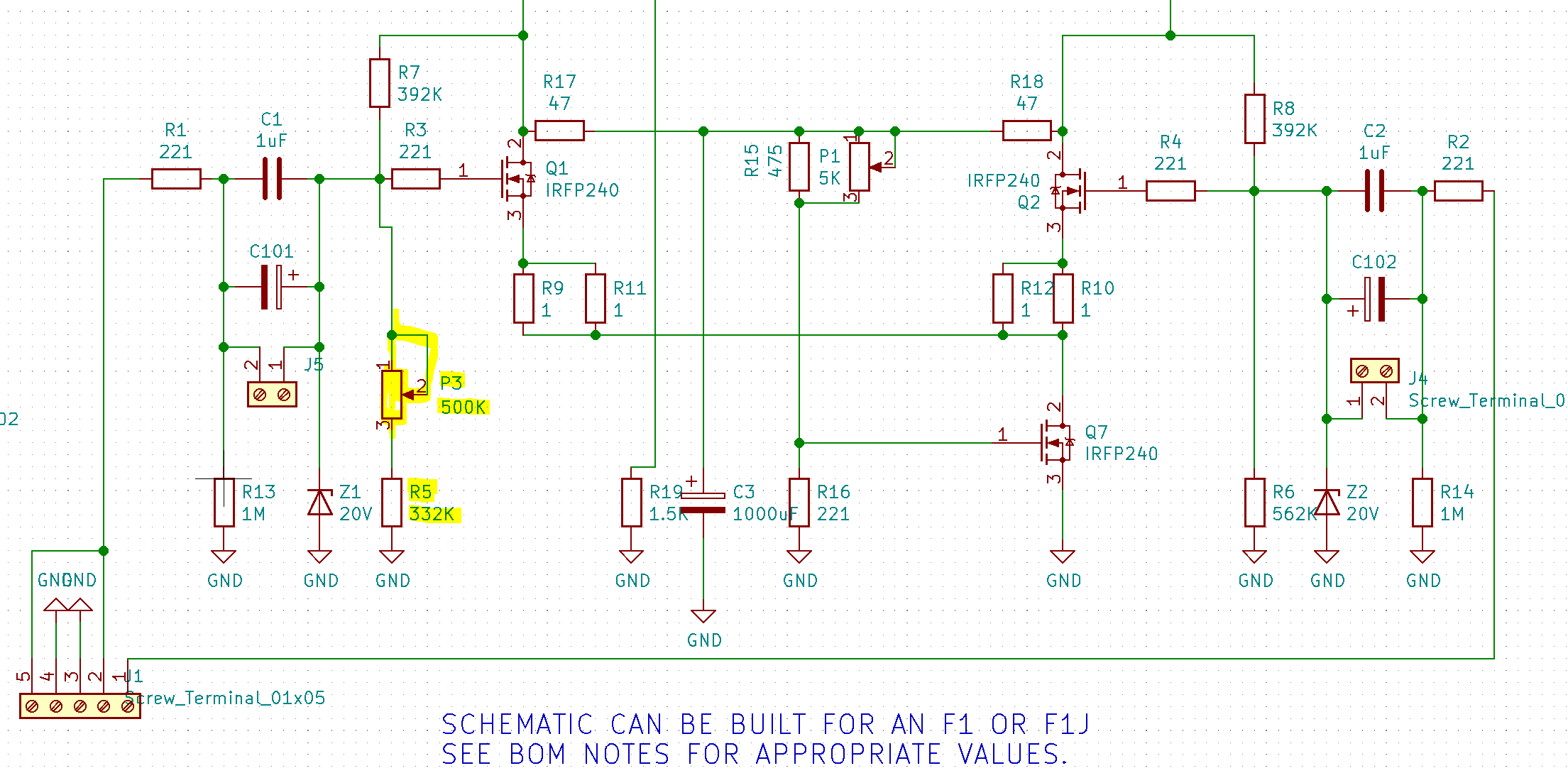

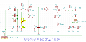

I am trying to refine the F1/F1J circuit boards before placing a second order, and also pull together different pieces of information to establish a setup procedure for the amp. One of the refinements I would like to make is to add a potentiometer for adjusting the DC offset. From what I gather the following would be the preferred approach for selecting transistors and adjusting the DC offset:
- Q1 and Q2 matched for Vgs (equal Vgs creates equal Id) and transconductance (source ZM)
- Q3 and Q4 matched if you can (F1 Service Manual suggests matched)
- Q5 and Q6 matching not required
Power up amp without anything on the input or output.
Adjust P1 to achieve ~13.8 VDC at the speaker outputs
Check DC offset at speaker outputs for gross offset.
Adjust gross DC offset by adding resistance in parallel with R27/R29 or R28/R30 (adjusting here first will maintain Vgs at Q1/Q2 as close to equal as possible, also suggested in the F1 Service Manual)
Recheck VDC overall level at speaker at speaker outputs and adjust P1 for 13.8VDC.
Bring amp up to temperature and recheck DC offset. Fine tune DC offset using P3 (proposed DC offset fine tuning potentiometer that is in series with R5. (Adjustment in this location is suggested in the F1 to F1J conversion schematic from First Watt).
The schematic below shows where I was thinking of adding potentiometer P3, and some resistance values (for an F1 in this case) that would allow Q1 gate voltage to be higher or lower than Q2 for adjustment of DC offset in either direction.
Please let me know what you think.
Thanks again,
Chas

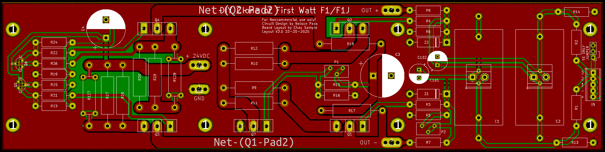

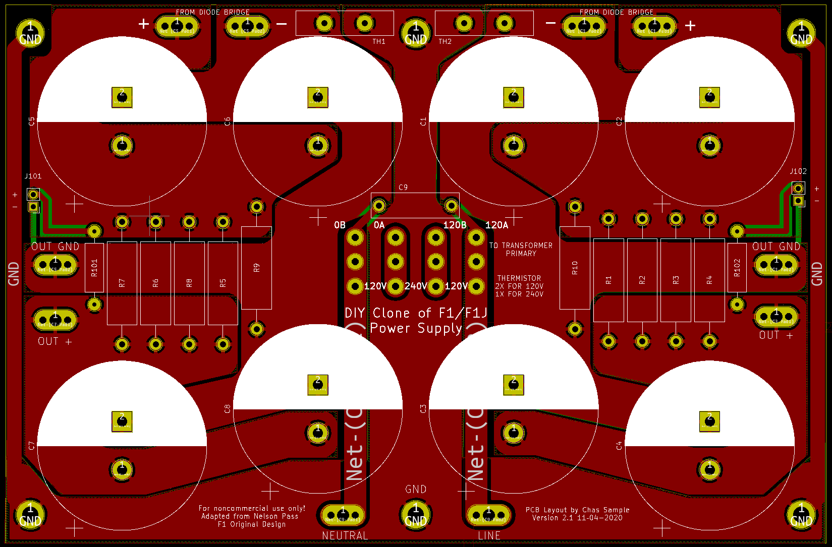

Updates to the boards for a second order are nearly complete. I have made minor tweaks based on my build and comments from adason.
Changes of note to the amp boards are:
- added a hole for wiring direct to the pads for power input and speaker output
- added P3 (a potentiometer in series with R5 to fine tuning DC offset)
- removed R105 and R106 (replaced by P3)
- added a second set of holes for using smaller resistors in parallel to create R127 and R128 for more DC offset tuning options
- decreased width of the thermal reliefs for easier soldering
- increased revision to 3.6
Changes of note to the power supply board are:
- added additional center mounting for increased support when pushing on connectors
- added a hole for wiring direct to the input/output pads
- increased revision to 2.1
Does anyone who has a set of boards have other suggestions?

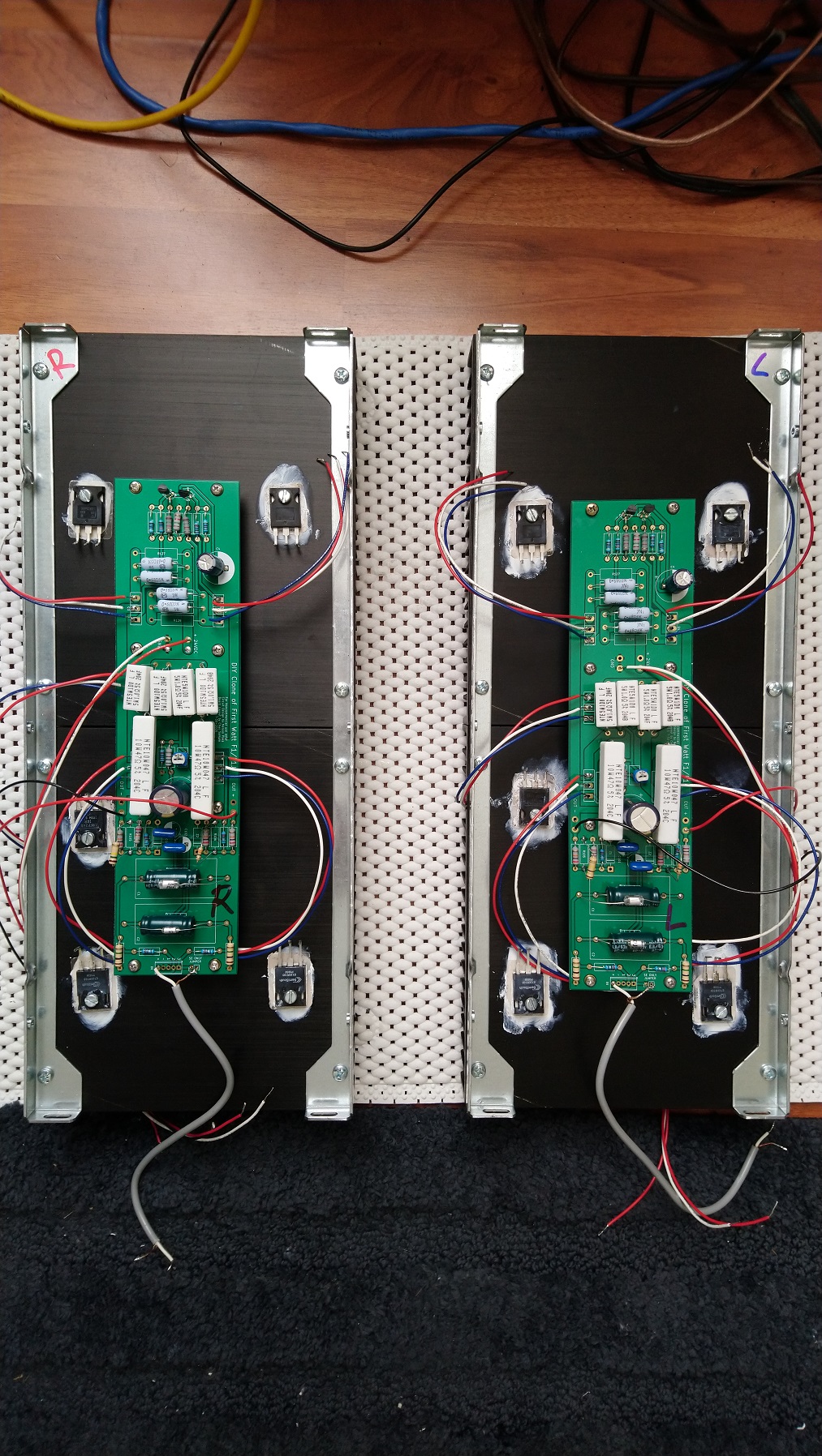

I have your previous boards they are hard to fault.Have jus finished my f1j build with these boards best sound i have ever heard from lowthers have the correction filters fitted .Here are a few pictures build not as tidy as yours and my fabrication skills are not great but the boards you supplied made the job a lot easier..So thanks a lot to you and Nelson Pass for sharing his designs .
