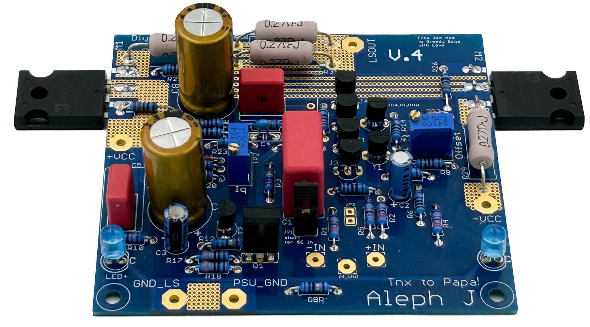

Has this Aleph J version been built with the alternate smt MMBFJ270 JFET's and compared to being built with the Toshiba J74's?

Best to wait his reply, but as far as I remember his reaction - difference wasn't night and day
in fact, from my previous endeavors with J271 in place of 2SJ74, that old one was not slouch at all ....... and this one ( presented) is made with more mileage than old one
that's why you can read on schematic in first post:
"JFets arrangement:
case 1: J1,J2 - 2SJ74BL or V/LSJ74B or C
case 2: J1,J2,J3,J4 - 2SJ74/LSJ74 any suffix or
J270/271
case 3: J1',J2',J3',J4' - mmbfj270/271
all matched"
so, pair of 2SJ74BL as regular option
quad of any suffix 2SJ74 for those filthy rich Greedy Boyz
quad or J270/271 - double, to compensate lesser xconductance of cheapo ones; sorta diminishing stock parts
quad of mmbfj270/271, again - double, same reasons, regularly available part

AJ a la ZM ... or AJzm. No one has missed anything. They will be in the store... soon... ish.
Let's not get ahead of ourselves. ZM, no more teasing the Greedy Boyz... 🙂 🙂 All will be posted in good time and in one place.
It's always fun when people may enjoy a new project...
The long story...
Those that have built or seen the schematics for ZMs iteration of the Aleph J know it well. See @poseidonsvoice post above to know what boards we're talking about. From a novice (my) perspective it was / is wonderful because it didn't require matched output devices and it was (to me) a bit simpler to build and set up than the existing Aleph J boards. Most importantly, as we all know... EVERYONE should build an Aleph. So, how could we make building an Aleph even more approachable...?
ZM to the rescue... again.
It was painfully clear to me while I was working on the Iron Pre that the world's supply of K170 and J74 devices is fixed. We're insanely lucky to be able to get them, but they won't last forever; and yes, Virginia, there are alternatives. Also... we all know that through-hole is on the decline. So, rather than put a design out that was only tested with the famous J74's ... I asked ZM about other alternatives. In his kindness and infinite wisdom, he created at least 4 board designs for alternatives. I ordered a bunch and was lucky enough to learn how to test them under his guidance to make sure they performed to his expectations even in the hands of the average dodo (me).
I tested all but the SMD versions very thoroughly with a variety of components in various configurations. We even did some surgery on a few. After I asked a typical dodo question, we agreed to make one set of "flexible" boards vs. having different boards for different JFETs . He's devilish and already knew it would work ...
ZM is a very patient teacher... I may have had a few moments of
Get to the point you cry!!!...
Fine...
So... the "store" boards will be suitable for (as ZM mentioned above)...
The kits will include all the parts to stuff the PCBs (with matched quads of J270s).
Soon... ish... kits to build a couple of these boards will be in the store.
I think it sounds just swell in all configurations. Again, this is DIY... it's fun... and YMMV. I'll post some giggly wigglies for the final iteration when I get them done.
Also @birdbox is too modest... he was a huuuuuge help.
Papa, ZM, and 6L6...
- A matched pair of J74
- A matched quad of J74 for those with some around or $$$
- A matched quad of J270/J271
- A matched quad of mmbfj270/271. Choose your own adventure. For advanced DIYers willing to go it alone.
