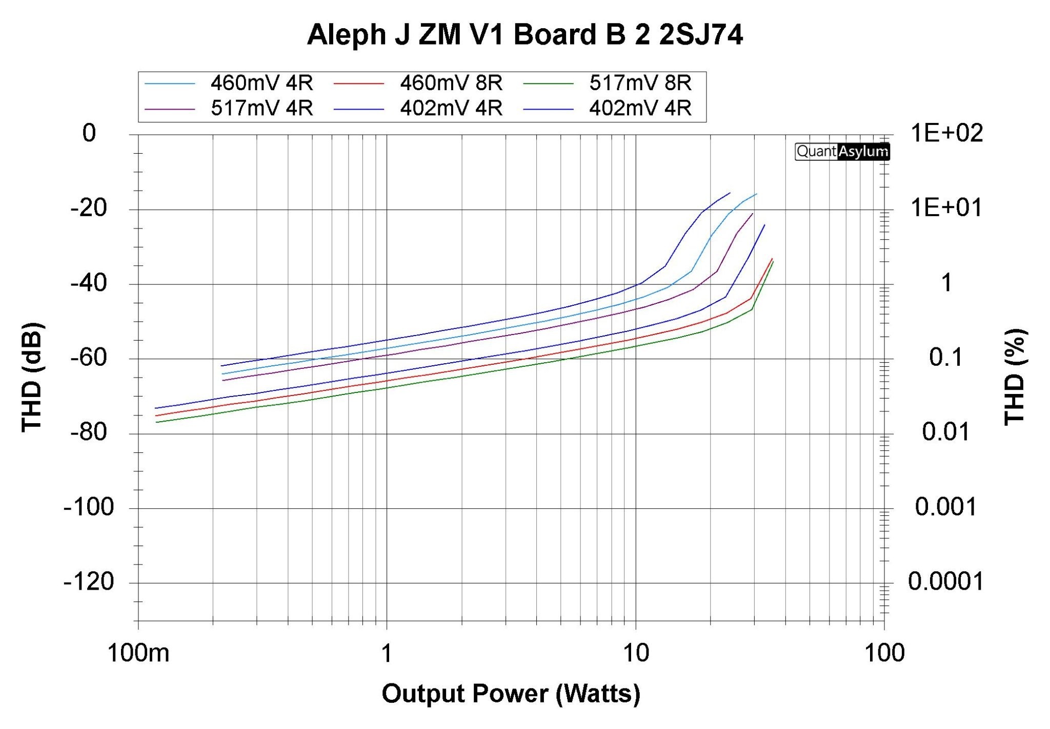

I tested it along the way
funny giggles you made while playing:
