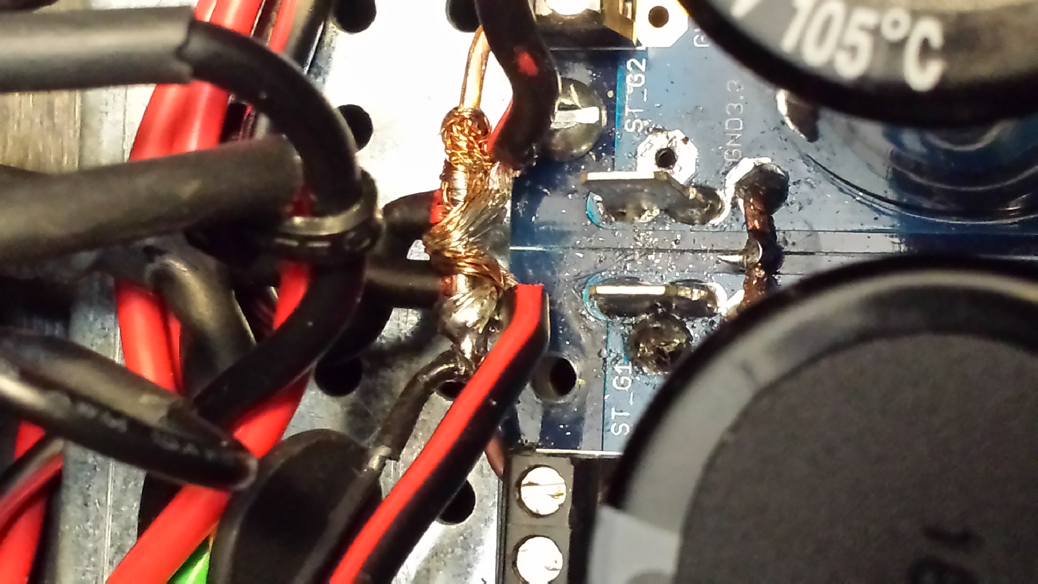

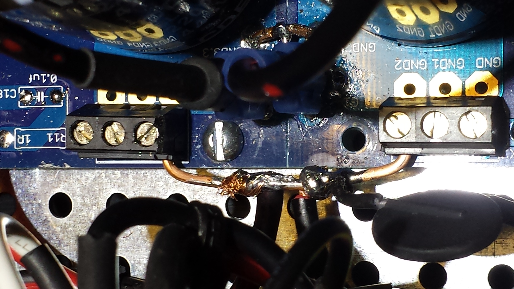

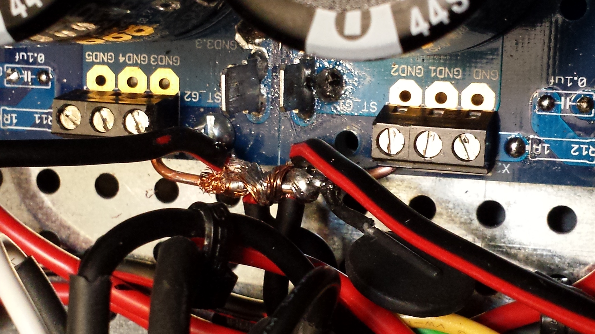

Ok ,I understand that now. Not familiar with the electronics ways,if that makes sense ,in amplifier/psu design. I have had the trans connected at the in stage from the start the rest as to the build guide and i know may not apply to my center tap transformer. To bad there wasn' t a way to use the blocks in the center. I will dig up some wire . Thanks for everything so far...
Can the two GRD's from the speakers stay on the quick connects ,there are joint with a copper wire?
It's one or the other, but all grounds to one point.
You can try connecting the other grounds to the centre quick connectors instead so that in effect, all your grounds are more or less at one point and half way between the positive and negative grounds.
Transformer centre tap remains at input ground.
As I said, grounds at one place. So the speaker grounds to the tabs should go to the "T" wire instead.
Or as I mentioned in my previous post, alternatively all grounds to the quick connect tabs.
Remove the speaker blacks from the amp boards and connect to the PSU T. It's worth a try.
Done,no change.🙁
Most frustrating.

It is still the same. The speakers are Elsinore's about 91db approx . I can hear it . I have two other 30 yr old amps that are silent on same speakers. Twisted wires as much as possible.I have rotated and done back to front removed it and put a tin over top a foot away on table. Thanks for all your help maybe try moving psu away to see if that does anything.
