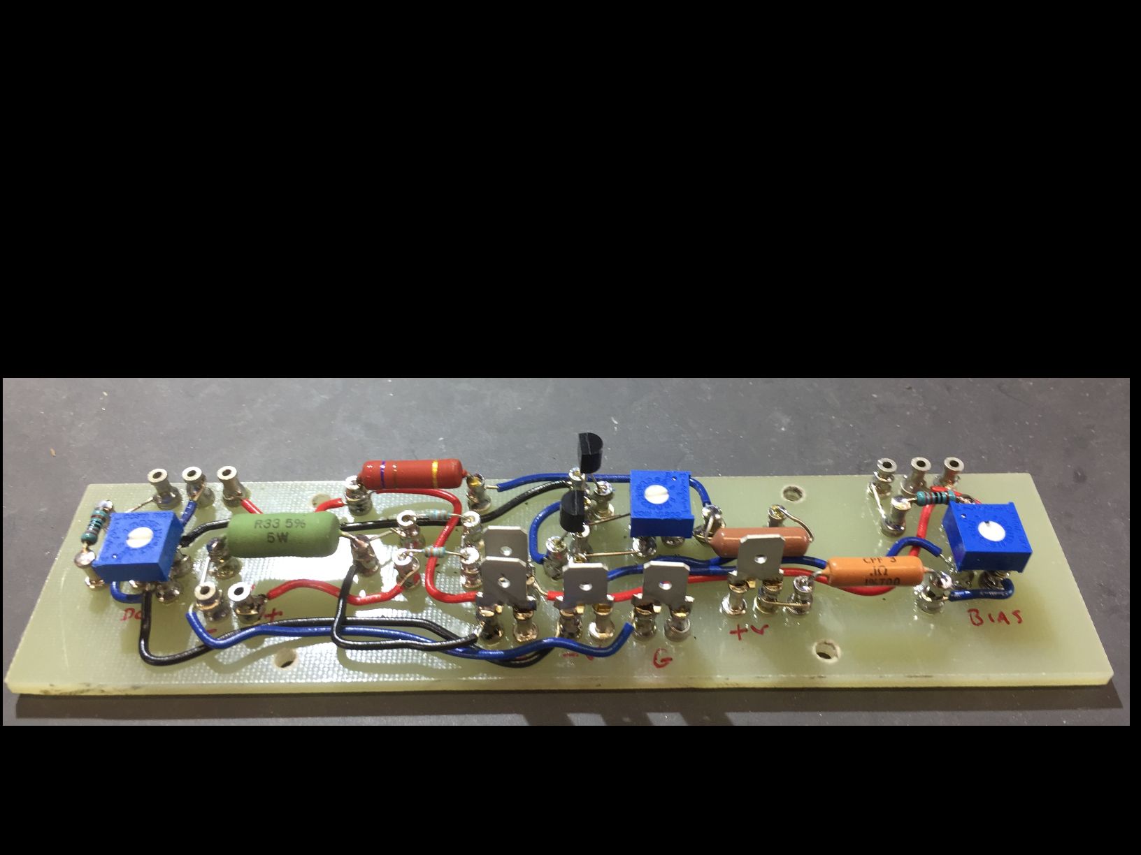

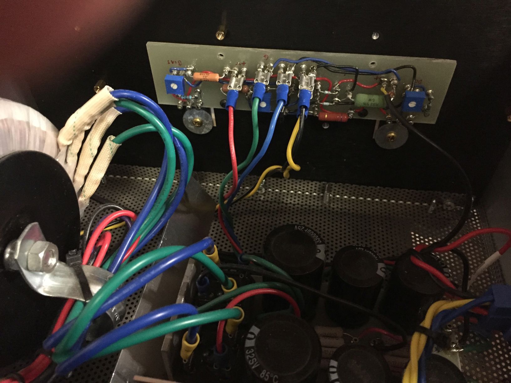

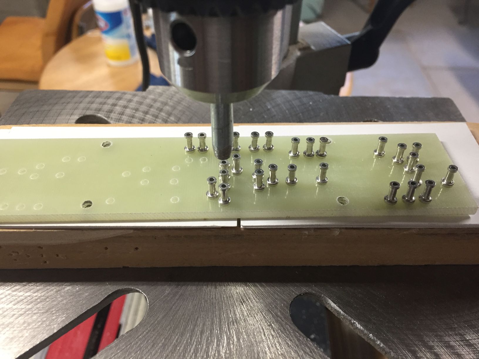

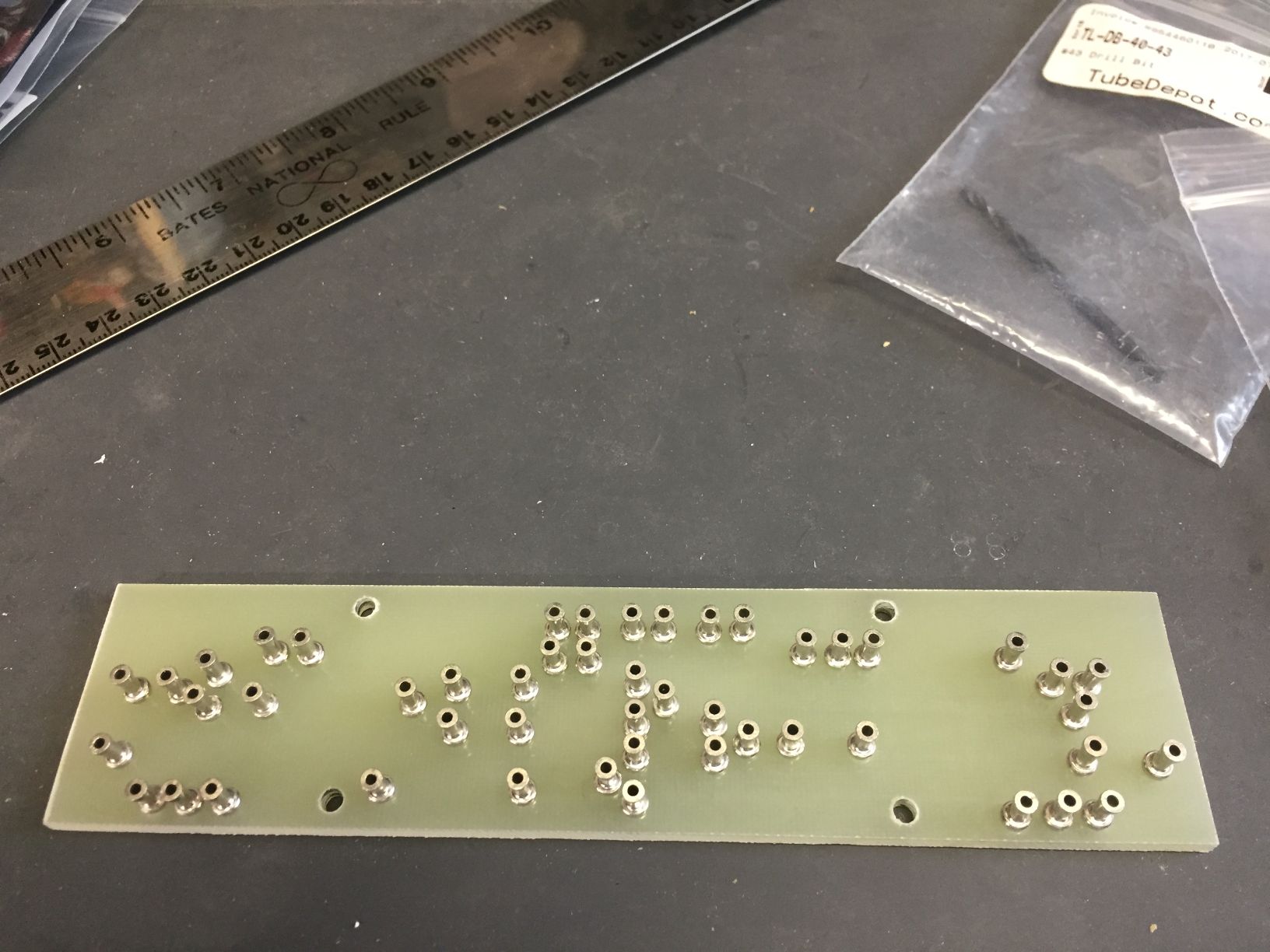

Finally got around to building an F7. Modeled the circuit in LTSpice to make sure it would work. Laid out a schematic and PCB in KiCad and used it to create a drilling template for some old-school G10/turret post boards. I bought some ECX10N20-S and ECX10P20-S lateral mosfets from Profusion in the UK and a matched quad set of LSK170/LSJ74 Jfets from the DIYaudio store. Built the boards to match the mounting layout in a M2x amp I had built.
It all went very well. Bias and DC offset are VERY interactive. Still playing with the Balance pot, trying to use my scope to set it up but thinking there may be a better way. Running about 0.12 volts drop across the 0.1 ohm resistor which yields a conservative 55 degrees C at the transistor body. Amp already sounds very good, very detailed, very different from my F6 as well as very different from my M2x. Well worth the effort so far. I'll try pushing the bias up a bit after I break it in some more. Balance seems to affect the imaging, so I can see that will be critical as well.
Many thanks to Papa for this fascinating PCF amplifier design!

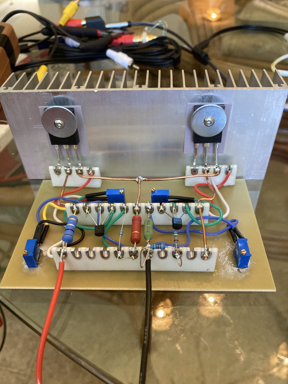

Another F7 imitation breadboard
Here is my attempt at a breadboard version - strictly for playing around with values, etc. I used 15-turn pots which makes it easier to dial in bias and offset. The heatsink is only good for about 10 watts or so, but as I said - this is just a test lashup.
I used another old school technique - Tektronix style ceramic-silver strips. :)
