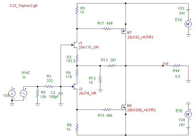

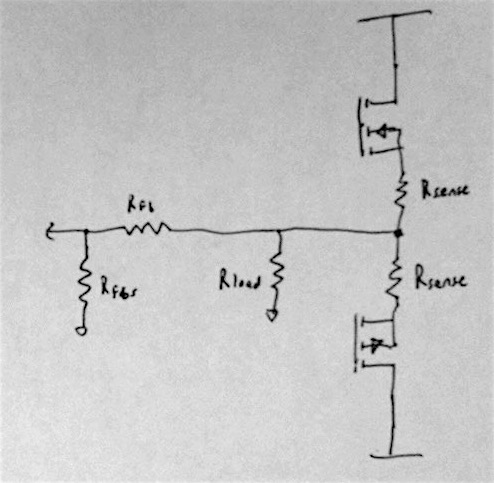

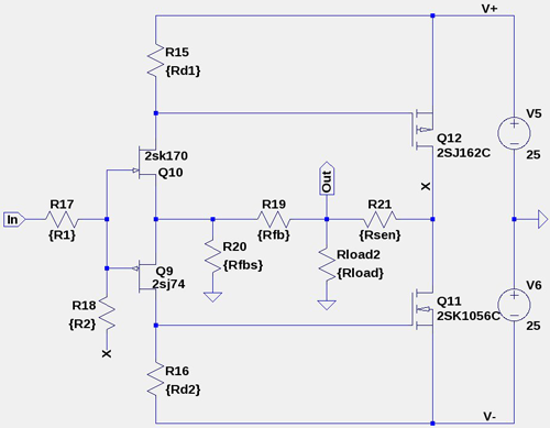

ha ! - no, I'm not allergic to heatsinks. But I was looking at the F7 concept schematic on 6 moons and was seeing something that looked like the common or garden Class B amp. The positive feedback sense resistor can be split and placed into the output, each resistor will develop a voltage across it in direct proportion to the current through the load. Seems to my simple mind that the common or garden Class B (AB) amplifier with source degeneration resistors is topologically the same as the F7 concept in terms of the positive feedback thingy ?????
