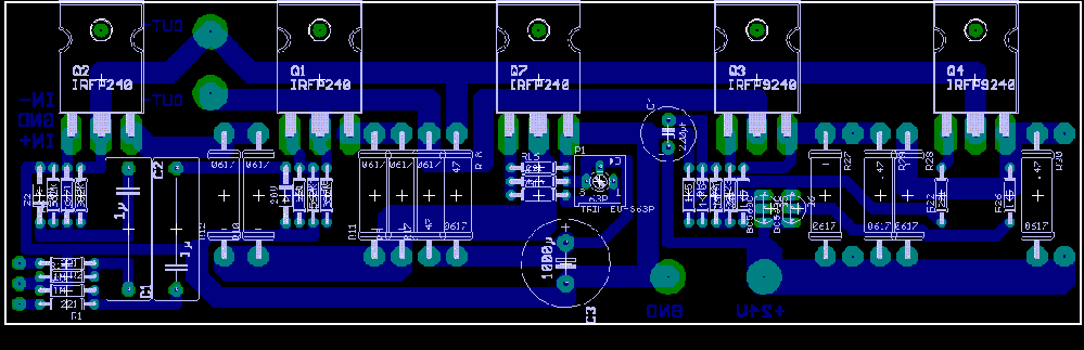

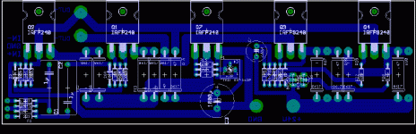

Thats a nice layout you have there, what tool did you use? I'm literally drawing squares in paintshop pro for metal, and I made templates for the C,R, and Q. I plan on using a star point-to-point grounding scheme.
I like that my layout (l-channel, r-channel, PS1, PS2) all fit on a single 6x9 PCB so I can develop one and cut it apart afterwards.
I realized a couple of simplification in the R18,9/11, area where all teh crossing happens.. I'll put it in tonight.

I use circuitmaker and traxmaker, and I recommend it over paintshop pro, of course. My pcb is also a standard pcb size (150x220mm). In general, you have to take care of the lenght of the traces. I'll tell you soon if my layout works as expected.
could we get some gerber files of these boards, or something suitable to give to the board maker???

Very nice PCB.. I really like the way you laid down the IRFP240s to get more routing room behind them... I was keeping mine on the edge which now I believe is the wrong idea 🙁 Guess Its time to redesign my output stages all overa gain 🙁

for layout see http://www.acaudio.de/F1_200.pdf

Hi acaudio!
Real nice board layout!
I have one comment though, i would like to see R3 between the midpoint of R7/R5 and Q1 rather then the way it is placed now. The same goes of course for R4 on the other side.
