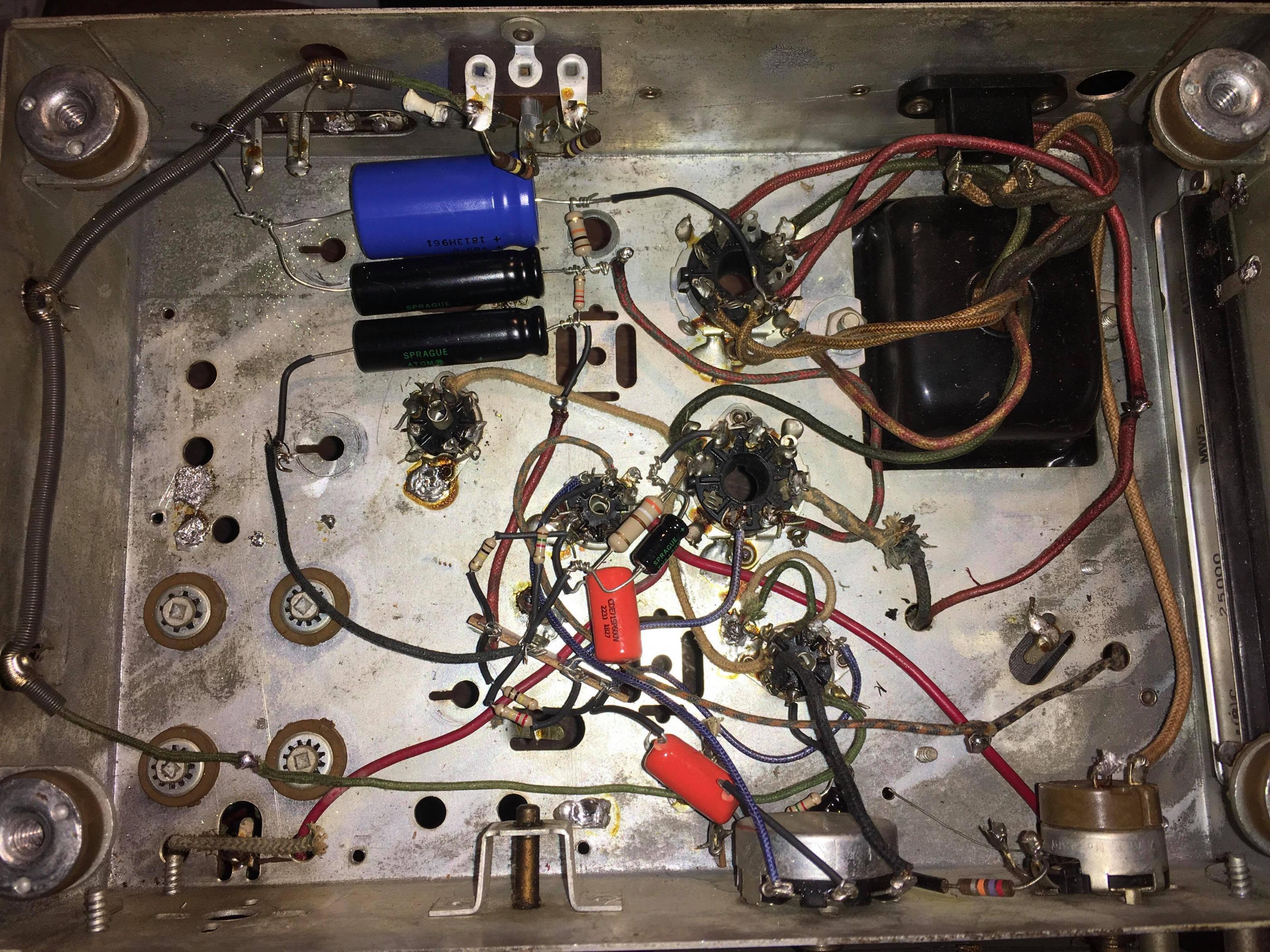

Here is a shot of my progress so far. Please be gentle if my technique isn't quite up to standards.
Pretty scary! :)
One of the main 'rules' of point-to-point wiring is that all connections should be made at a lug - a secure mechanical point. The rule is sometimes broken, but it's a good guideline to follow.
If you look at enough old gear first-hand and examples on the internet, you'll get the idea.
Your wiring is more 'breadboard style' or 'dead bug style' in places. OK to see if the thing will work, but probably not ready for safe long term use, IMO.
You have already seen why capacitors are available in axial and radial lead styles - there's a good use for both styles in many projects.

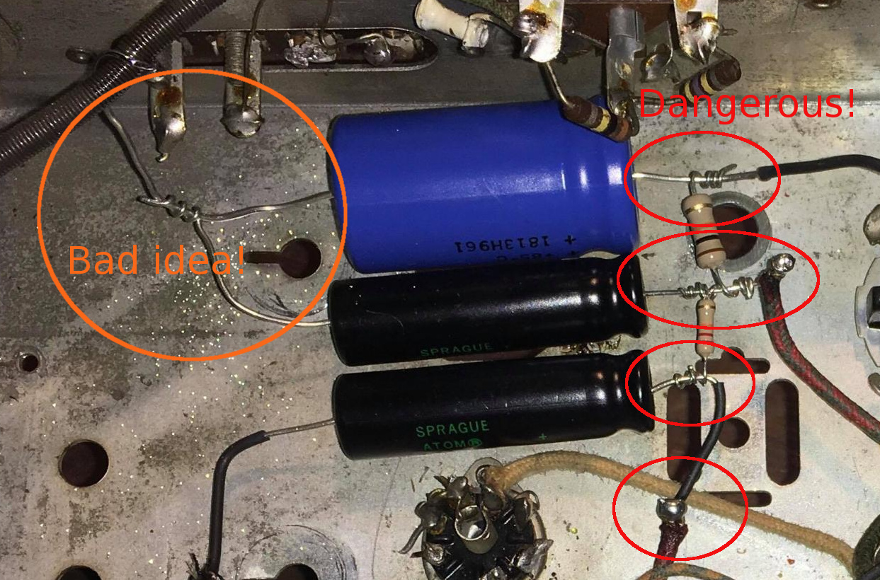

If I am reading your layout correctly, there are some areas that are, as VictoriaGuy said, scary: and I mean literally scary, as they could pose you considerable danger. :eek:
Look at the positive leads from your big electrolytic filter caps (red ellipses in the attached image) - they seem to be hovering unsupported a fraction of an inch above your bare metal chassis. Those wires are at something like +300 to +350 volts, and the metal chassis is connected directly to your guitar strings via the guitar cable.
Guess what happens if those capacitor leads bump against the bare metal chassis while the guitar is in your hands?
That's right, your hands come into contact with 300 - 350 volts. That much electricity will often cause your muscles to contract uncontrollably, so you might find your hands clamped to the guitar while it shocks the bejeezus out of you. You could wind up injured or dead. :yikes:
You want to make sure that no bare wires or wire ends can come into contact with anything they shouldn't. The orange circle shows an example of this - the negative leads from those big filter caps are likely to intermittently touch the chassis. In principle this is not dangerous, but it will certainly make nasty noises through the speaker - scratching noises, thumping noises, pops, bursts of hum, et cetera.
This is why every joint should be anchored securely to a solder tag, and bare wires should be covered by insulating heat-shrink tubing.
Based on what I've seen, I'm seriously concerned about your safety. These are potentially lethal mistakes, and while I've spotted a few, I don't know how many more might be lurking in your build.
It's absolutely vital that your chassis is properly wired to AC ground (not neutral, not live, only ground). That might save you from electrocution due to other mistakes (such as the filter cap wiring I highlighted.) But if this mains AC wiring is done wrong, that can be lethal as well.
Is there any chance you can get someone with some experience with valve circuitry to look over your build BEFORE you apply power? Perhaps someone at BC Robotics, or a local guitar amp tech, if there is one?
Please be safe - your life and health are far more important than any guitar amp.

Thank you. I will take my time and make adjustments to address these issues. The positive leads have a lot more clearance from the chassis than it looks in this picture (approx 1 centimeter, there isn't a lot of depth perception in the shot) but I will still look at minimizing any bare wire exposed. In any case I will take a break from my project to reconsider a few points. I'm not in any rush to get it done.
The positive leads have a lot more clearance from the chassis than it looks in this picture (approx 1 centimeter...
Firstly, thank you very much for slowing down and taking time to consider. It's the right thing to do, and a very wise decision on your part.
I am not a certified electrician, and therefore, I am not an authoritative source of electrical safety advice. Like you, I'm an amateur who wants to build valve equipment and stay alive and well. I've tried to learn as much as I could about safety, and will mention a few points I'm aware of.
Soft unsupported flexible wire leads a mere centimetre from being an electrocution hazard are nowhere near an acceptable risk. If those same leads are covered with heat-shrink tubing, with only a few millimetres of bare wire exposed, and those few millimetres are securely soldered to a securely mounted rigid solder tag, then at least you meet the safety standards of 1940 or so - though I'm pretty sure this will not come close to meeting current electrical standards.
Nowadays, one of many required tests for electronics equipment is that it be tested with a "standard test finger" ( What is a "standard test finger" tester? - EE Publishers ). The finger should not be able to touch any dangerous voltages.
This usually comes down to having a safe insulated or grounded housing around the dangerous bits, with no openings big enough to admit a finger, and of sufficient size that a finger couldn't reach through any cooling holes far enough to touch anything dangerous.
