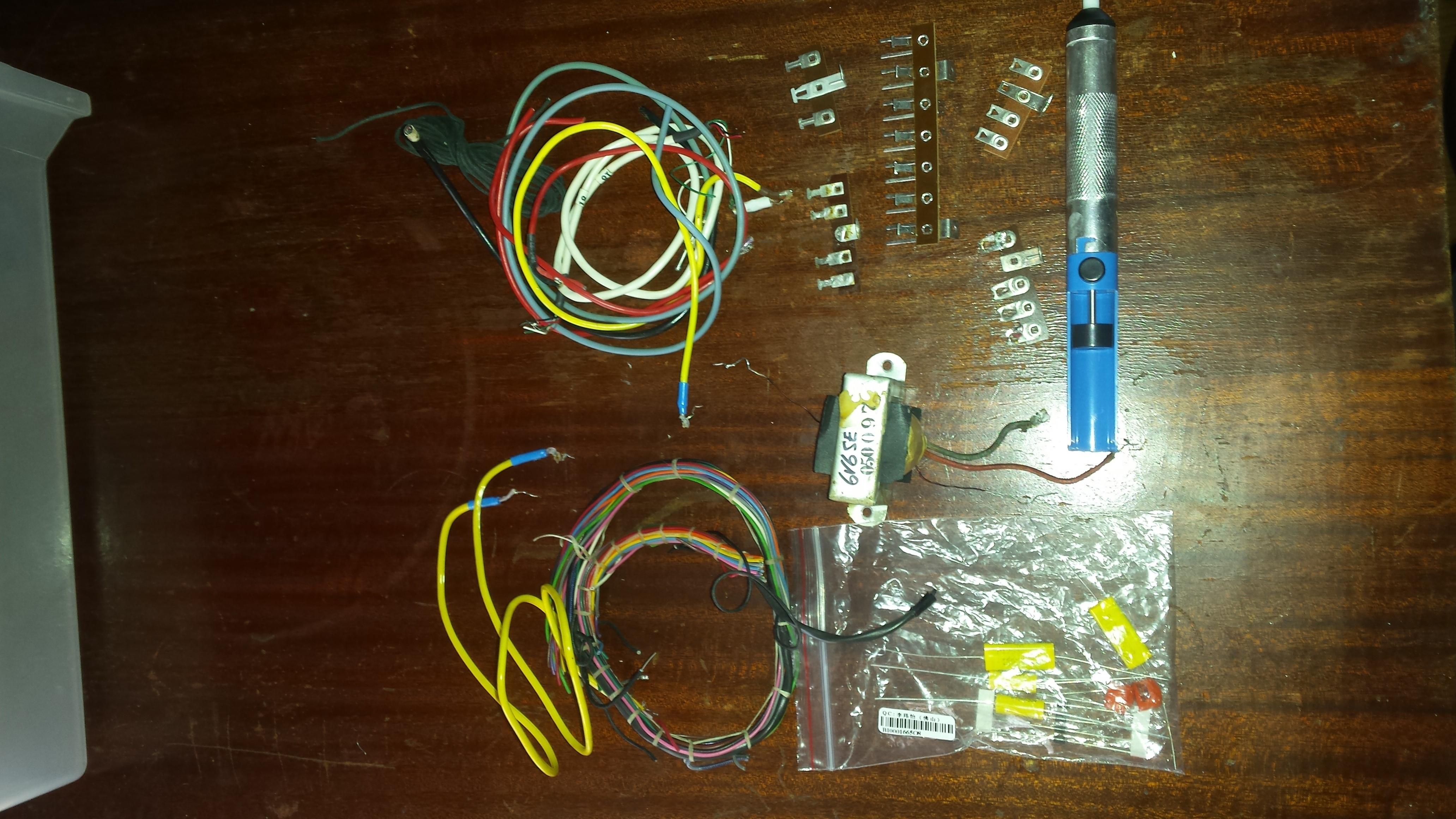

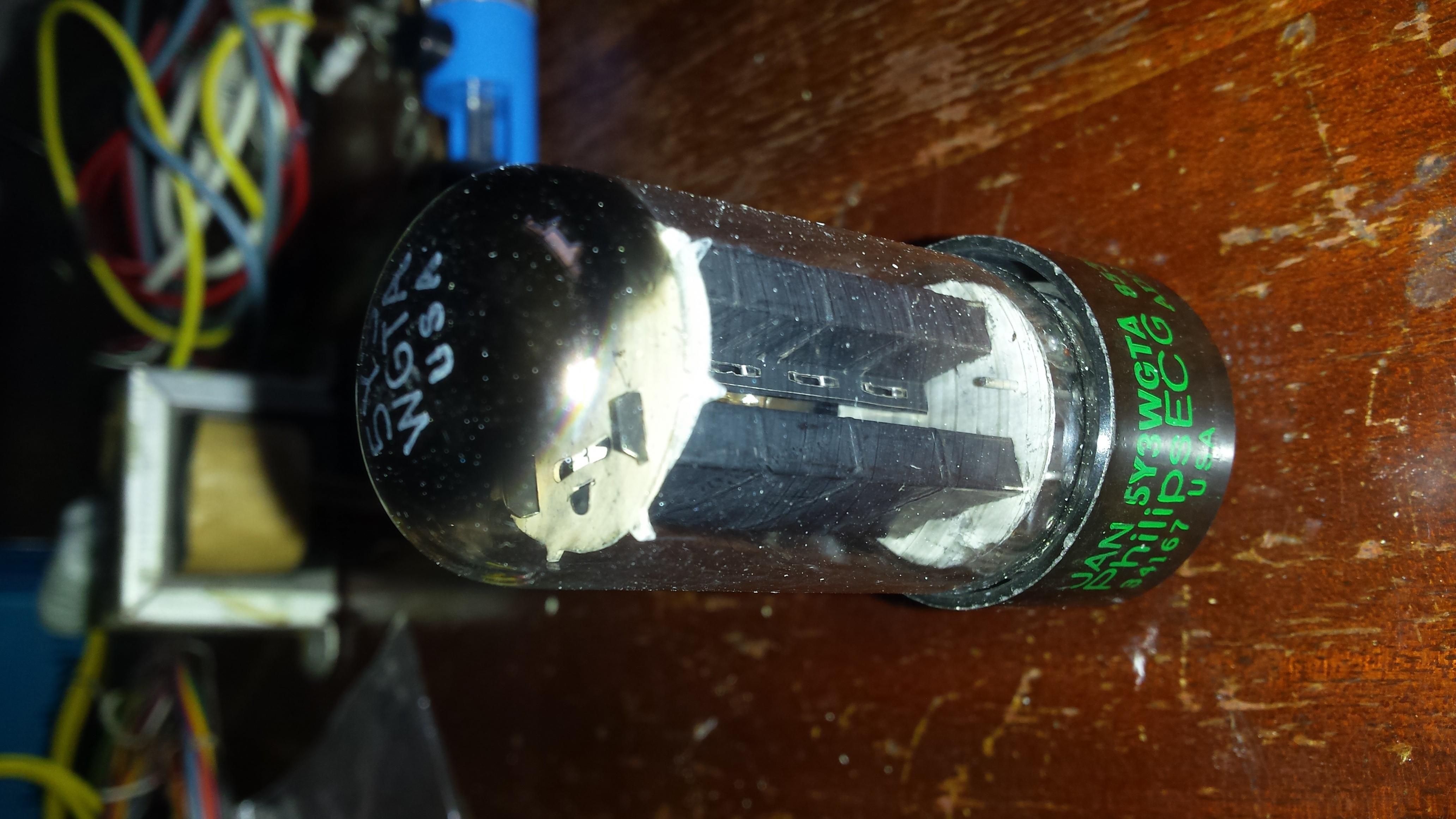

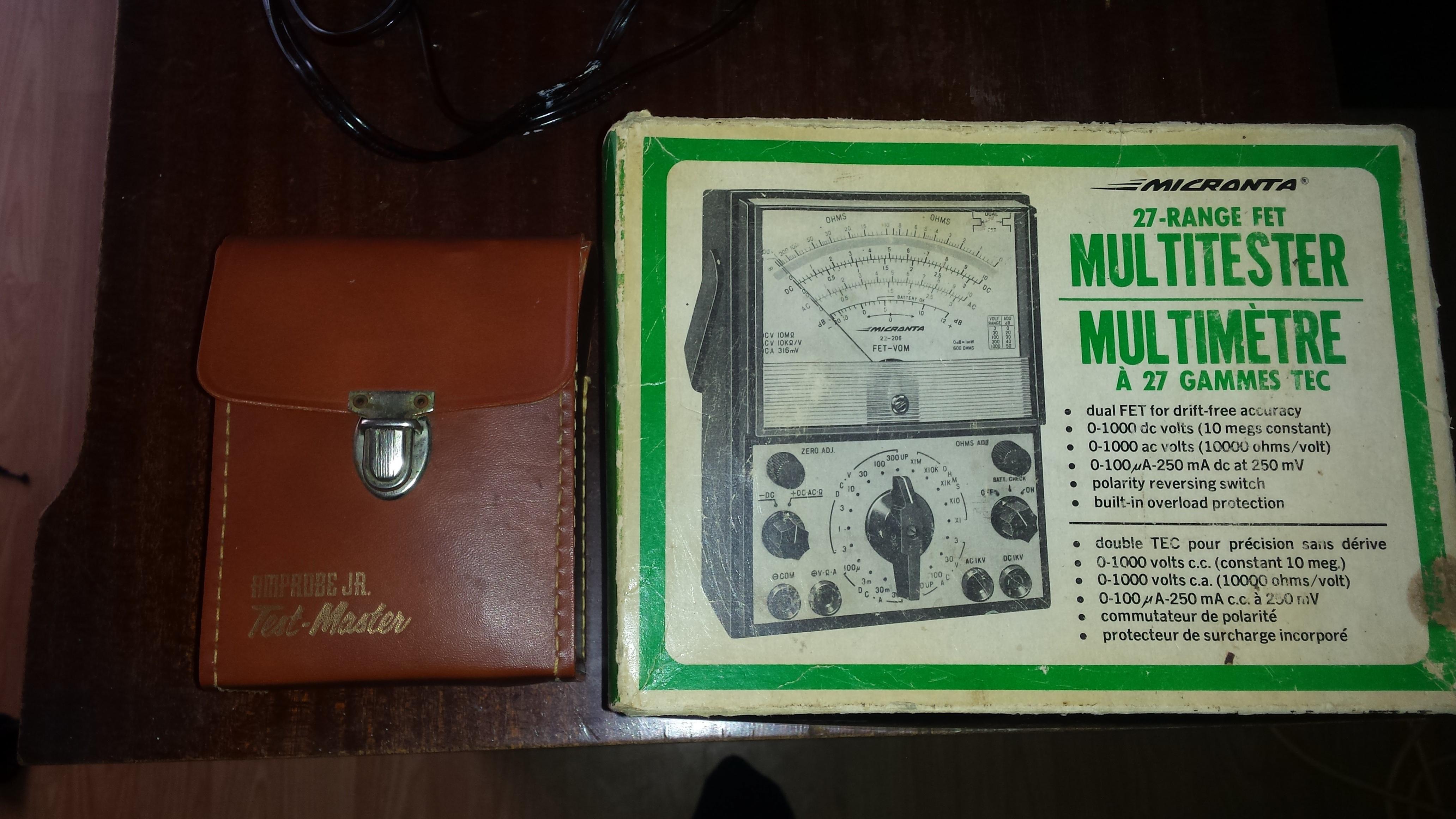

Got a few items today. Output transformer plus a few goodies. Rectifier tube last week. And I found a few analog testing devices this week plus a solder gun. More items to arrive shortly.
Going to have some fun soon!
Mmmmm.... Toys

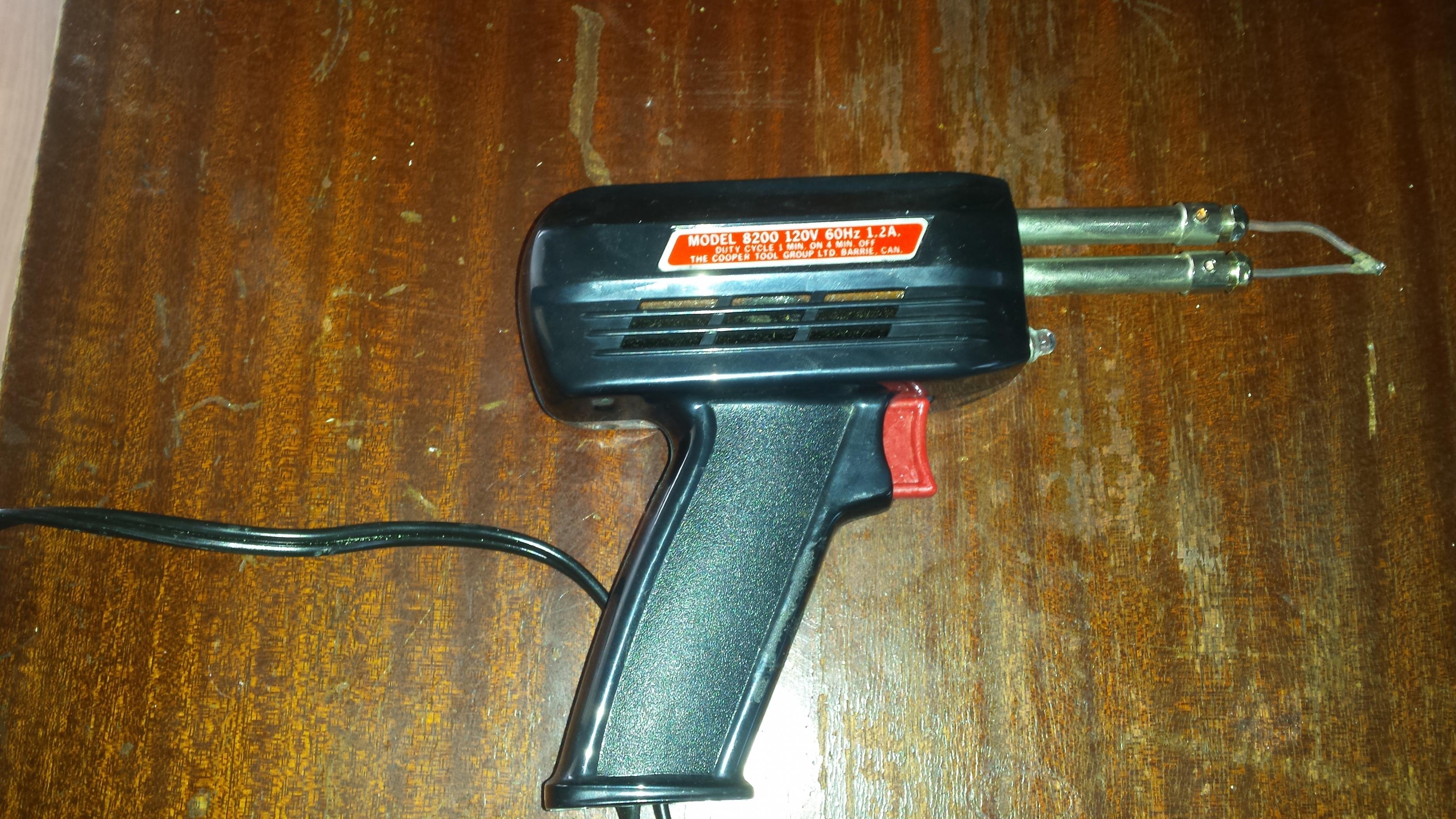

I wanted some analog testing equipment and this stuff seemed pretty awesome. I'll put them to good use shortly. The old Weller Solder gun works great also gets hot very quickly. Was having fun practicing soldering to a chassis with it.
Just remember not to use the soldering gun to solder any semiconductors (silicon diodes and LED indicators, for instance), or any other heat sensitive or high-voltage sensitive components (small caps, electrolytic caps.)The old Weller Solder gun works great also gets hot very quickly.
Even contemporary thermoplastic-insulated wire can be damaged by the high temperatures a soldering gun can generate. If you smell hot stinky plastic when soldering wire ends, that's your clue that the soldering gun is doing damage. (I have even seen the overheated metal wire emerge completely through the melting surrounding insulation, making for a potentially unsafe situation if the wire is carrying high voltage.)
A soldering gun is to modern electronics what a 10 lb sledgehammer is to a carpenter - brutally effective, but completely lacking in finesse, and best used sparingly.
-Gnobuddy
I use my soldering gun infrequently.
Best use I've found for it is putting a cutting tip in it and using it to cut webbing and line for other DIY projects.
A 'big ole' iron with a heavy tip (a real sledgehammer!) is the thing to use if you need (want?) to solder directly to a chassis - it's not just the temperature, but the heat capacity of a heavy iron that's the key for that.
I recall paying $1 for my heavy iron at a ham swap meet - a great place to find/buy gear. Check your local ham radio club for dates - most clubs have a swap meet every year.

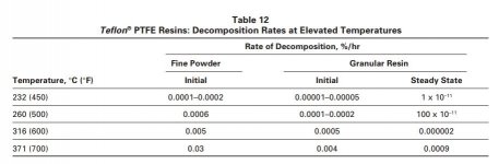

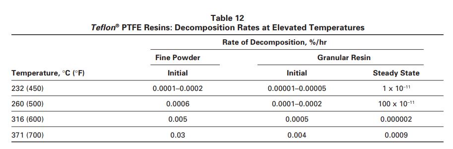

I disagree.Using Teflon (PTFE, poly tetra fluoro ethylene) insulated wire at home is a very bad idea.
Teflon properties- see attached data from:
http://www.rjchase.com/ptfe_handbook.pdf
63/37 Pb/Sn solder melts at 183C or 361F
If I were working in an electronics sweatshop, soldering Teflon insulated wire 40 hours a week, without ventilation, I might worry about Teflon degradation- though flux fumes would probably be a more immediate concern.
I'm a hobbyist and probably only solder a few hours a year, total. Each joint takes a few seconds, and many don't involve wire insulation at all.
I do use a simple 'fume extractor' to move fumes away from my electronics bench.
My soldering iron is set to either 700 F, or 750 F, depending on the thermal mass of the joint I'm soldering. Which is higher than the 650 F temperature above which PTFE breaks down, according to the document you referenced.63/37 Pb/Sn solder melts at 183C or 361F
I remember that of Teflon-insulated wire emitted quite a stench when I was soldering it 30 years ago, so some of the insulation certainly did get hot enough to break down and emit gases.
I understand the concept of free will, so let's agree to disagree at this point, and move on with trying to assist Jostenso22!
-Gnobuddy
