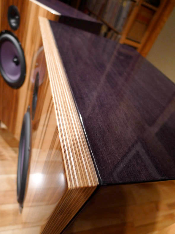

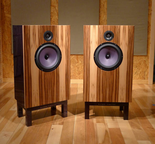

If you veneer just the front (or use pre-veneered ply for the front panel)
and stain the rest (assuming the rest = marine ply), you could have a result like the attached images.
I personally prefer this 2-tone effect, with exposed ply edges, rather than full veneering, but everyone has their own opinions on what looks best.
My main speakers use a double layer of hardwood ply with exposed edges (and I also used plenty of bracing). My opinion is completely biased 🙂

DeVore Fidelity Orangutan O/96 Loudspeaker Review: Part 1
The review is full of waffle; I used CNT+F to discover that it is "fiddleback mahogany veneer". Some strand woven bamboo panels have a similar look.

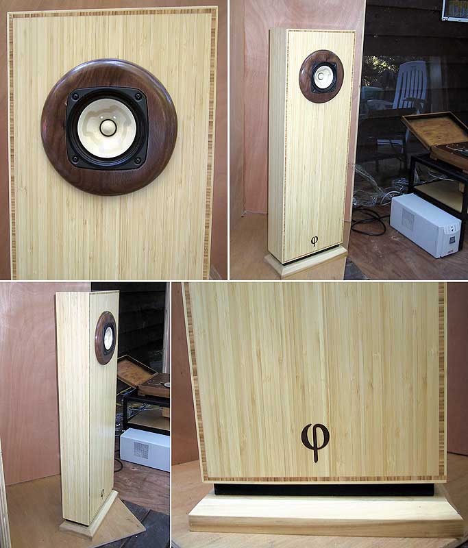

Is this just for aesthetics / appearance of the end grain?
No. It should create a much stiffer board than just using them as surface layers on a block core.
For what it is worth, I think the edge grain on these (pictured - these are yours, yes?) = a great feature.
Yes, Chris’ 1st build with Bamvboo and he did a superb job, and you can see where his mention of the joinery being a bit fiddly. What looks like marquetry is exposing ½ of the end grain of the board.
