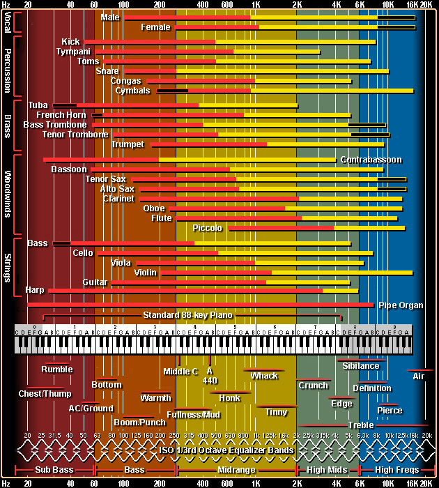

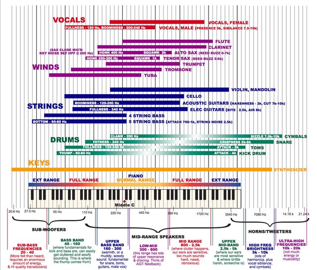

Best I can come up with if it isn't a lack of bass is maybe you need more output from about 150/175Hz to about 550Hz. Attached are a couple of charts that may or may not help you identify specific frequencies and certain instruments.

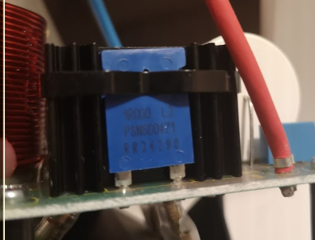

Hello , I just opened her up, easier said than done...
Looks like decent quality components mundorf caps, however its like yall said, 4,3 uf cap and a 4,5mH inductor giving me hipass of 4625, and a low pass of 285 all first orders. Quite strange. However there were a component i did not recognize ill attatch it
