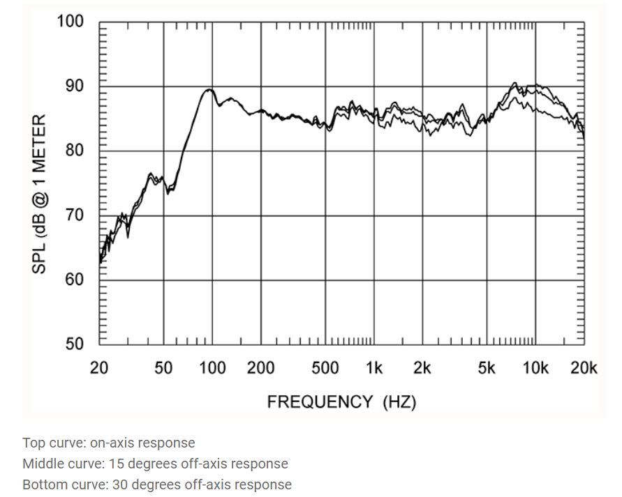

So I thought it might be useful to look at some measurements for your current speakers. Attached below is what I found from a Soundstage review.
As chris661 said previously, boom-tizz indeed, except sort of without the boom. F3 doesn't look to be much higher than about 75Hz depending on what other frequency you are comparing it to. And the rise in response from about 300Hz to 100Hz makes me think that the lack of bass presence that you think you lack is actually just a lack of bass. Or maybe midrange too. But it doesn't look like you are currently missing out on anything centered around 200Hz. Maybe 400-500 is the culprit?
You mention that you have sub(s). Have you tried these speakers with subs filling in the bottom end?
The measurements also make me think that if you listen to something with an actually flat response, it's going to sound dull and somewhat uninteresting to start. Might take a while for your ears to adjust in other words.
Hi , I have two pairs, yes. Subs makes a difference, just not as nice as when I tried a full 3way, I think ive mentioned that it might not all be the low-mids can be middle mids, for more definition , thanks havent seen the s2 review going to look further into it
Edit, still will check it out since thats a quite intressting fr curve
