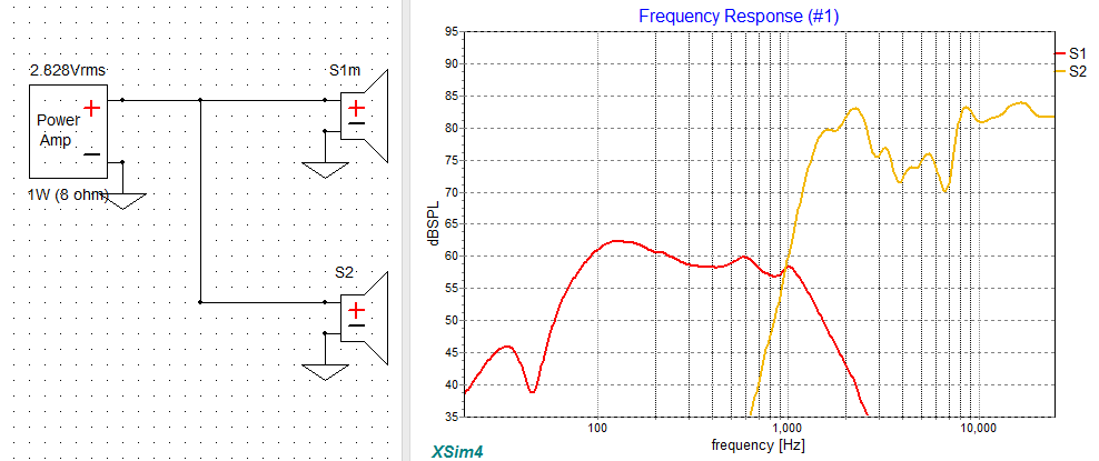

So, that's been entered in the software, right? I thought those entries showed on the schematic when entered. Maybe that's a different software I'm thinking of.
Can I see the raw woofers response? I always use gated measurements. Are you using your in box measurements, or something from a different driver, and speaker? I think you said you didn't yet have a mic. Are you just practicing with other data?
no, it is not inserted at the moment - I only find out now that there could be somewhere to put this measurement/distance of the two drivers. this evening after dinner I will reopen it and check if it is there and if it should then be visible on the work surface. I will also try to change the driver data with different files and perhaps I will find something that is closer to this WF 1334 16ohm and the 4ohm 38mm tweeter without a brand, car audio which if I remember correctly was also expensive and an alternative to the Morel mdt29.

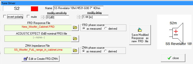

Right click on the driver and look for the feature called "modify delay" and sorry, the scale was wrong. Add an inch or more to get into the range of a typical 2-way with 6" driver.you mean like that?

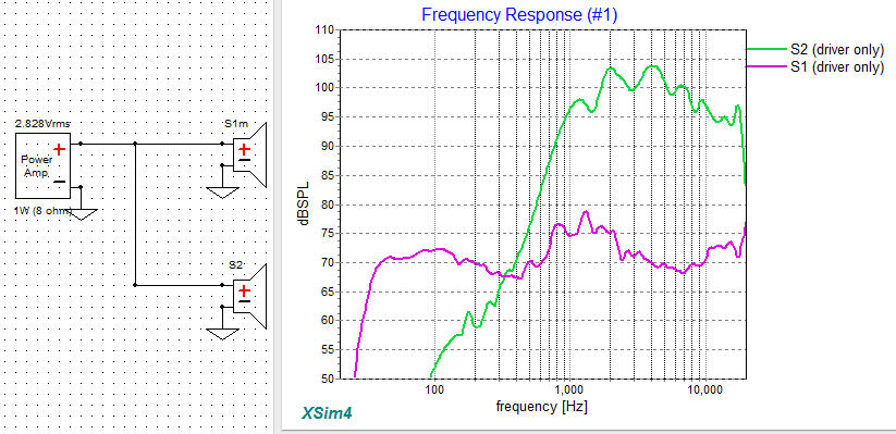

ok, i played the driver files as per manual. now you can see the curve of the drivers only.
S1 woofer
S1 woofer
yes, but by building the files with vituxCad from the frequency responses/images found on the net.
They are not realistic. The difference in sensitivity is quite large and where did you get a woofer that does 20kHz?

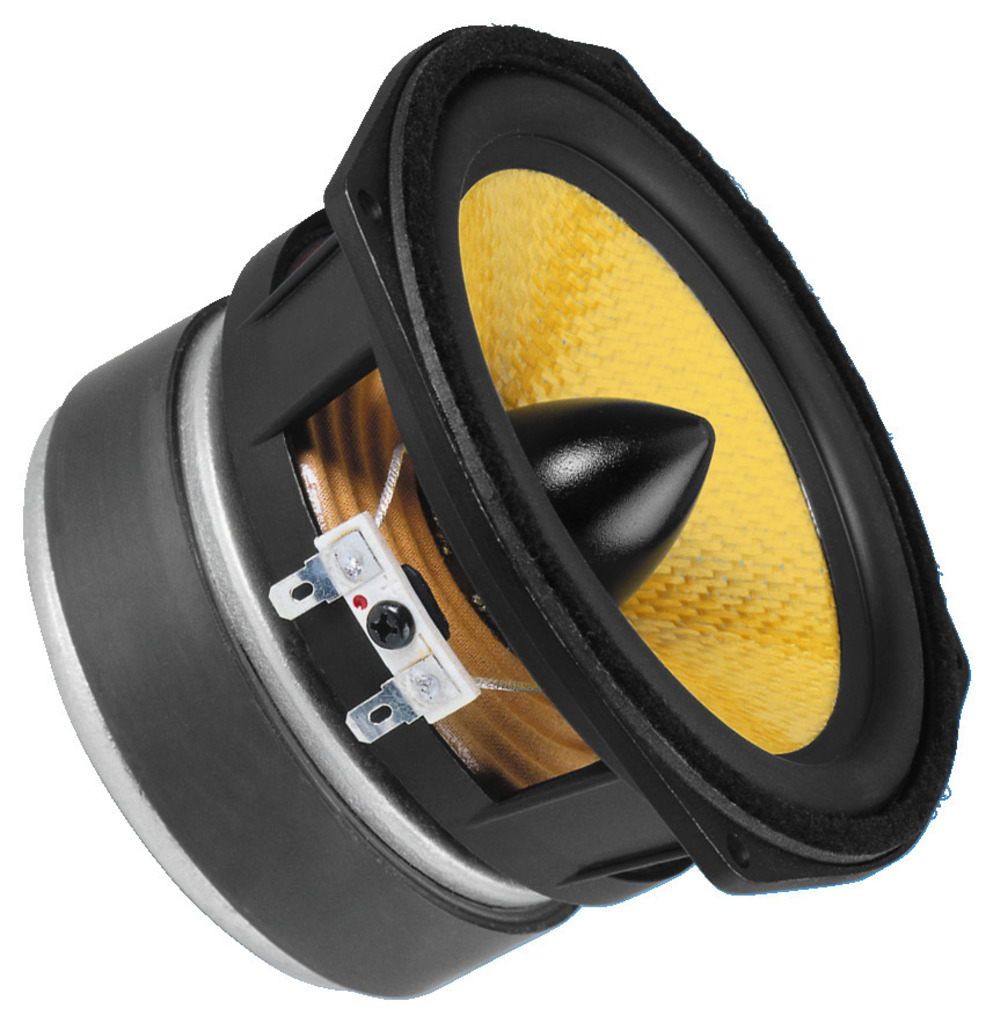

I see, they are custom drivers: I checked but I did not find anything like those in the pic. Anyway they remind me this Monacor mw.Jeff is using the 1334 woofers, nominal impedance 16 ohm, removed from a Wharfedale Diamond 8 centre speaker as pictured below.
He is not using the associated Wharfedale 0326H tweeter, and I'm not sure if he mentions which tweeter models are shown in his final build in post #33.
https://www.monacor.com/products/components/speaker-technology/hi-fi-midrange-speakers-/sph-135kep/
but 🙂, searching better I found something.

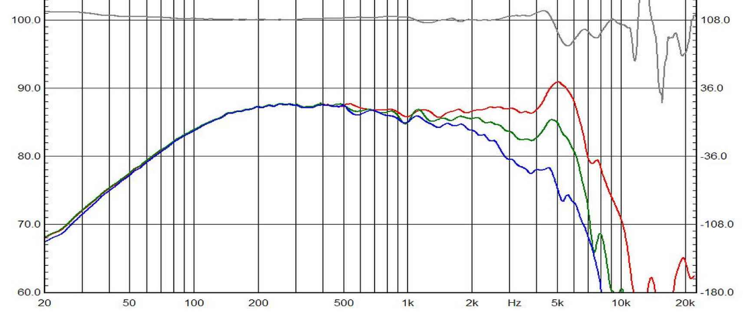

now I would like to understand which curve to use for the simulation - I see frequency responses measured at 0, -30, -60°
which of the three is better to use?
and what color do they correspond to?
0, 30, 60 = Red, Green, Blue.
30 is typically more representative on the whole. The bass rolloff will be pumped up a little by the inside of the box, and the lower midrange will be stepped down by the outside of the box.

- First start of XSim, but...
