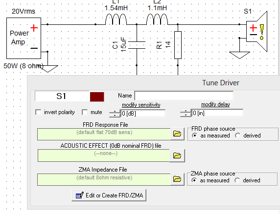

to get the .frd and .zma files from an image and accurately it is better to free every intruder in the drawing.
clean the curve well and then import it into the tools.

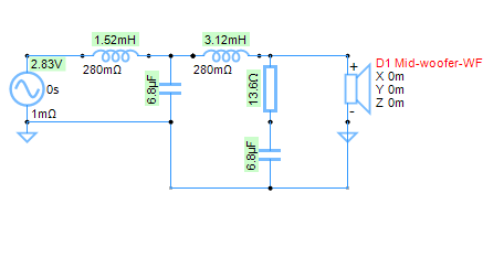

simulation with the parameters of the finished crossover, already listened to and corrected several times.
after this simulation it is possible to think:

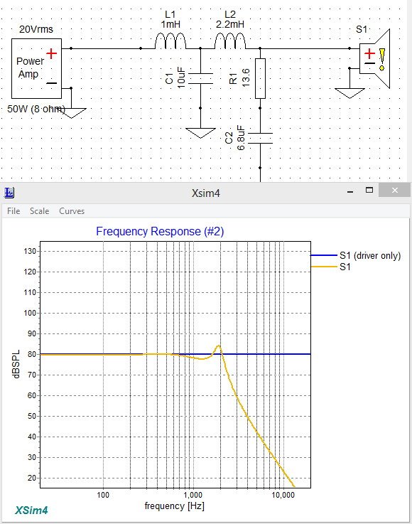

Start simple.
On the woofer.
2mH coil......just like a first order filter.
Add to that a notch tuned around 5k.
That's a cap, a coil, and a resistor. Trial and error will get you the precise values needed, but for a start, try .5mH, 5uf, and 1 ohm. These are in series with each other, and then placed in parallel with the woofer terminals.

eh dear Temp, I started out simple and I even tried it in several tests and it didn't sound good - this mid-woofer has a lot of voice, a lot of mid-highs and for this reason it became a more complex 18db woofer, 12db tweeter and with Zobel on both drivers.

what you see of crossover is one of those that when listening came closest to the sound of the LS 3/5a

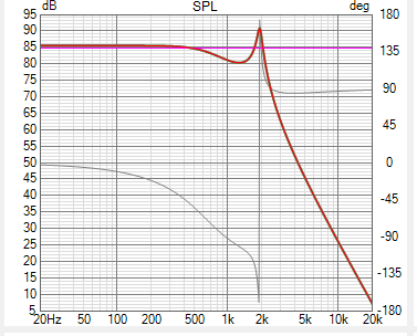

First, those new peaks near the upper end of a driver's output indicates your Zobels aren't right yet. See my example charts here.

I can't really tell what's going on anymore with random plots, impedances, and maybe circuits? My general suggestion would be to start with values near a textbook configuration and modify more modestly as needed to achieve a target curve. This should keep you closer to safe values that don't have odd or highly resonant behavior.
I didn't check the tweeter leg or other circuit elements to see if they have similar issues.
The big high Q peak on the woofer branch definitely gets my attention. Your L2 value is very far from what a normal 18 dB/octave crossover would be at 16 ohms (something around 0.6 mH would be more typical assuming a 2 kHz cross point) and your resultant acoustic slope looks to be greater than 36 dB/octave. C2 is doing very little, so I would remove that as well, but I'm one that's typically trying to simplify. Maybe you came at these issues thinking more complexity was fixing problems or you used components you had on hand, but I'm not sure you landed in a good spot given what your recent plot shows. Without real measurements, it's all a bit of a guess, but circuits that are far from suggested values are dicier.it became a more complex 18db woofer

So, you're unwilling to try a suggestion even in a sim? The response in post #59 looks like almost half the Peerless drivers I've worked with.
no, i'm doing several tests - with several approaches. i'll do many of them and i'll do this one too, as others suggested. first i need to get as close as possible to the data of these drivers. that curve you're talking about is from the Kef B110 sp1057 - used for the Kef Reference 104/2, different from the B110 sp1003.

I don't know whether you are interested in having the members of this thread show suggestions, but the forum is capable of attaching Xsim save files to a post. Xsim save files contain the data so you only need to attach the one file.
Sorry, C5 in your schematic is actually the one I meant. I started my own XSim file modeled after yours to check some things, and I didn't match your component numbers, so got them mixed up.
are you talking about .dxo or snapshot files

well, i noticed that peak too, of course - i also noticed that tweeter has an unusual hole and it's right on the driver. i think the tweeter .frd file is not correct or suitable for these tests - moreover and i'm almost certain that if i put the simulation components on a piece of wood, the speaker will sound bad, very bad... maybe i'll be proven wrong, but i'll understand that soon - tomorrow at the latest i'll assemble it and give it a listen.
in the last attached file there is an error of some db in the frequency response of the tweeter.
today i recreated/reproduced the crossover with a different approach, completely different from this one and the direction is the right one - because it sounds good!
thanks to all for your suggestions.
the road is still long, but - I can make my way... especially on the graphs and how to get the frequency response of the drivers in the most detailed way. yesterday I assembled a second crossover with a different approach and right at the first try / listening it was almost perfect.

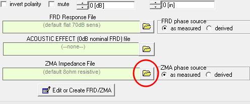

- First start of XSim, but...
