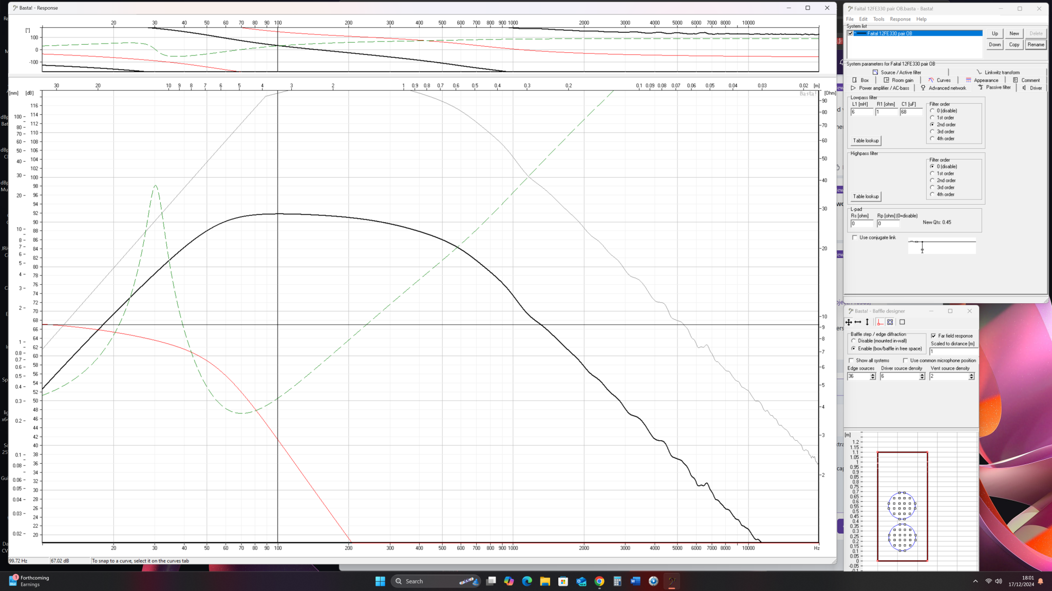

Hmm. You've built far more speakers than me, @perrymarshall, but I don't agree. I'd go for two of those Faitals, with a chunky inductor, and a bit of extra resistance.
Here's a quick model. The Faitals are on a 500mm by 1100mm baffle, with a two component low-pass (6mH inductor with 1 ohm DC, and a 68uF cap). Over 90 dB sensitivity, and a -6dB point of about 43 Hz. Second order roll-off with crossover about 500 Hz.

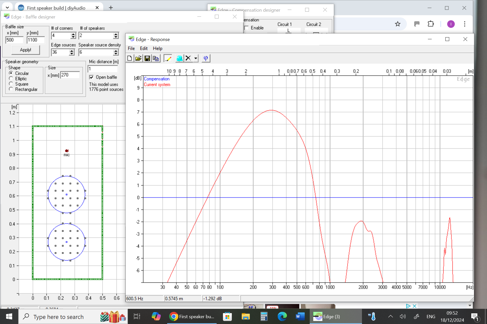

I can’t tell what your assumptions are about your baffle in your model.
A woofer with a Q of 0.45, Fo=30Hz in a baffle the size of the Cottonwood Dipoles, the Walnut Dipoles or the Faital Dipoles (www.PerryMarshall.info/speakers) will not have that much bass. Those cabinets have a “dipole F3” of about 70Hz which of course falls off at 6dB/octave.
Hi Perry, the only assumptions I made in my model were about baffle size/shape. As far as Basta's assumptions are concerned, it uses the same model as The Edge - both are Tolvan Data products. It's a 2D model (like Vituixcad, I believe) so it takes no account of what goes on behind the specified surface.
Basta! (to give it its full title) has been popular with OB builders for a while, I believe. It's a much simpler, more limited program than Vituixcad, but the learning curve is gentle. I find it useful.
I meant to say, too, the driver's Qts is effectively increased when there's series resistance in the circuit, so the nominal 0.45 figure isn't really applicable any more. (If I've got this right, the additional 1 ohm in my modelled circuit takes the Qt up to about 0.53. More resistance would take it further, at the expense of burning off more power in the resistor, obviously.)
Anyway, here's an Edge sim of that baffle/driver size combination. I'm not sure how it'll compare to your experience:

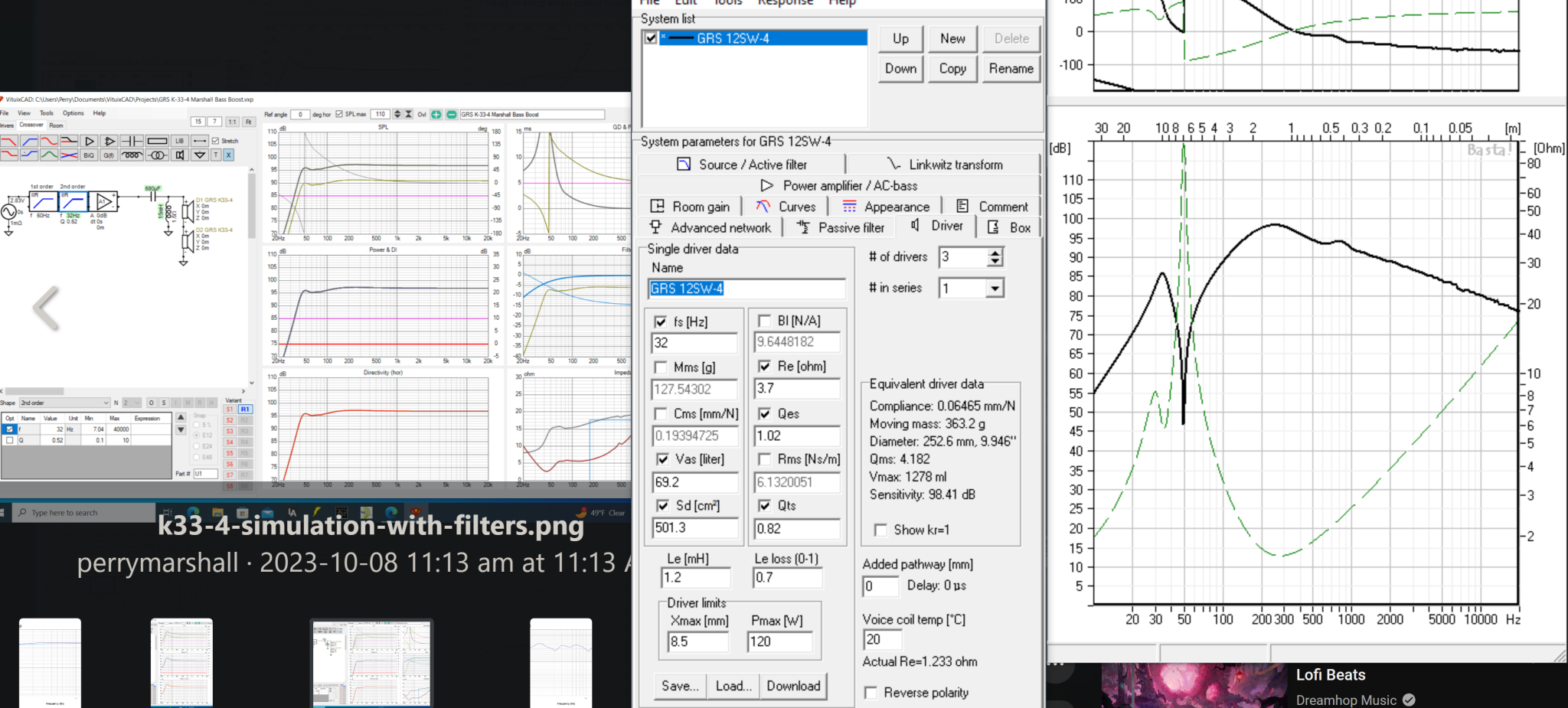

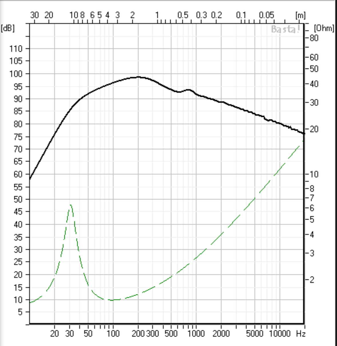

...Oh dear. I tried to use VituixCAD2 to "do something", got stuck even combining frequency and impedance graphs together, to even get in drivers parameters to start failed. I wanted to use @Marshals bass boost on 3 x 12SW-412" polyclones 4 OHM. Perry, could you simulate this for me, please?

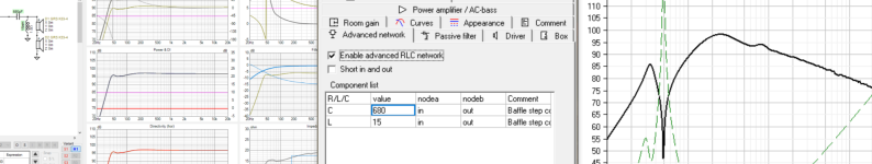

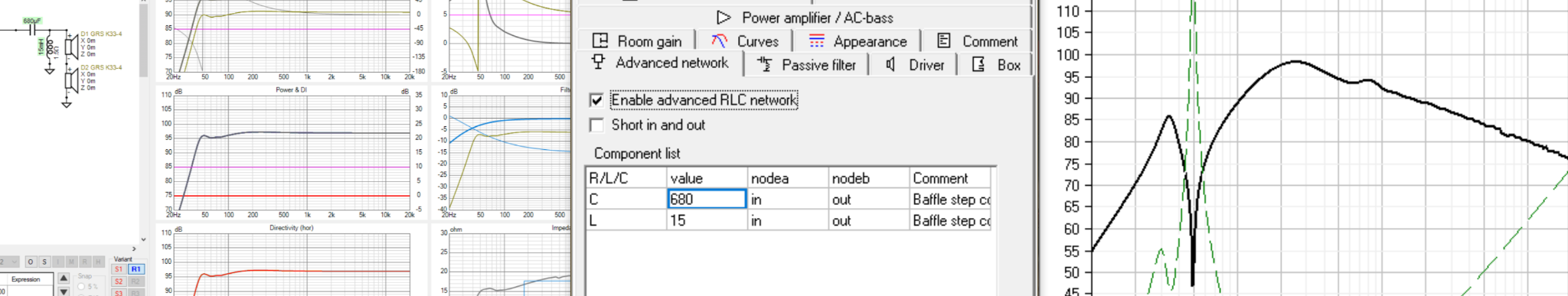

@ianbo Would you know is it possible to put @perrymarshall bass boost circuit in Basta! Also I don't know should I put roll off of the driver (Q=0.82, Fs 32) (“2nd order filter” above) and 2) the roll off of the Open Baffle .
I am trying at least copy something just to have any idea what's for what...🙁
