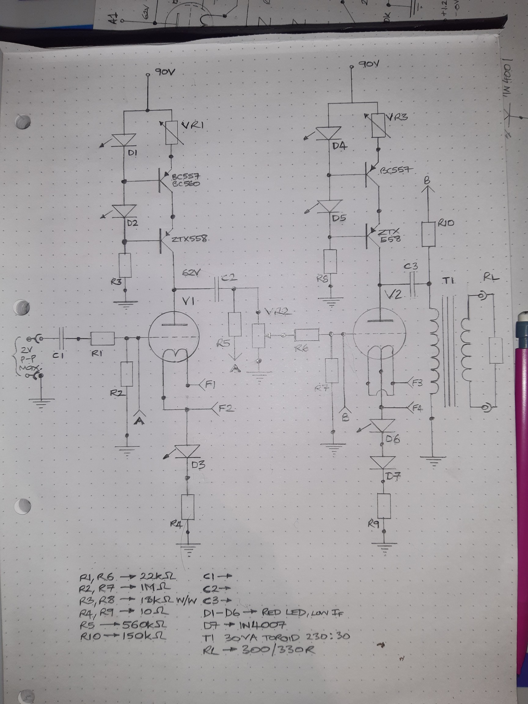

Finally, a schematic for those interested - it's still a WIP so improvements are definitely possible!
At B+ 90V, in this design, I measured about 1% THD at max output (2V p-p) at around 15mW, which should be OK with 300R cans like sennheiser HD600 etc.

The realisation Dawns on me that I have not explained any of the development in the circuit.
My earlier posts referred to open loop, no local NFB. I added local feedback to the output stage only at first, aiming for a gain of 4 or 5 V/V. Then I ended up doing the same thing to the input stage, only less feedback.
The circuit in the post above achieves about 15-18mW using the obsolete RS 115+115:15+15 30VA toroid, THD better than 1% with 300R load.
In testing I couldn't find a EI core transformer that wasn't far more lossy overall, and severely bandwidth limited.
Using another toroid, same RS type, but with dual 20V Secondaries yielded more output but at elevated levels of THD.
It may turn out that this toroid works better if the B+ voltage is raised from 90V to 120V, for example.
