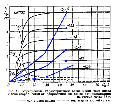

Sadly the Gòogleplex hasn't offered me any curves, either pentode or triode wired for the 1J29B....
You can always sketch on the pentode curves.
When Vp=Vg2, the triode and pentode curves align. Ip(tri) is really Ip+Ig2, but in the tube you cite Ig2 is <10% of Ip so is lost in uncertainty.
At Vp=0 all I stops (very-very small). And usually small Vp makes small current (I'm unsure why this plot seems to stop at Vp=5V).
Now sketch Childs Law curves through zero and the Vg2 points. No great accuracy is needed, not worth finding your French Curve.
We see that Mu is about 9 and rp runs near 10k at high current but 20k at medium current, over 40k near 1mA.

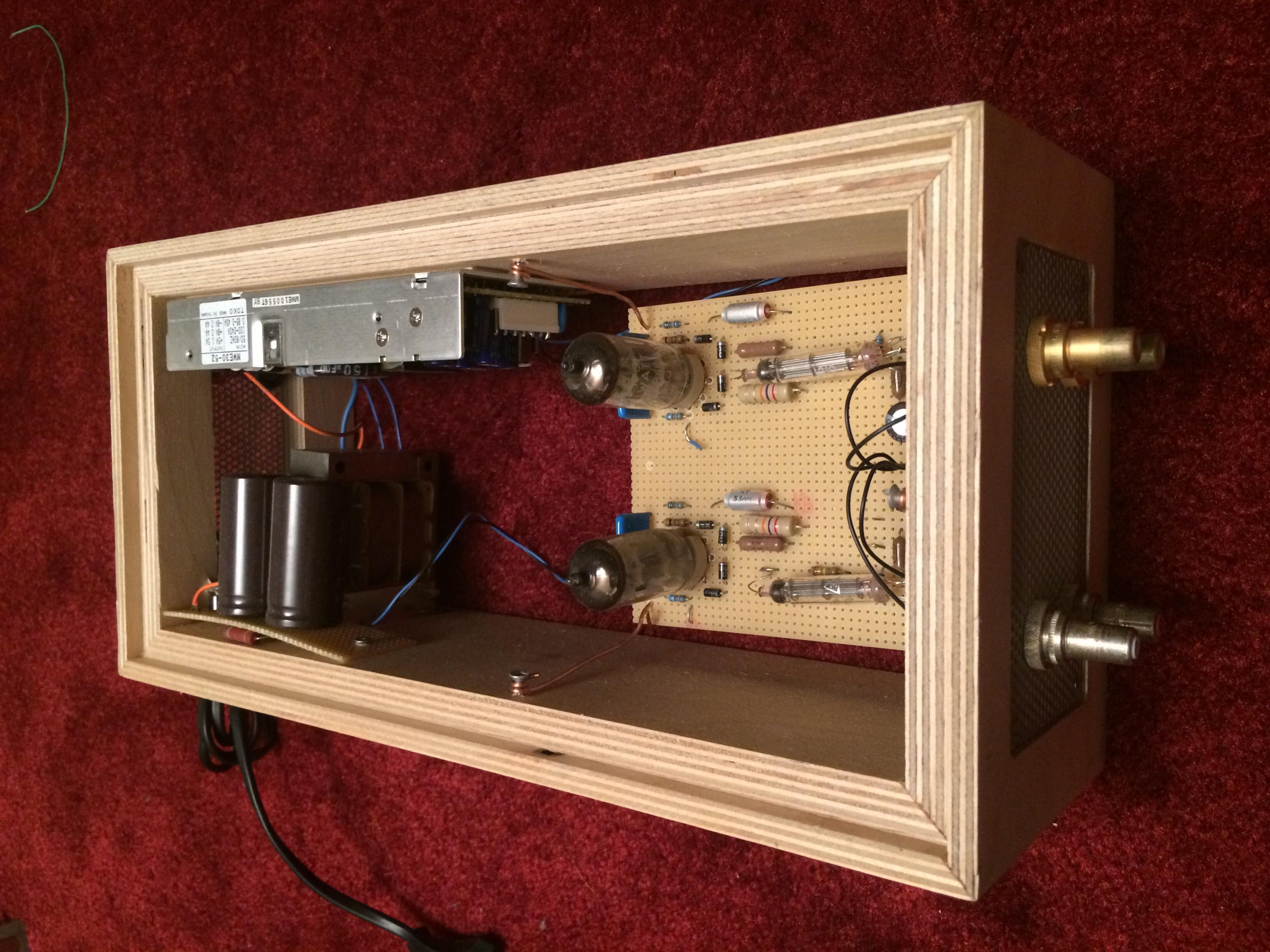

I had a chance to try out the basic circuit for 15mins during coffee break today.
Rather disappointing, I may have an error in my connections somewhere. More than likely, IMO.
Using 68k anode load, 1M grid leak resistor, and g2 tied to anode, g3 to ground.
Powering up with B+ of 100V, the anode sits at 22V, grid is 0V. 😡
I must have something wrong in the filament connections, and Cathode (is this a cathode, or a screen?)
Increasing grid leak to 5M then 15M has no effect.
Reducing B+ to 80V still leaves the anode at 20V, almost no change at all.
but....
It does amplify, at least into an open circuit 0.142 Vrms in, for around ~1 Vrms out
Until I connect the output load resistor, 100k. This kills the output stone dead.
When I get more time, I'll break it all down again, and check all connections, and use another tube.
Probably also more like 1M load (seems very high though)

5 is a separate screen pin (connect to 0V) 4 and 6 both connect to battery minus and cathode, 1 to battery plus.
Ah ha!
So i had the screen grounded
Seems I have filament supply reversed.... confusing since:

Well despite me getting the wrong end of the schtick....
Connecting as Piano3 states, makes absolutely no difference to the operation.
Soooooo....
Either I have other issues with wiring (theres only 3 wires left that havent been checked, and they should be correct)
Or the tube is shot

Firing the test up again, and accidentally raising the filament volts above 2V momentarily....
Now plate volts sit even lower.
I've cooked the filament
This particular tube, I had demoed to my 7 year old using an AA battery, so I had probably messed up
Interestingly (to me, as a novice), reducing the filament voltage, brings the plate voltage up again.
Gain suffers greatly, but there is still amplification at a mere 0.7V across the filament!
