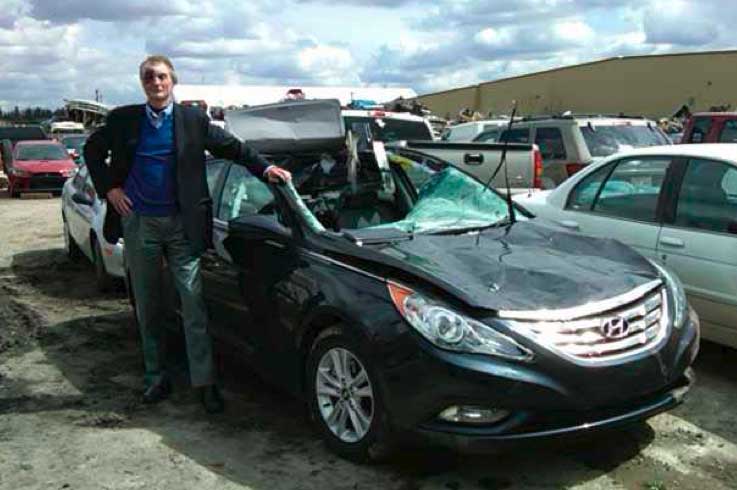

And this guy (my uncle) was lucky to survive an encounter with a moose. His car not so much.
dave
Our Audi A6 S-line (it was a 2007 i think) looked pretty much the same. The roof was pushed back almost a meter. The car wasen't worth repairing, estimated costs was above 400.000 swedish crones (which is bloody much money!).
How did ur uncle do then?
From the look of it with a major headache at the very least. I hope the moose didn't suffer too much either. Noble creatures.

Uncle is really lucky, if the moose had been inches over he could have been killed, he got away with a HUGE shiner, the moose died.
