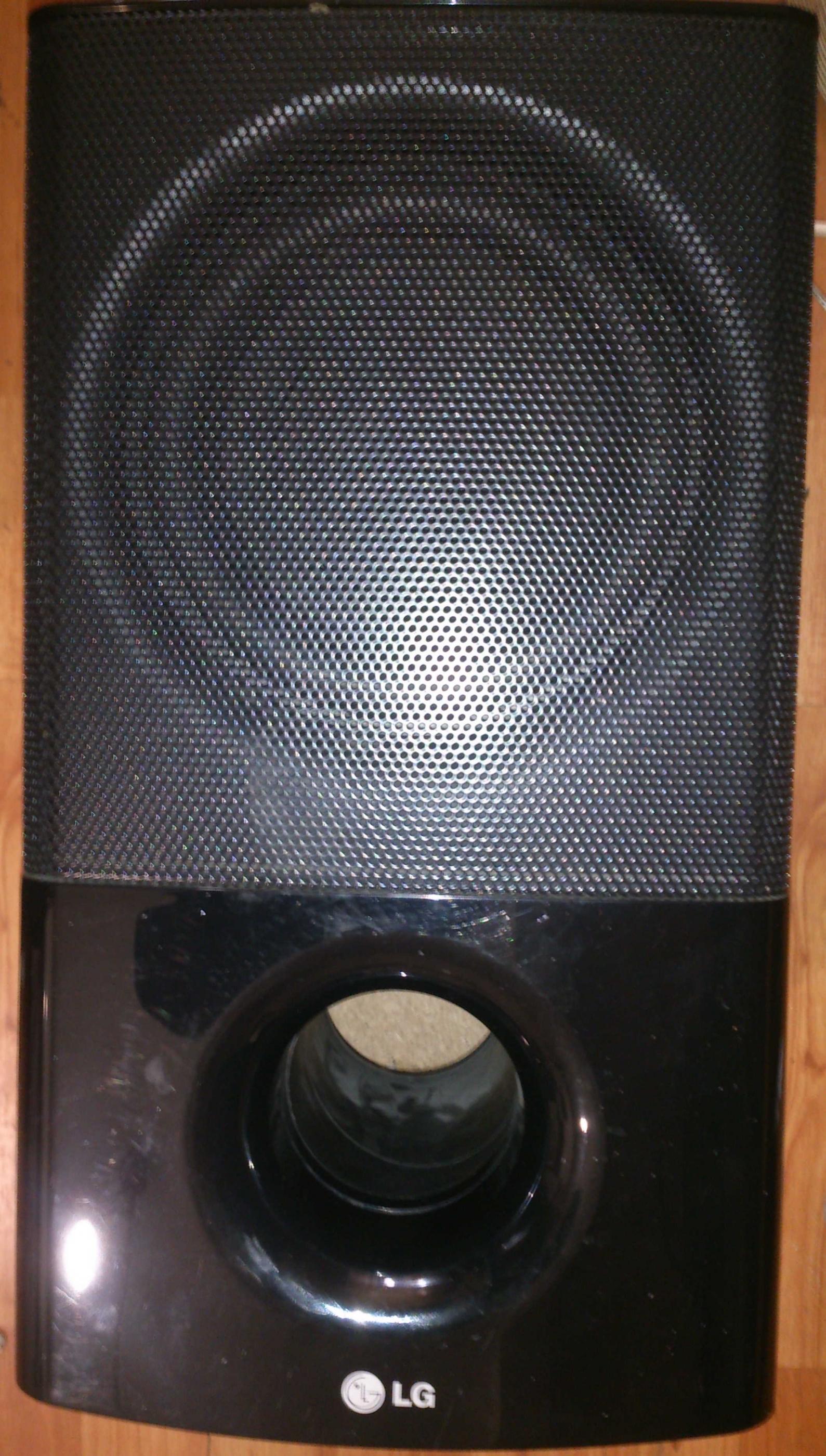

- Subwoofers
- First post, a woodworker needs a small sub
