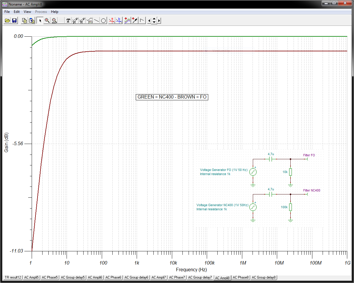

Member back a quick look data for NC400 it has 10 x higher input impedance than FO, then if your pre not DC coupled but has a cap in output make this 10 x bigger in value, or try a DC coupled pre and compare with both amps.

Maybe your DSP has high output impedance, so not optimally adopted to the First One and there you get low signal on low octave. As I remember the bass was the weak side of the NC400 and one of the reasons I sold it, also high spectrum was a little bit harsh, so no regrets left behind.
i think you have it right.just checked the alpine,s specs and output impedance is 1k.
it,s a bit high for 10k input of f.o.
but the bass is the weak side of nc400?no way everybody that have heard it said it,s the stong side.
maybe it,s too much control for your speakers.

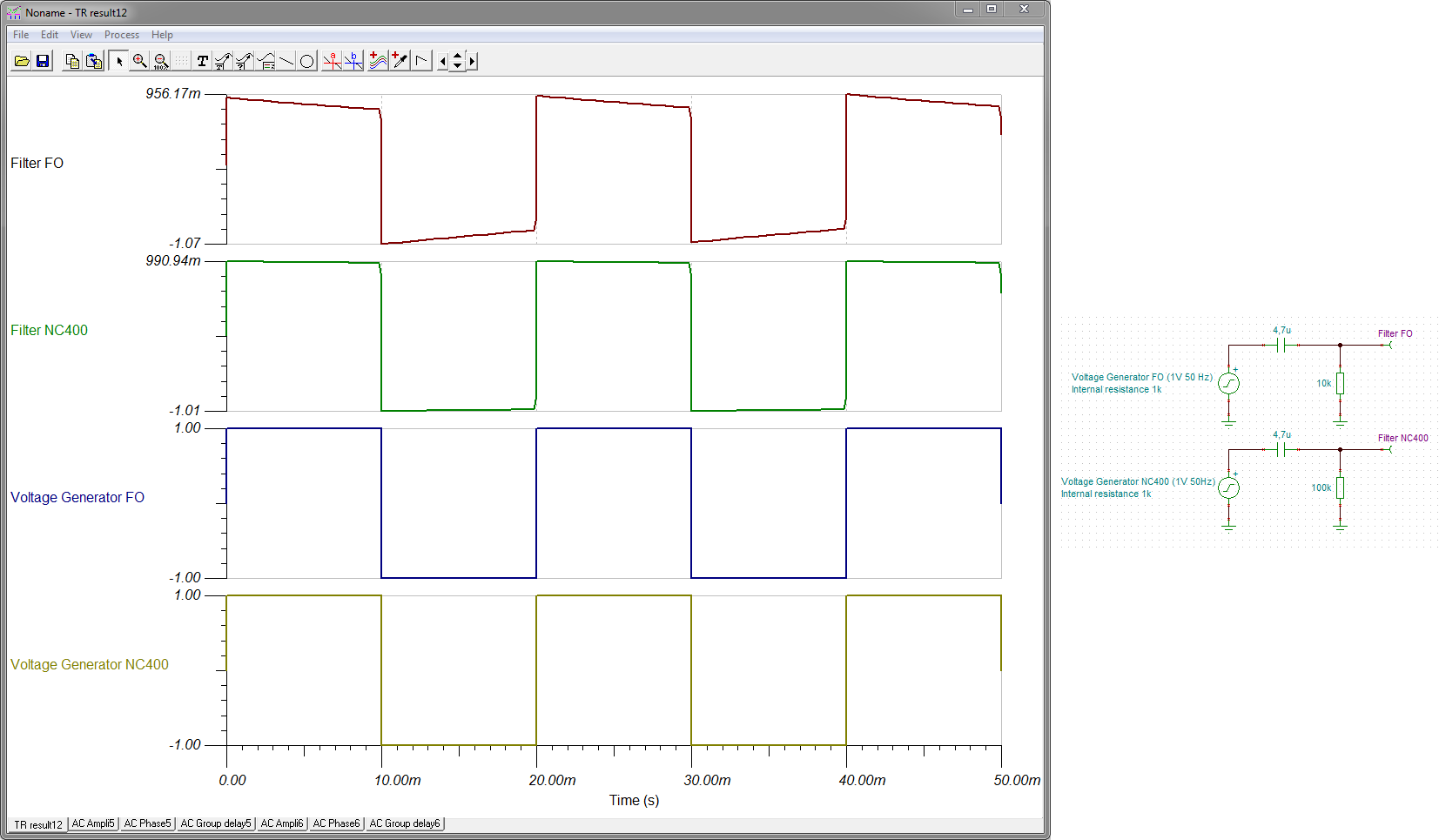

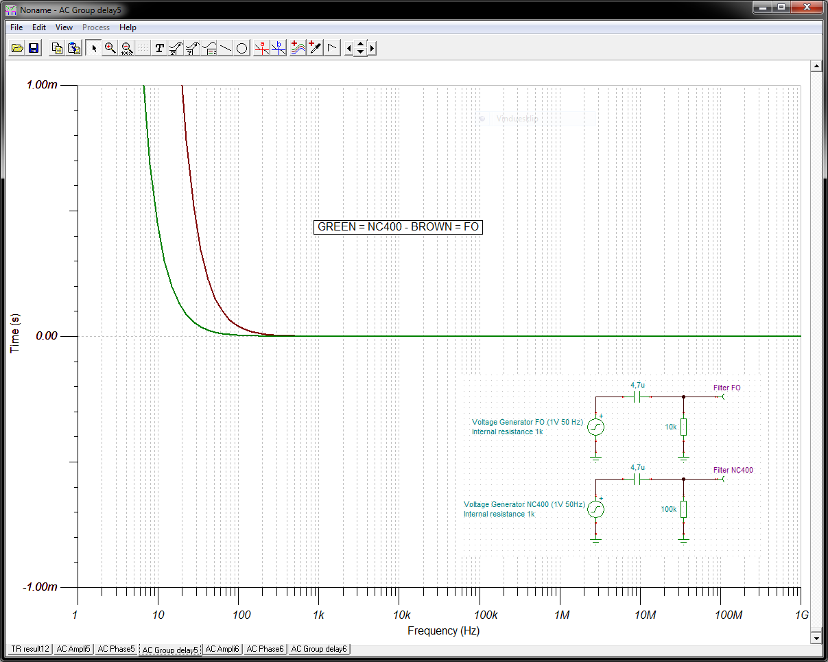

SIM
SIM roughly signal presented input at FO / NC400.
Signal generator output z set to 1K all plots for simulating preamp, and ac cap value just a guess.
Squarewaves (50Hz) and group delay speed at lows could be done equal for both amps by using ten times bigger cap when used with FO, for amplitude F3 will equal too but dB total level into FO heavier 10K load verse 100K load NC400 still be lesser, influenced by source having 1K z out.
