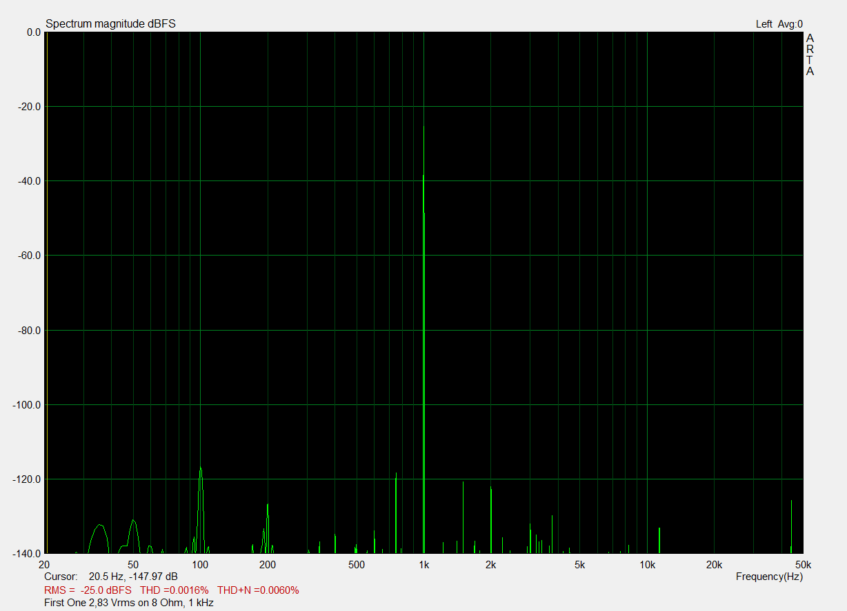

As promised yesterday here's the measurement result for 1 Wrms (2,83 Vrms)/8 Ohm at 1 kHz.
1. Input sine signal 0,11 Vrms, THD1k=4,8 ppm, best what I can get from the card's signal generator
2. Output signal 2,83 Vrms/8 Ohm, THD1k=16 ppm
As seen from plots, input signal artefacts generated by audio card faithfully transferred to the output plus some distortions added. With better input signal we could just get to single digit ppm. 😎
Post #1 technical specifications updated according to measuring results. 😉
