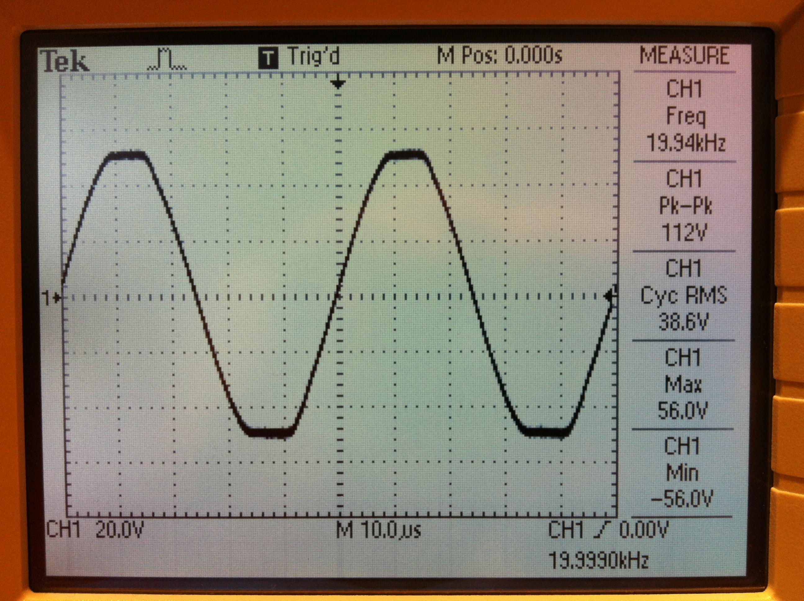

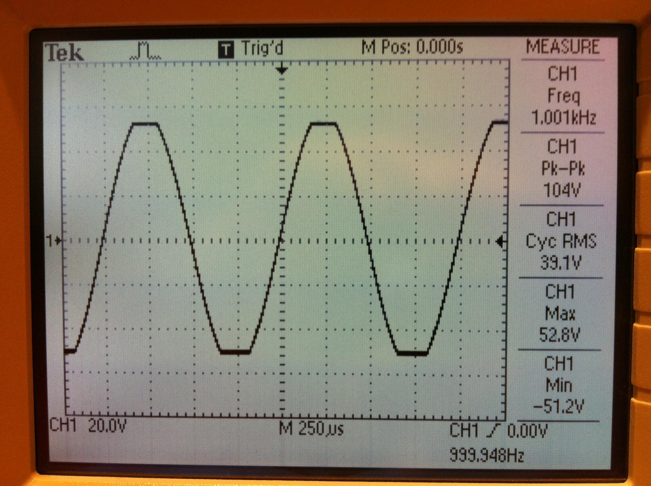

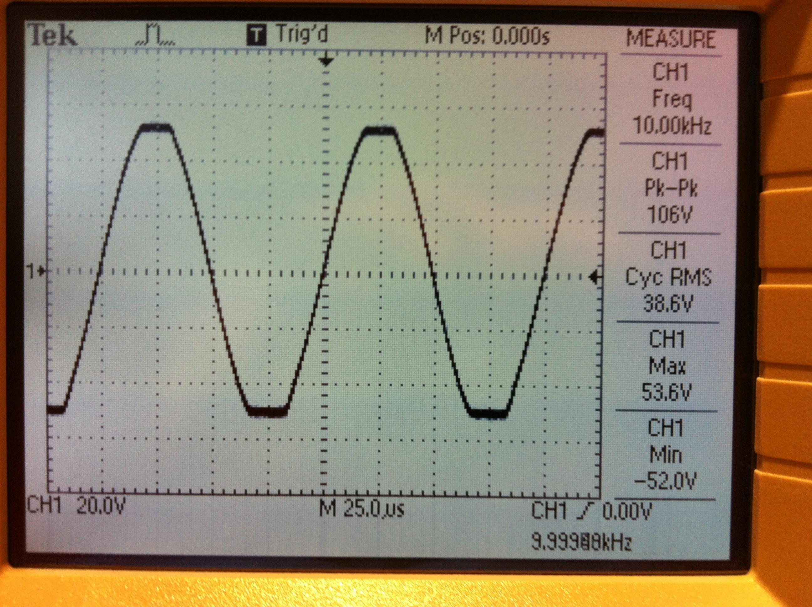

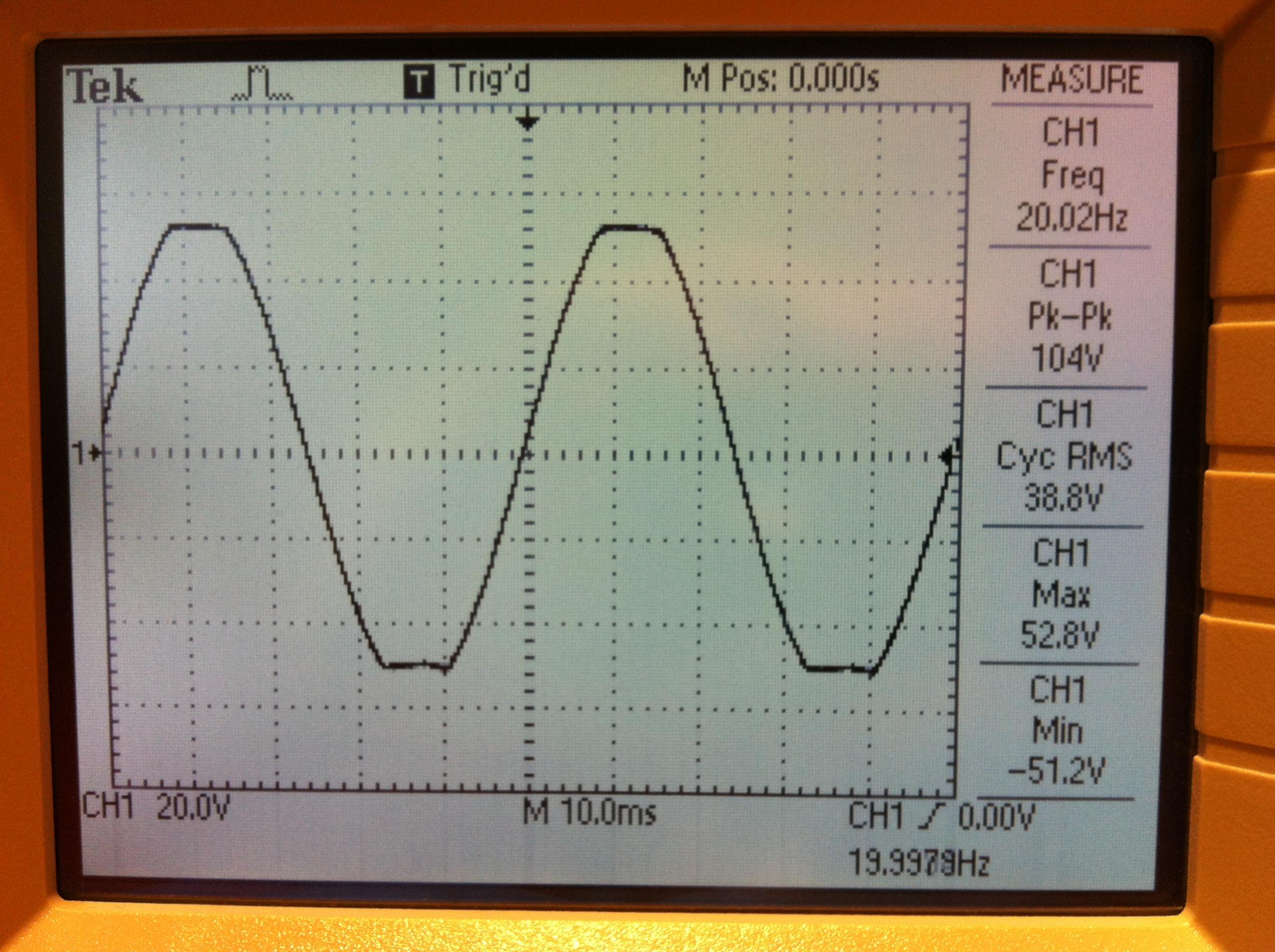

Clipping images of the First One. Supply voltage dropped to 58,5 V, clipp voltage 52 Vp.
1. 20 Hz
2. 1 kHz
3. 10 kHz
4. 20 kHz
