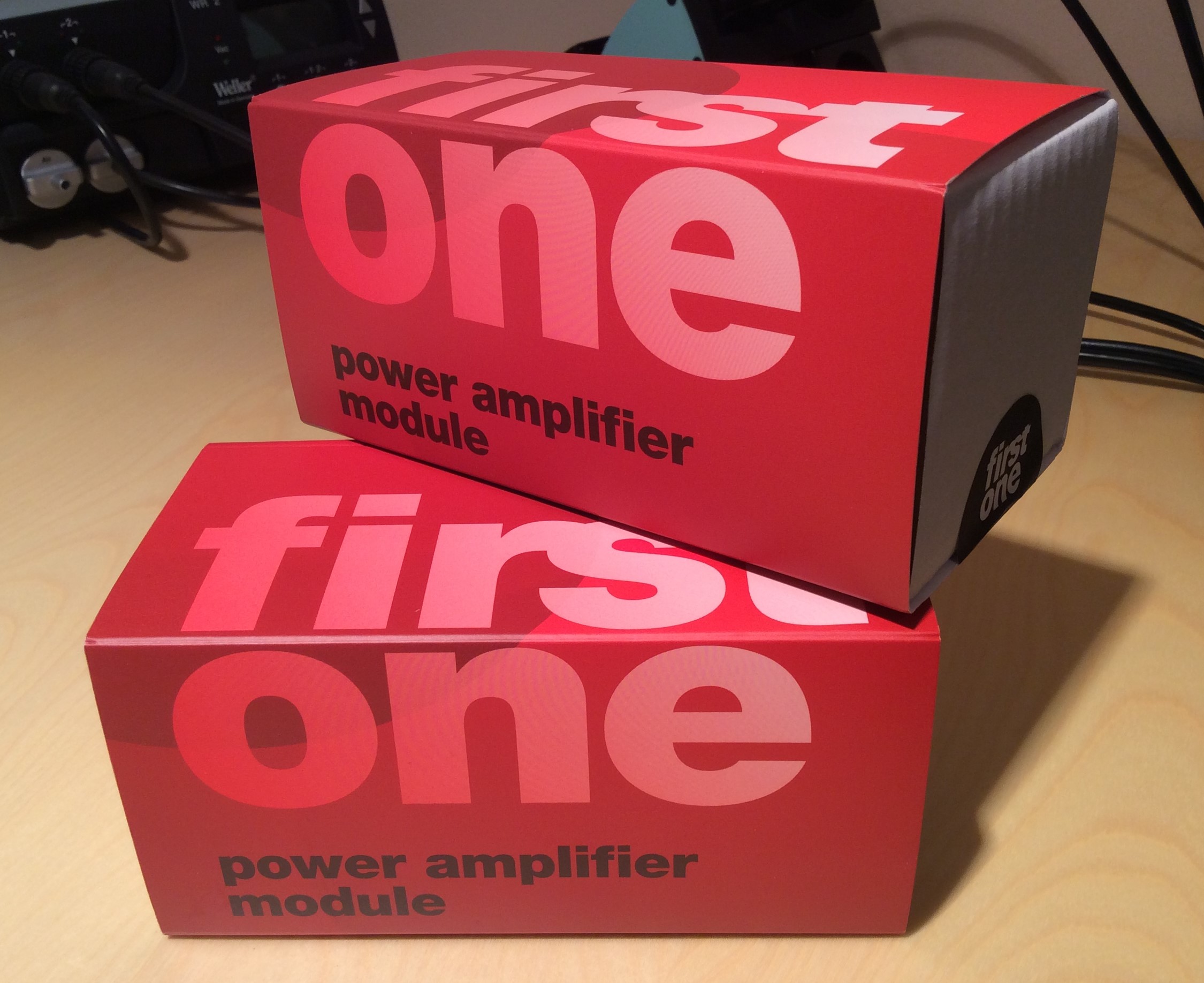

Hi guys
I would just like to say that I'm so sad that DPS-500 can not run on higher powers, because sound with this SMPS is just perfect.
Today I went to one friend whos owning Martin Logan EM-ESL, entry level ESL speakers, and I was so pleased with sound that I would really like to share this experience with all of you.
Finally soon you all will be able to share back your impressions as the packages from pic bellow will go to travel the world from now on.
Regards L.C.

Hi guys
Regards L.C.![]()
Uh! same my idea for my new amp. red cartoon as "F1" ahahah!
very nice package!
