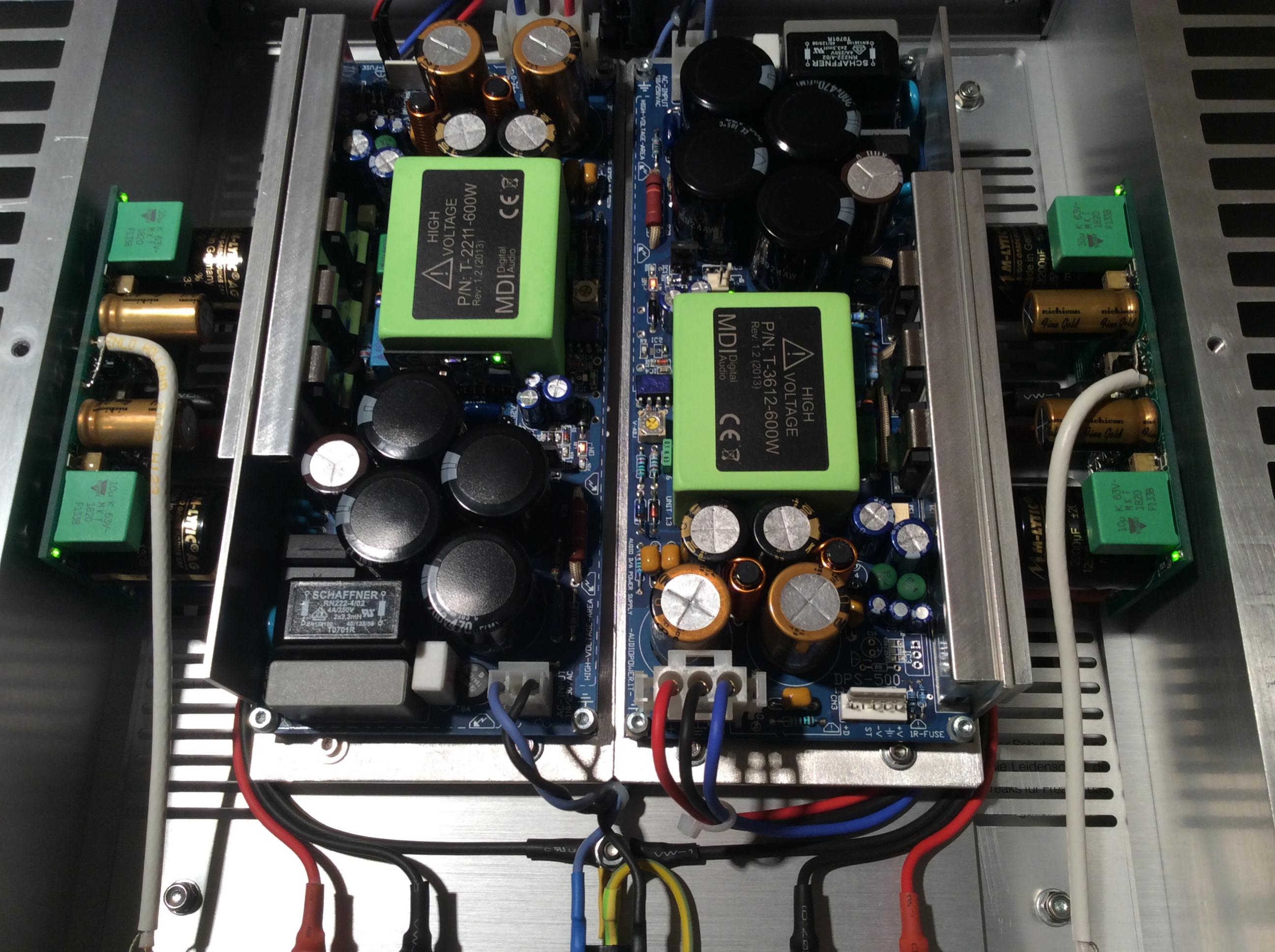

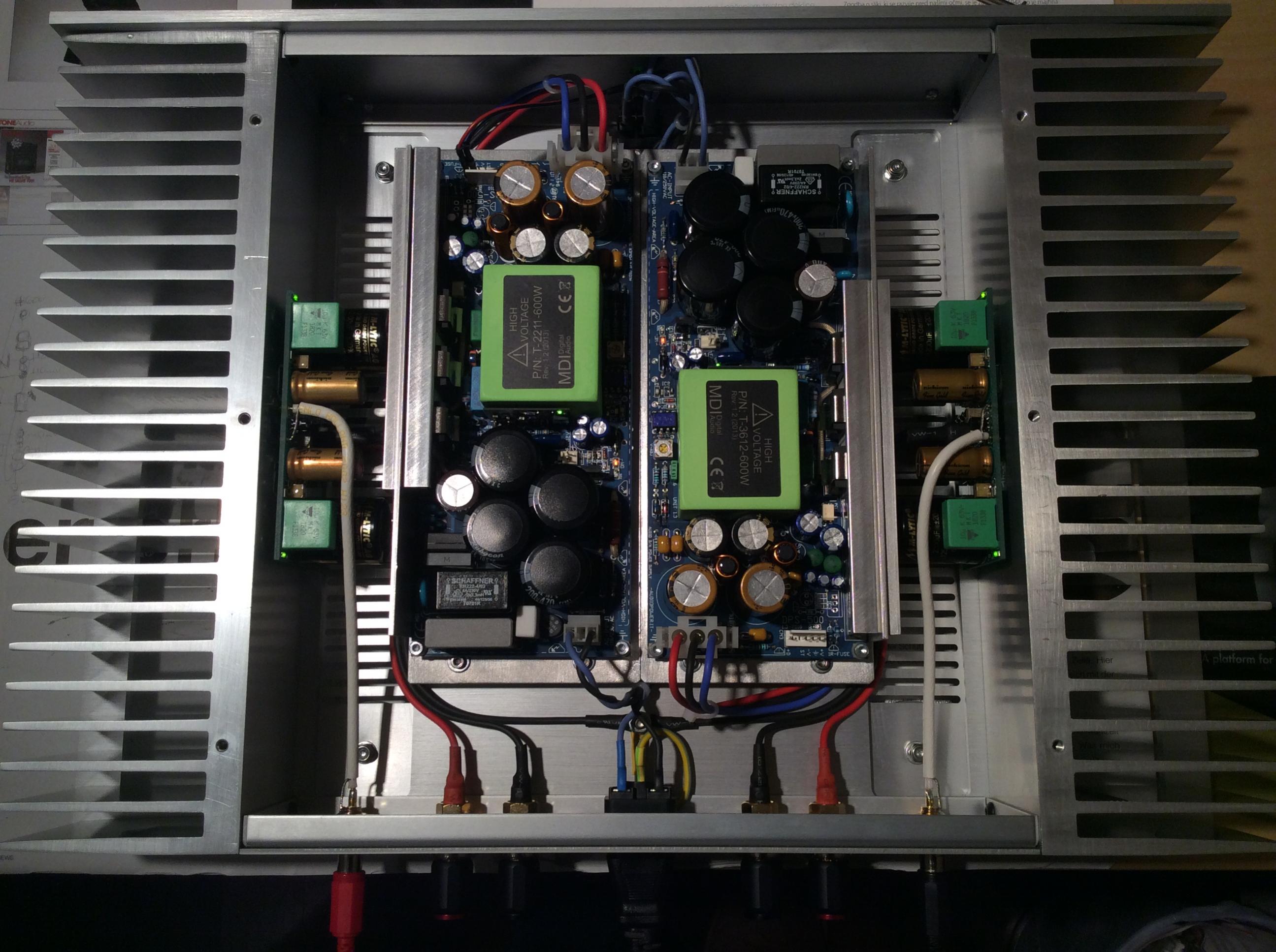

And this is how finished demo First One looks, running for a few hours on complet channel bias 280 mA.
Mosfets in SMPS are at 42°C, main transformers at 48°C and the main heatsinks at 43°C.
L ch output DC offset -0,6 mV and R ch DC offset -0,2 mV, of course without any DC servo.
Now to listening session.
