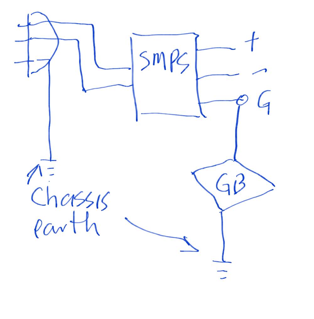

Hi Sami,
Could you post pictures of how the smps was connected with ground loop breaker?

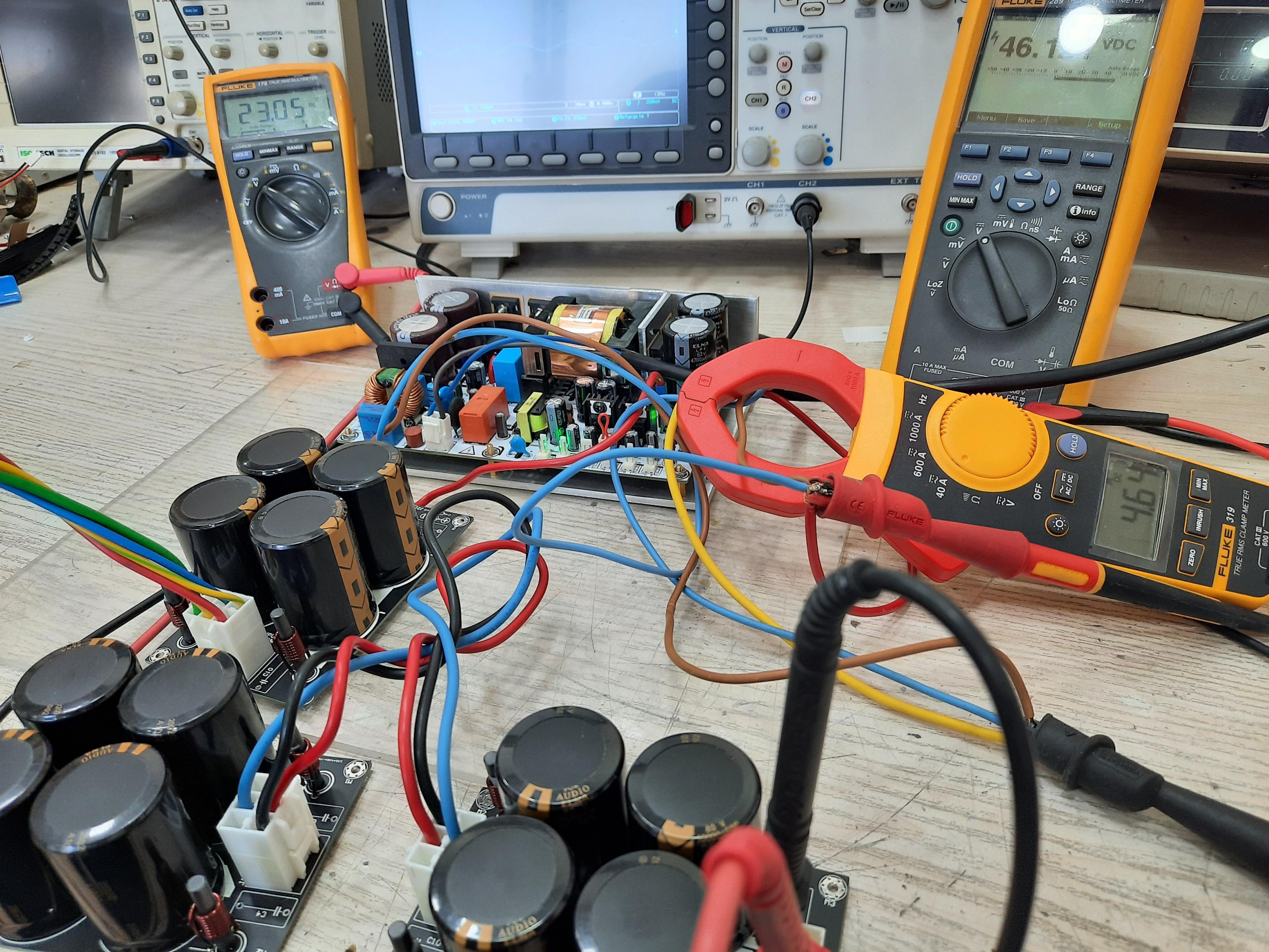

Re. Additional capacitance: would it be possible to have an RC filter after the smps and use much more capacitance in the C part (R being close to 0.1 Ohm)
I would be very interested for that set up after seeing also Soulution using this method together with Meanwell HRP-600 models and in some models they have close to 500.000 uF capacitance per rail.
Yes, you can use RC filter without issues, you can see that in the M2X setup.
I have fresh ELNA 10000uF audio capacitors, I will test the maximum number and will post the results here.
First test was with 35000uF extra per rail and no issues at all.
However, the SMPS will start up without 0.1R in series, 70000uF was directly connected at the output.

Hi Dominic,
Attached is how the ground loop breaker was connected, this is exaclty what my friend sent me weeks ago.
Sam
Do you require to use some stand-off to be nylon instead of metal? I know for stand-off holes make connection to chassis.
Do
If you are refering to one of my SMPS units, it will make diffrence only of you use one for the screw that connects the SMPS to the chassis, other stand-off are not connected to anything.

Hi Sami,
Just a quick question... you wrote this earlier
SMPS output voltage in idle @ 230VAC = +-25VDC
SMPS loaded 6A output voltage is 45VDC
SMPS loaded 16A output voltage is 41VDC
You say +/-25Vdc with 230Vac input but then just under your talking about 45V... did you mean 25Vdc under 6A and 21V under 16A?
Does the output noise increases a lot under say 7A compared to 2A?

Yes, +-21V @16A
Ripple will increase, noise will not increase much.
